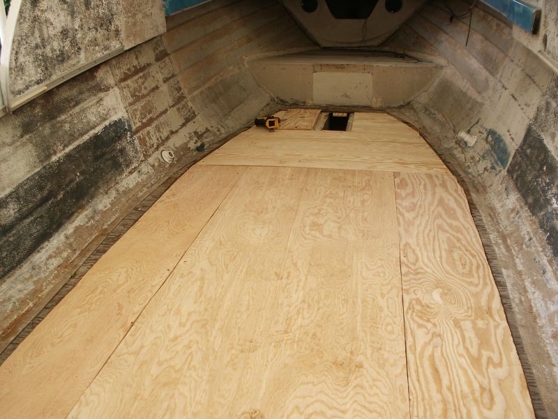

hi well i am also a beginner but i have tackled the floor . recently i have cut 1/4 inch plywood as a template then transfer that to the 3/8" marine grade that i will use perm. i gutted the floor removed the waterlogged foam. cleaned and repaired any thing below the floor. i have a block of foam to go back, not really for floatation but for sound deadening. i laid my floor out screwed it down and then marked alignments tabs so it will go back the same.
i am going to remove it, resin the bottom and all the edges then lay the foam and put the floor in one more time. then glass the floor . i had originally thought of linex bed liner but i have about 20 square feet of floor, white linex is 12.00 a square foot. my floor was going to cost me 2400.00 to install . forget that. i'll find something. i will have a host of people to guide you through the process , just don't get overwhelmed ..
