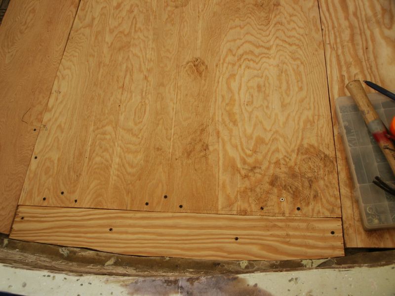

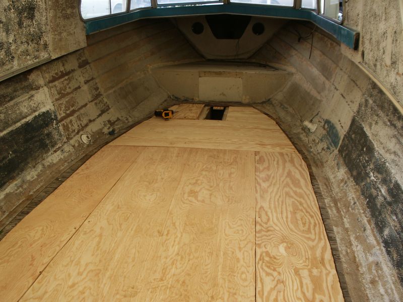

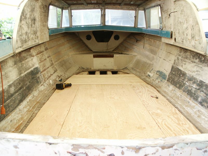

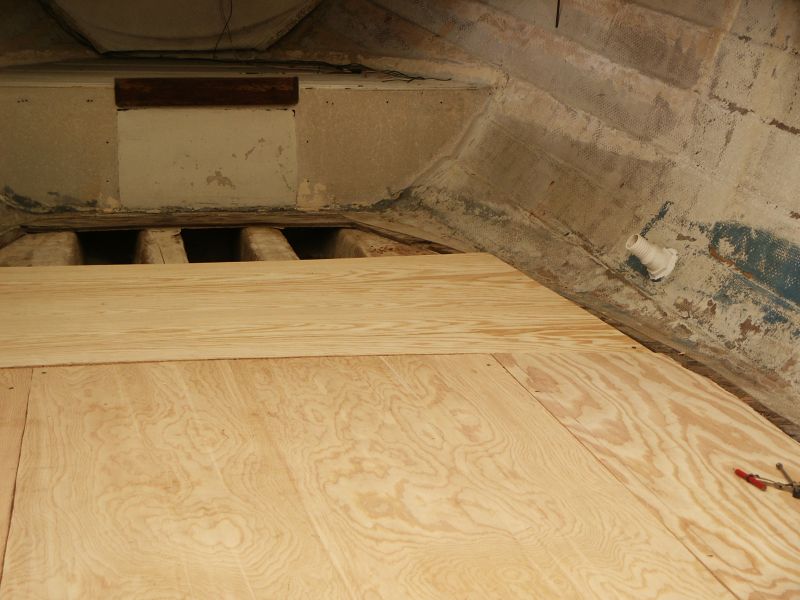

ok boys and girls through the rain i managed to get the floor cut in and trimmed out. it is 3/8" marine plywood and i took a compass and traced the edge out to get a better fit i had originally bought three pieces, and worked it out with two. i want to see if i can take the odd piece back and exchange it for two pieces of 3/4" for the cabin walls... saving me 50.00 .. 3/4" will be 72.00 each. i think it will do. i want to go under and in between the stringers with some of the 3/4" to get me some meat to screw various things too. i will glue the scabs under the floor and then coat the bottom with resin ,it came with a sheet of mat on the bottom but i am hoping to seal it up good so i can keep it dry. pretty good for a beginner.

Look'in good to me. Funny how things are before you did them. The whole prospective changes once you see how you do it. One step at a time and don't get in a big hurry, but on the other hand don't loose interest. When it's done you'll have the satisfaction of doing it yourself.

Looking good Billy, nice work. Pretty tough making any progress with weather like we've been having lately! Looks like the "rain every day" stuff is going to ease up next week, I know you've got to be ready for a break from that. ;)

SWEET!!! It is nice to see someone doing it by the numbers. cap-n billybob I am anxious to see your progress. I am also anxious to hear your review of your transom work, as I have thought of doing the same on my 58 Winner

Looking great so far, keep up the good work.
