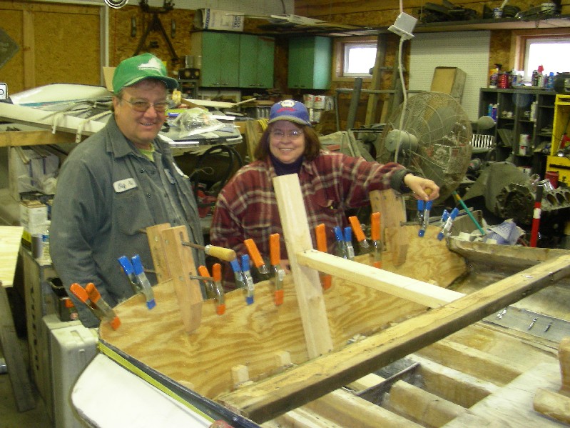

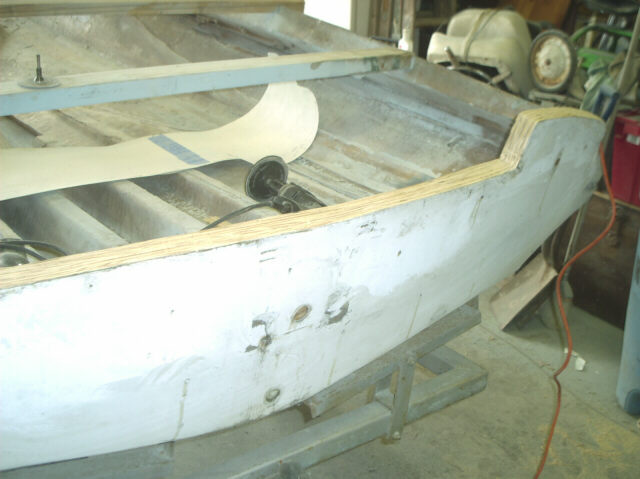

Looking Good Havock! This area is where everyone has a difference of opinion. I used a BCX grade of plywood as I was making a curved transom. BCX or ACX would be recommended if Marine Plywood is not available. I used wood screws to assist with the laminating. some cheap .99 cent clamps. Get some fiberglass mat to sandwhich between the old skin and each piece of plywood you use then by some 4 or 6 oz cloth or better yet bi-axle cloth. for you new inner skin. Here are a couple of pic's of my latest g3 transom rebuild. Use the gunwale for addition bracing if needed as in the top pic.
space the wood screws on the outer skin to draw the plywood to. USE screws that go all the way thru the plywood. when you glass in the second piece of plywood the glue will squeeze out of the holes from the first glassing and seal the outer skin. If you use the same hole for both pieces of wood the resin from the new inner Hull/skin will drain thru the holes and seal the outer skin of the transom. Have fun and keep us posted.
