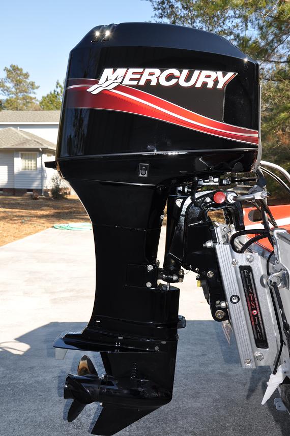

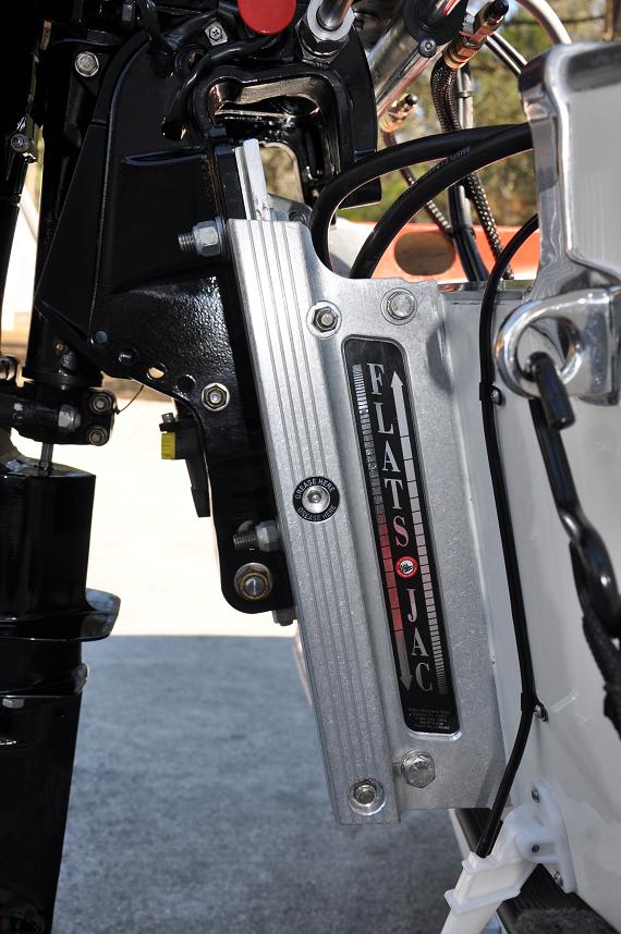

Great question Sir! Let me see if I can give you some input on what I did on my 1960 Glasspar G-3.
When I inherited our family owned 1960 Glasspar G-3 from my Dad I knew I wanted a newer outboard motor on our boat. Being that all the newer outboards have 20" lower units I had two choices; either
build up the transom or install a jackplate. I chose the later, install a jackplate. I like the natural lines of the G-3 and did not want to build up my transom.
In doing this, I talked with ALOT of G-3 owners and was basically told NOT to do this. You would not believe some of the ERRONEOUS theories I heard. During my research I talked to a G-3 owner in Florida who had hydraulic jackplates on not ONE,....but TWO of his G-3's with excellent results.
So,...I purchased and installed a "Bob's Machine" Hydraulic Jackplate and mounted a 2009 Mercury 50 H.P. Outboard on that jackplate with excellent results. The Mercury also has factory trim and tilt and the jackplate just adds more "adjustability" for shallow water, speed etc. I especially like it when coming into shallow water that I can hit the button on my dash and just raise the motor up but keep going until it gets to shallow.
Also, when running wide open throttle you can raise the engine to attain more forward speed. Personally,..I don't really make that
many "adjustments" as I ride along in the boat. After initial experimenting I now know where I can achieve the best ride and speed.
There were some G-3 Owners that told me the engine would have to be raised about FIVE (5) inches to get to the majic number to where the lower skeg was "even" or a little above the bottom of the G-3. They said that "lever effect" (motor high on the transom) would eventually damage my transom.
That theory was DEAD WRONG! Actually, the jackplate is only about 1 3/4" up for the motor to be "even" with the bottom of our G-3.
The jackplate has been on our G-3 for almost FOUR YEARS now with no problems whatsoever and I feel it is one of the best things I did to the boat.
Hope this has helped explain it some for you Chris!
