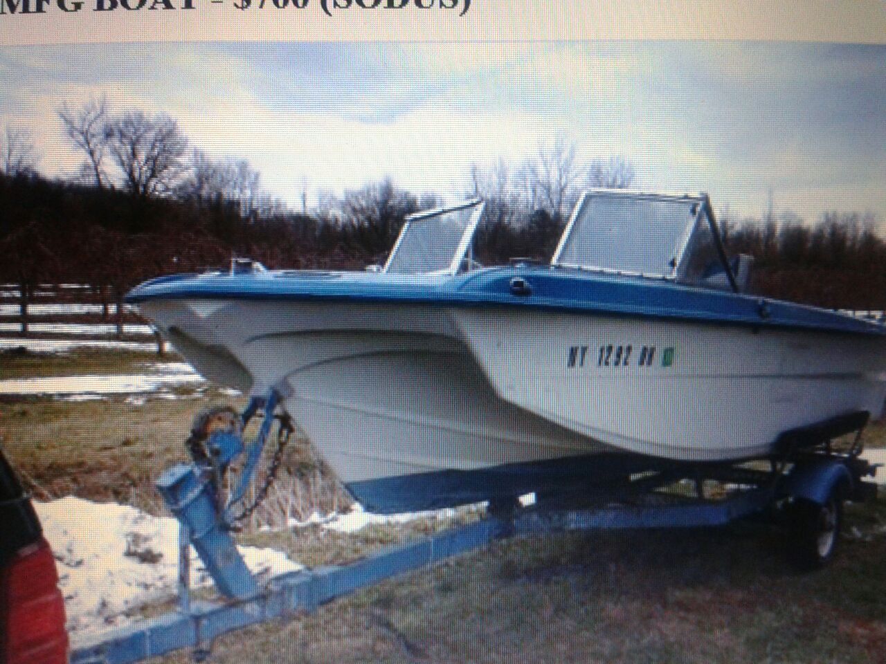

The sharp entry of the keel suggests MFG boats for the manufacturer to me.
