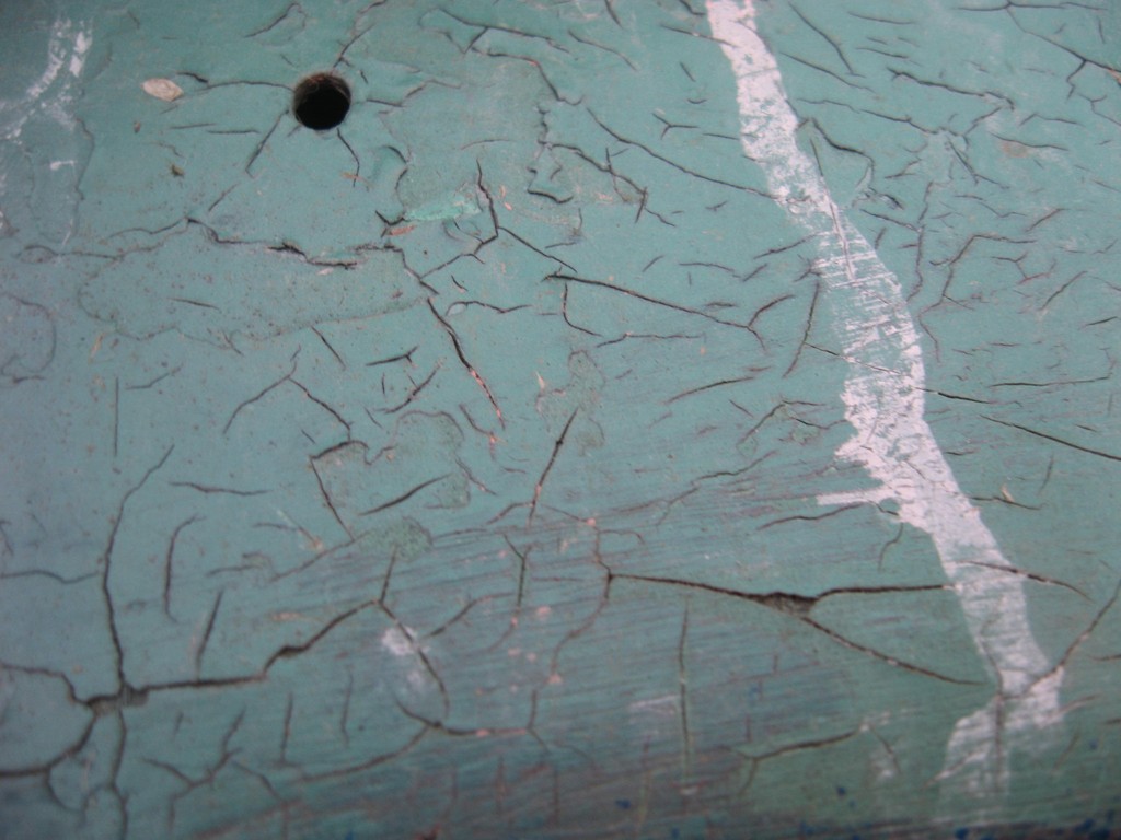

Anyone got some input reguarding the paint?
I was attempting to shine up the original blue , but there are so many cracks the polish gets stuck in between.
I was cosidering either
A: pour some sort of clear resin on the boat.
B: repainting the boat and then using some sort of resin for the shine.

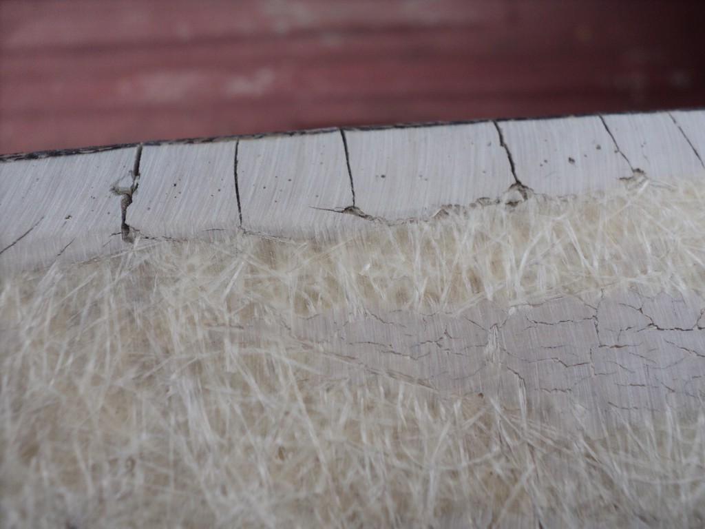

Do you have some close-up's? That may help. Mine was totally cracked to the fiberglass mat and I removed all the gel. It is a long hard process because mine was very thick. This was on an edge.

Hope you can solve the finish issues, but there again just putting clear over the cracks is probably not going to do the job. That will probably just amplify the problem. Though it is certainly worth a small test spot to see how it comes out.
It is similar to your pictures in some areas. I honestly don't mind the cracks at all (actually I kinda like them). The basic color still looks fine and isn't faded anywhere , I just want it to be shiny , So I'm thinking a clear resin of some kind.

i would recomend sanding the old gelcoat or paint with 80 grit sandpaper and useing an thick epoxy primer on it use body filler where u need to then sand with fine sandpaper and repaint.would look and last alot longer.
