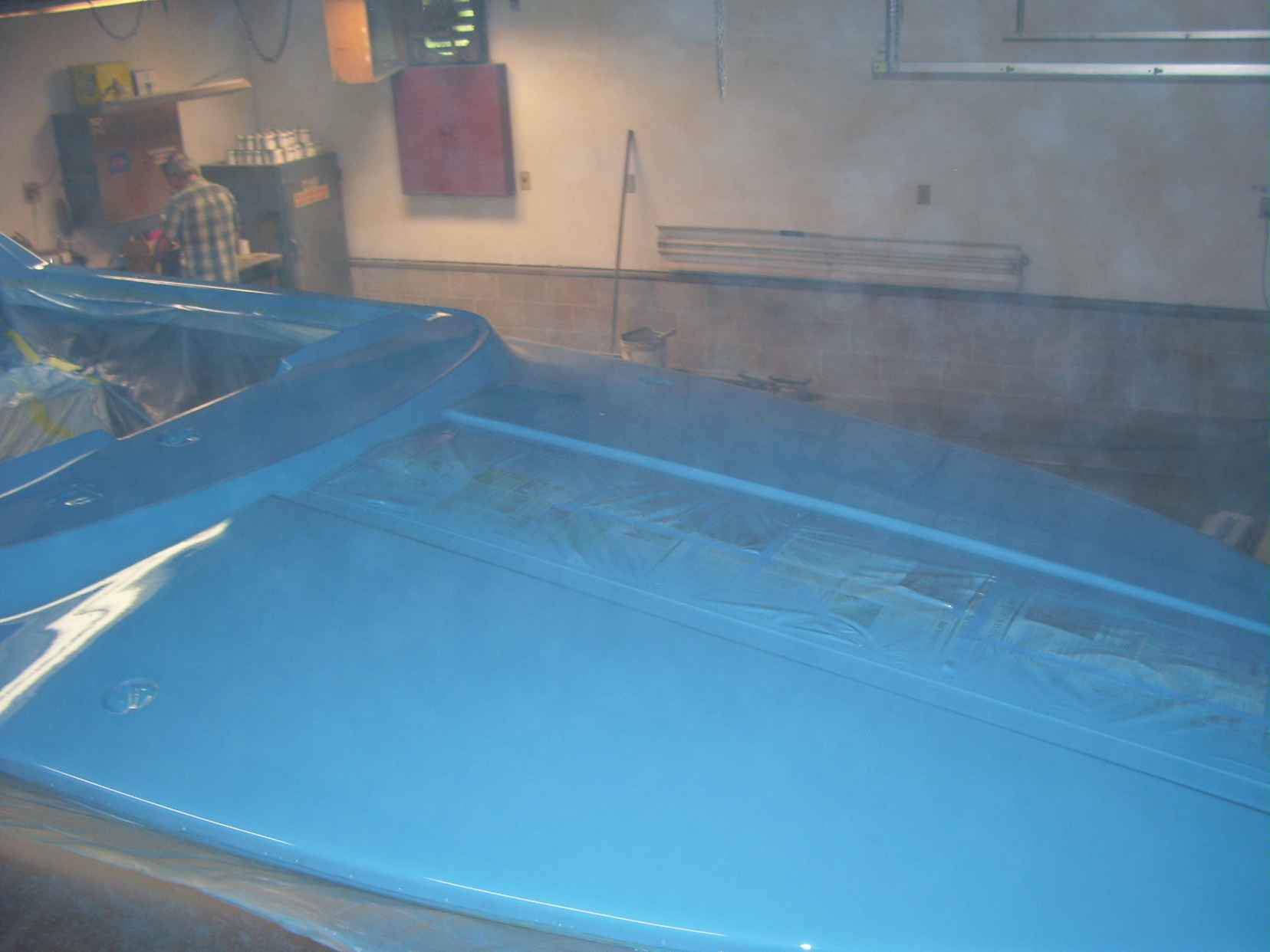

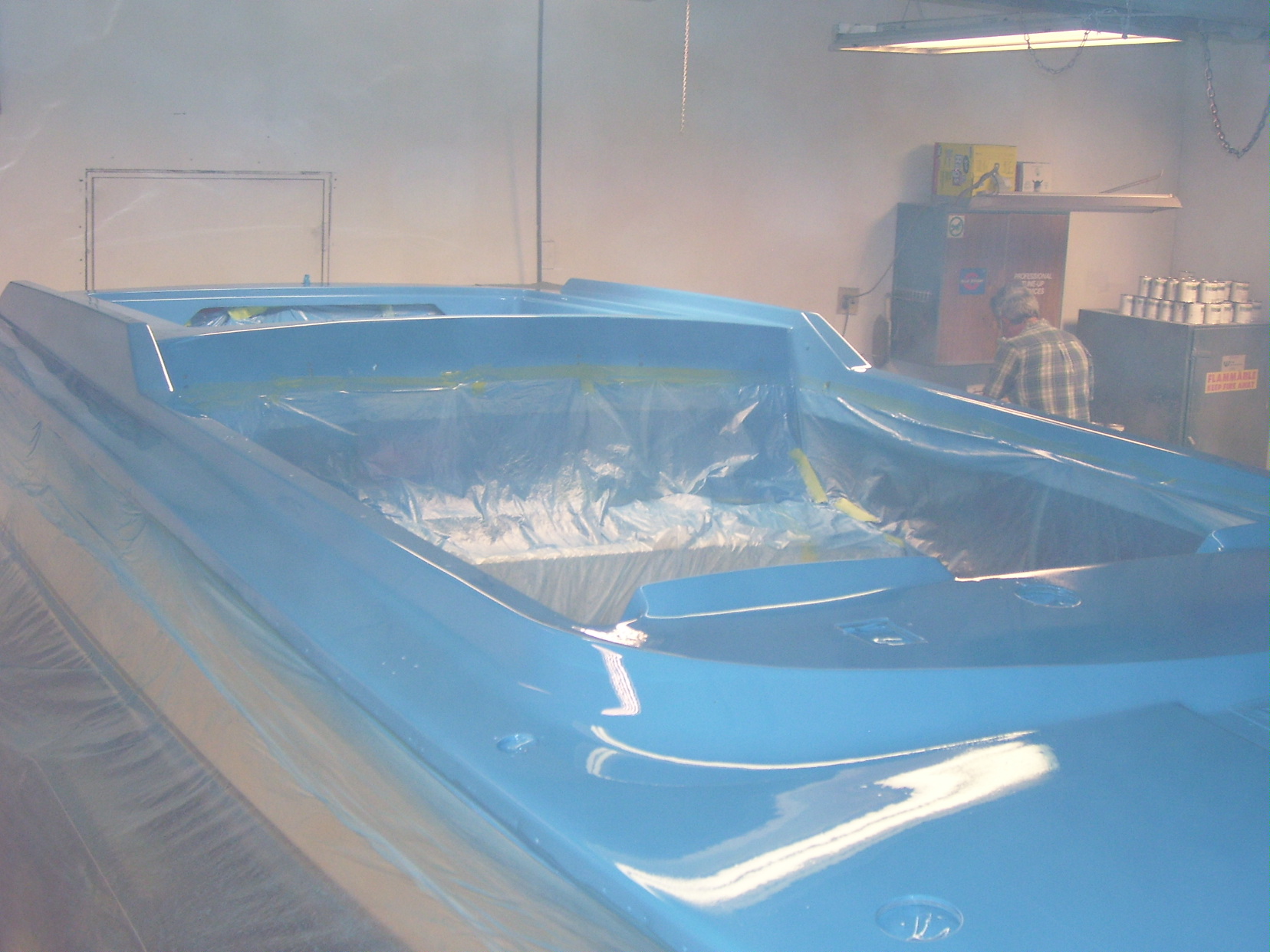

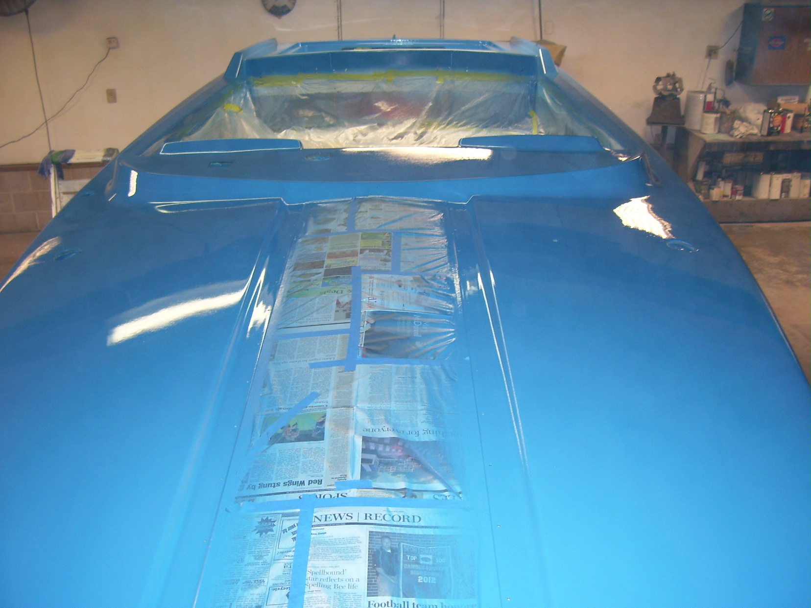

Put the Imron on late this afternoon and finished just a little after 6PM EST. Shot 4 coats so have plenty on for wet sanding, should be able to start that Thursday. Pics attached.

No Ron, It's 1970 AMC AMX " Big Bad Blue". No metalic, just Blue, blue, blue!! its going to take some time to dry, was shot a 6PM EST last night and at 6AM this morning it was still tackie, we put a ton of paint on so have plenty of build for wet sanding and buffing, have a couple of good runs but am sure they will wet sand out, just takes time, what the heck, I'm retired.
