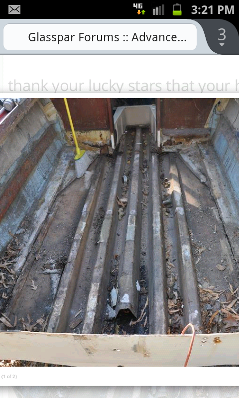

Here is the floor off a glasspar seafair sedan, don't know what year but those look like fiberglass stringers

That is the "Miss Tamara" a 1967 sedan currently being worked on by the ECGOA gang. The pic is from our Oct work party. Jon if I can locate them I have the wood Stringer measurements which are also posted on the site Skip mentioned. They are else where on the site and not in the general forum.

As my good friend Al already pointed out, that picture you posted of that Seafair Sedan is our ECGOA "Project Seafair" which was donated to us my a Mr. Ferd Johns. That Seafair has FIBERGLASS STRINGERS and as Skip pointed out, those boats are ALOT easier to refurbish because the stringers don't have to be torn out. But, with that being said, we still pulled out the bulkheads and tore up the cabin floor to put down new plywood throughout.
You didn't mention the condition of your transom, but I would highly recommend thoroughly checking that to make sure the wood underneath the fiberglass is not rotted. If so, you will need to chip out that wood and also replace it with new plywood. We have detailed this in our thread titled: "Project Seafair" over on the

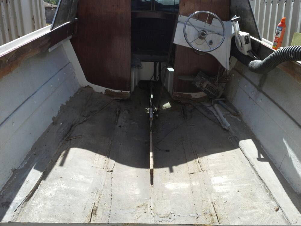

here is where I'm at after today

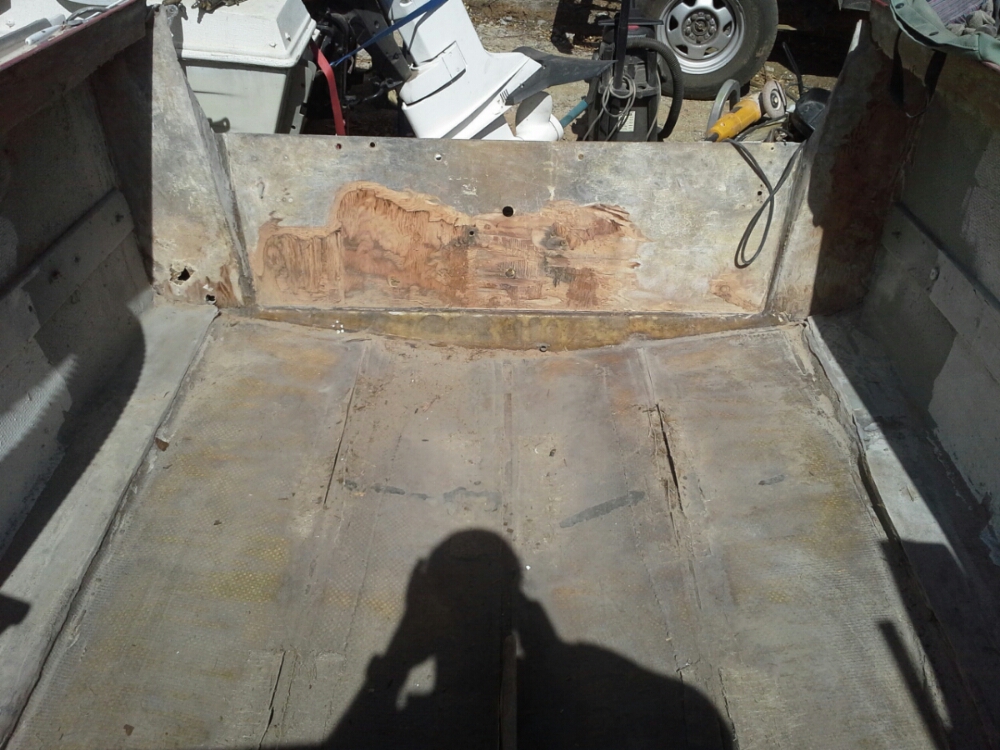

Re:Glasspar Seafair Stringer question 13 years 3 months ago #78206
and a transom pic. that wood left on it is only a 16th inch thick. I need to sand it off

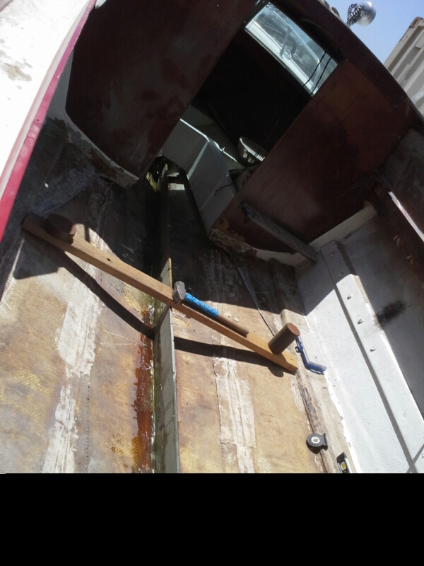

I thought the stringers would be in today but I had another setback. She's playing the ol' 2 steps forward one step back game. As rotten as my main middle stronger was, the wood at the base was in great shape I had to dig all of that wood out of a 3/4" deep channel made by the resin the factory used to glass it in. My lack of woodworking tools didn't help ether. I did get the first part of the middle stringer set in place and washed all the glass dust out so first thing tomorrow morning I will glass it in. I'm also thinking about replacing the bulkhead cabin walls with a donor boats 1/8" thick hull sides made of fiberglass. Although not original, it has a nice layered wooden look to it and I think (I hope) it will hold up to saltwater better then the wooden panels, we shall see...I do want to keep it as original as possible. My splashwell is sloped, not bathtub style. I will take a pic tomorrow. So with the wooden stringers and the sloped splashwell and original teal trim color what year do you think it is? I could not find any identifying plates or numbers anywhere. attached is a picture of the stringer sitting in place

first part of the main stringer, those measurements were on the spot!

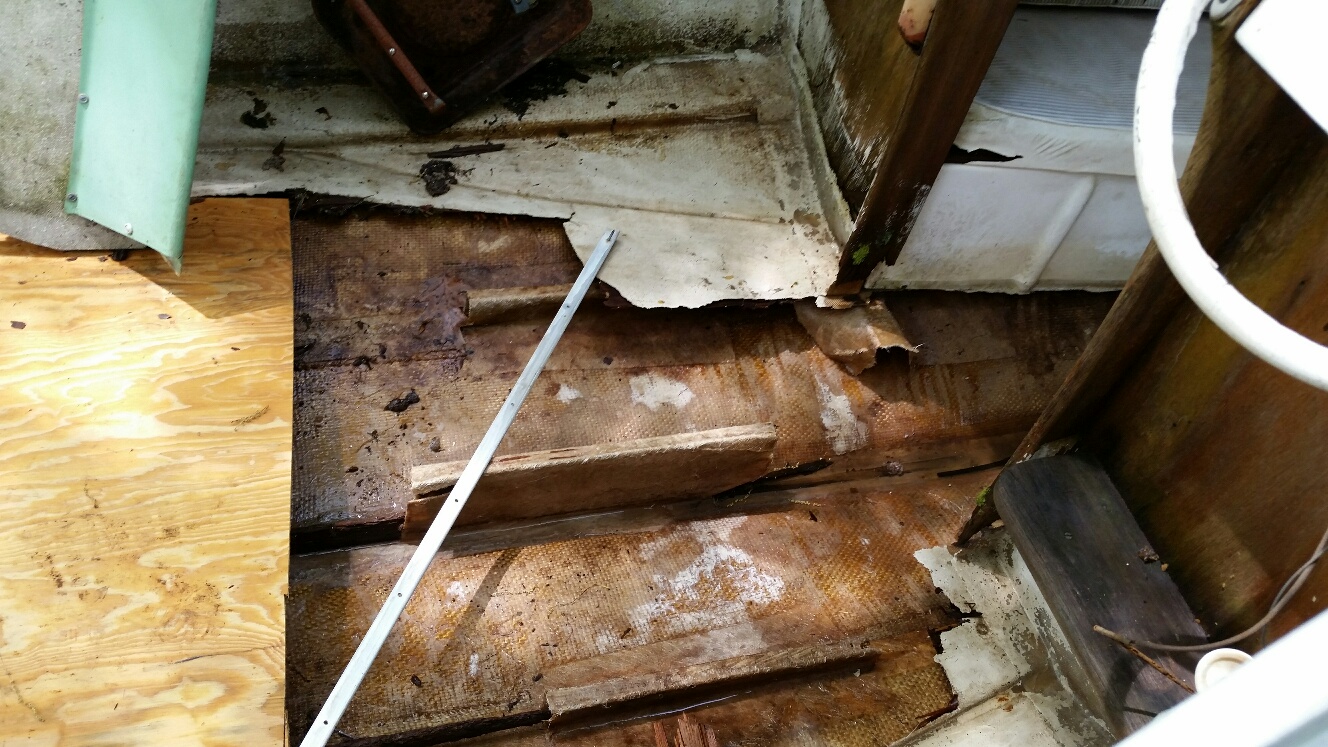

Re:Glasspar Seafair Stringer question 11 years 7 months ago #105236
Here's a pic.
