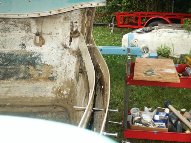

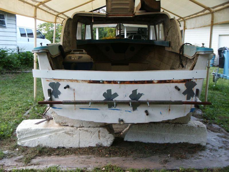

ok you all , i bought this several years ago, found this site and started to rebuild it. i did alot of research and decided to go with the seascast, the guy ( Bruce ) has been very helpful. i measured and bought the mix . i have gotten real serious about fixing the transom and have spent alot of time and money, but here i am ready to pour. my big problem now is finding someone i can get to give em about an hour and a half for two days straight in the morning . Cool weather is a must. pour the cut out and then come back and pour the wings. a helping hand is needed for the mixing when you mix the catalyst in the bucket. here a the two pictures i am allowed , i have more , of the transom ready for pour. thanks to all you here who have helped me get this far.

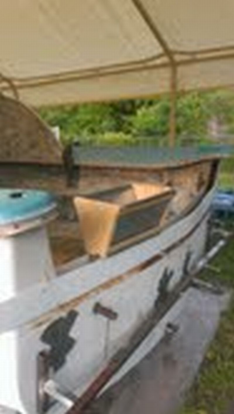

i built a through like they say use, i am going to get a milk jug to pour my ears or wings with i drill holes in the top and made sure my hole would accept a milk jug lip. i took these pictures before the through .. i grooved two ends and then set in to pieces of galvanized sheet metal. and then duc taped the bottom fits good.
i was instructed i could pour the next day i didn't know i could wait a few days for the second pour. my help is not available two days straight. i detail every step so i am going to send it back to seacast for their testimonials
