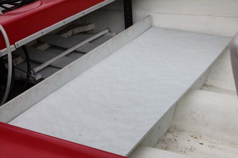

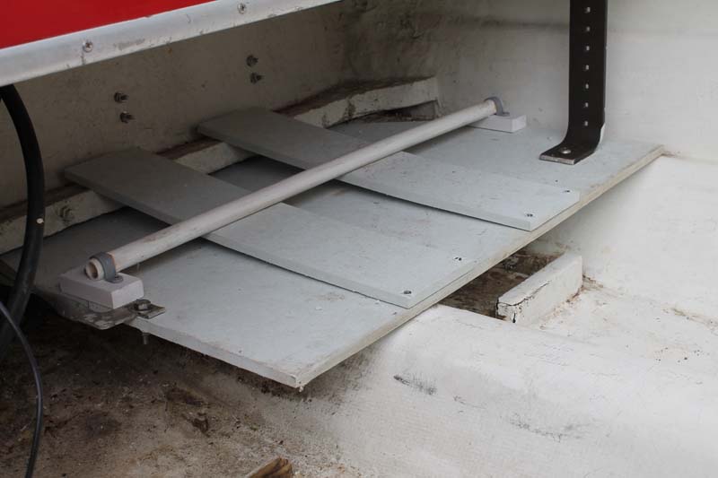

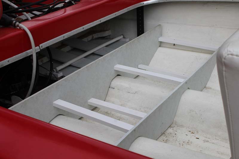

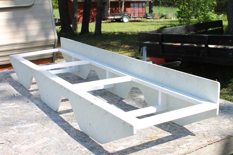

Built a new rear seat base and gas tank platform this weekend. Was all wood, now all plastic.

Thanks Bob! Not much of a change in looks from the old plywood stuff, but ya can't have just painted plywood, doesn't work. Glassed stuff was okay (gas tank platform), but got replaced anyways. Plastic (like fiberglass) is less maintenance, better looking over time than the wood.
More to come tomorrow. Got some interior glass work to do, shouldn't take too long (yeah, right!).
Frank

Lookin' good Frank! I think you'll be happy with the results, fix once and forget. I've been using it for over 15 years now, its a great material to work with. I just cut some pieces of 3/4" to replace the rotted plywood in some helm seats for the Whaler. Will take in this week to have new skins made.

You got it! This stuff worked out great, much easier to use, and very solid once I figured out deck screws are the key to fastening happiness. I stiffened the base today, counter sunk all my SS screws, and finished up in general. Back in the boat!
