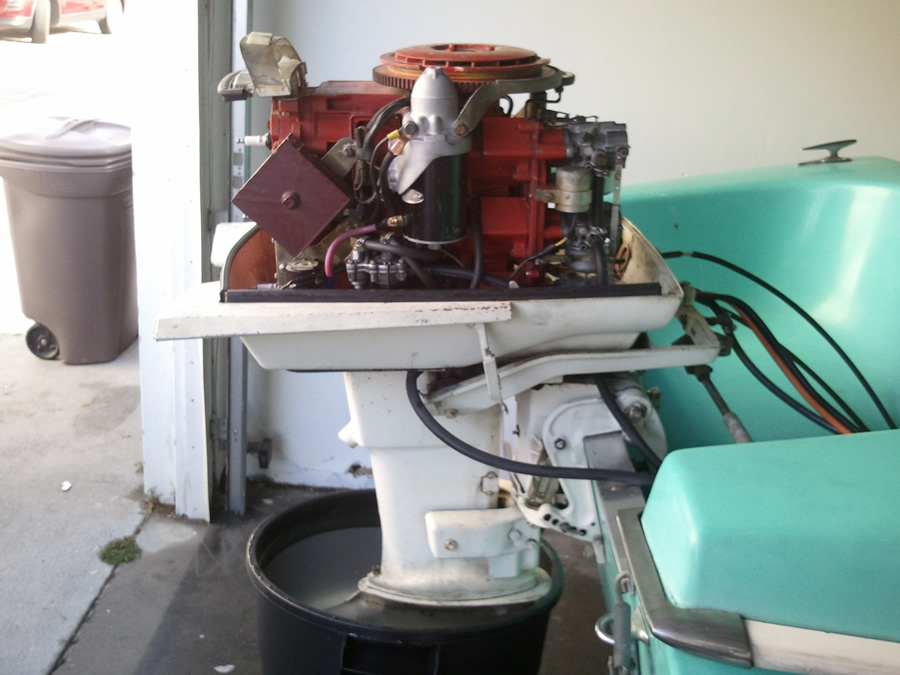

My 1960 Flying Scott 60 has roared to life!
I’ve rebuilt the fuel pump (new diaphragm & gaskets). New fuel lines, refurbed the 3 carbs (cleaned, floats ajusted, fixed a jammed metering rod) new battery, rebuilt starter along with an extra ground strap to the starter solenoid. New Autolite 303 plugs, and tomorrow I’m going to replace the plug wires. (Yes see the broken bolt on the side where the wire loom hangs, I've got that to drill out and tap tomorrow also.)
Right now the motor will fire occasionally but only on full throttle and then it wont start again for a while just turns over but wont fire (so much for a bad starter... its turning!)
-What points & condenser do I need?
-Do you think I should swap the coil? (My thought is that it either would work or not work, and since it does fire it must be working.
-Is the 303 the “best/correct” spark plug for this motor?
Any insights on what I might need to look at? Thanks! –Stephen

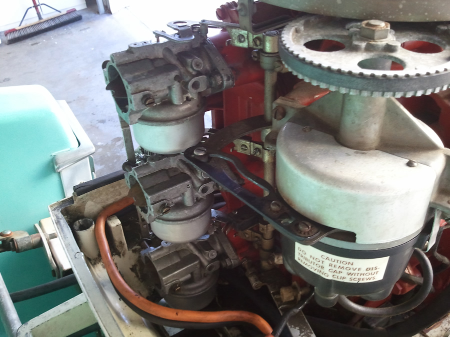

Wow, deja vu. Your right where I'm at. My starter's bendix is hanging up. So, if I try to start it, it might cause a lot of damage. However, I took the points and condensor to my local auto parts store and had them match it up. They actually had one. The points are for some car, he didn't say which. It's a Bosch. 303 plug sounds good for that motor. I use a 276. However, in my case, the bendix starter that I need has marine applications.
If your motor is only firing on full throttle, your carb idle circuit might be clogged. I'm not familiar with those style of carbs. Did you let the carbs soak real good?

Yes I soaked the carbs. These are an interesting derivative (3008S - can't find the PN any where on the internet) of the ubiquitous Carter N carb (lawn mowers, snow mobiles, etc.) It's a fixed jet design and uses a metering rod that moves vertically with the rotation of a stepped cam. There is an idle adjustment screw. but there's not much to it.
It looks like I might be fouling plugs so I need to make sure I'm getting enough spark.

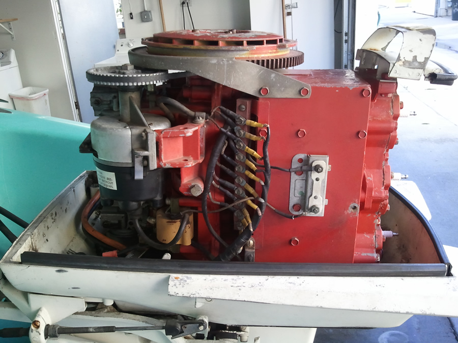

When I was replacing the plug wires I snapped a bolt head on the exhaust manifold. After drilling the bolt and tapping I had a gasket leak. So I put some clear silicon in the bolt hole and siliconed the outside of the gasket. Which stopped the leak. Now I'm wondering now if I plugged a cooling inlet with excess silicon?
I want to trace the water flow to make sure nothing is blocked...
Is this the location where the tell tale should be coming out? I fished around with a coat hanger but didn't feel any hole going into the motor.
1960 Dorsett Belmont w/ 60 HP Flying Scott aka \"Whisky Tango\" dorsettbelmont.blogspot.com/ Read my Jerky Blog at JerkyAficionado.com
Re:Help Tuning my Flying Scott 60 12 years 3 weeks ago #78232
you can see the other side of that hole in the spk plug wire pic, under the head

are those yellow s/plug wires solid core? they must be solid copper. not the automotive style
did you ck the large impeller at the brass? I have several that have been loose, they looked fine but the brass would spin and the rubber wouldnt.
Nope... auto store do it yourself... I'll change them stat! Thanks for the heads-up. Also I will double check the center of the impeller before reassembly. I have one of each on the way so I'll likely replace both.
Edit: doing some reading I found the reason I need solid core plug wires... Most wire sets you will purchase today are the newer HEI (High Energy Ignition) type. These wires are designed for use on ignition systems with outputs of 35,000 to 45,000 volts. Your original classic point-type ignition system operates in the 20,000 volt range. Putting modern HEI wires on your 20,000 volt classic ignition system causes low voltage to the spark plugs, resulting in hard starting, poor gas mileage, decreased performance, rough running, fouled plugs, and other symptoms that seem carburetor-related, when, in fact, they are being caused by incorrect plug wires.
