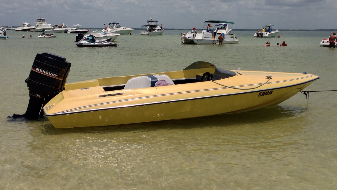

I'm in the same boat, LOL I couldn't resist the pun :-), with my "new to me" and also my first boat ever.... A 1981 Glastron C-Metric 500 with the "Tower of Power" Mercury 115 (1984 vintage) and the steering is VERY stiff at speed and sometimes it feels like its actually fighting against me. Recently I have learned what torque steer is and the steering cables probably being original may add to the stiff/tight steering that gets worse the faster I go. I learned about the Teleflex NFB 4.2 steering cables and wonder if they would make my outing more enjoyable and easier along with safer. The cables in it now are probably dried as far as lubricant and maybe this is making things worse too? Anybody have anything on old standard versus new NFB with the 4.2 lock to lock?
Thanks
