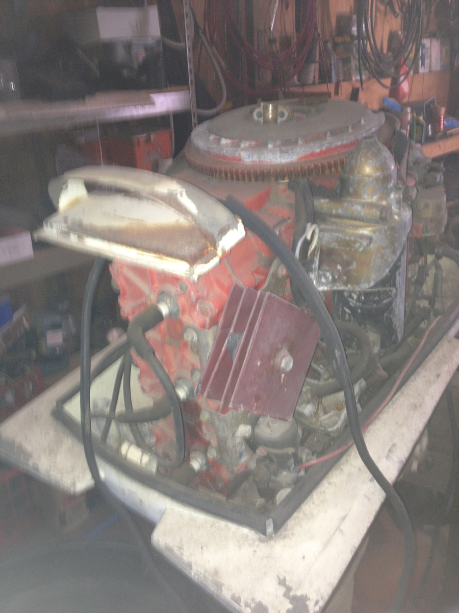

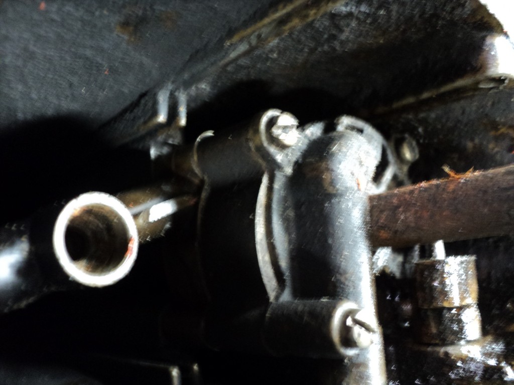

I'm not sure about yours but the smaller Scot's have to have the power head pulled off to access the impellers. There are two on mine separated by a plate. One for the bail-o-matic and the other for the power head cooling. You can just replace the cooling one. I'd feel better if they were below the water line. No matter what it means they are started dry. This is what mine looked like. Alas only a 7 1/2 hp.1957
McCulloch bought Scott Atwater out. Of course they produced Firestone, Wizard, Champion and a few others I believe.

the pump is in the lower unit,but probly looks like the one pictured above. if you can take some pics of your motor from the engine area down i should be able to walk you through it, you might have a lil door on the rt side of the leg just below the transom clamp, if so remove the 2 lil screws and you will see a brass conecter to your gear shift, remove 1 of those and the rest that hold the lower on, it should come down at that point, if you dont have the little door,take all the bolts out that hold the lower, it should drop about 1/2" and look for the brass conecter. hope this helps.
