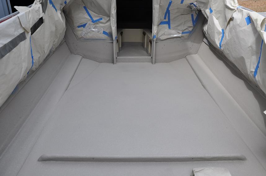

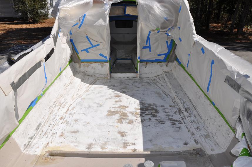

For what it is worth, I just spray painted the inside floor and cabin of our 1960 Glasspar Seafair Sedan with the original "Zolatone" MEDUSA GRAY color. Zolatone is a "speckled"
paint that Mark mentioned. It is very tough and wears real well.
Here are pictures of our Seafair BEFORE and AFTER:
