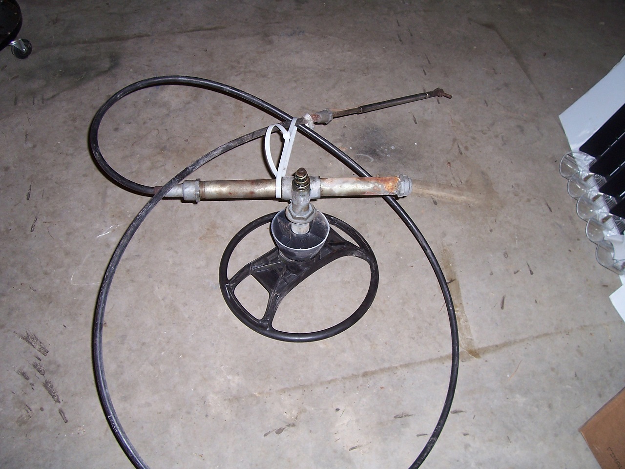

I have an old Teleflex steering system (pipe style) if anyone is interested. I'll give it to anyone that wants it if they pay shipping costs. The cable is fine, but it seems really tight and I'm not sure why. It would be good for parts and could possibly be fixed and used. This is the original steering cable from the 1975 Cacci Craft and is approximately 13' long. Steering wheel included. I'll send pics if anyone wants it.

I'm very happy to have this system here and Thank You. It is a Det-Mar 500 system that was bought out by Tele-flex. They came in a round and flat rack and pinion systems. Parts are available but pricey and expensive what I can see. I'm in the process of lubrication and cleaning the system. So far I took it apart, cleaned it as far as I could. The cable cannot be taken from the inside of the unit so it is soaking in a barrel of used motor oil as I type. I'll check it tomorrow. The cable can be taken off the rack but it is sealed inside the flexible shield. It is loosening up nicely so far. It turns easily about 2 full turns of it's 3 and 3/4 turns lock to lock. I think it is going to very usable.

Robert, That is great that it is loosening up. I hope it pans out and gives you great service. I'm still working on my Suzuki DT50. It runs great, but will not run past 2500 RPM's. Not sure what is going on. I thought it was a prop issue, but after trying several props, I now think it is a stuck "rev limiter" or something else. I have zero experience with Suzuki's, so its the process of elimination.
