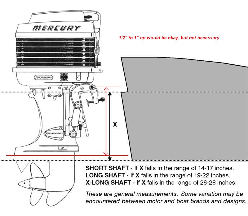

I believe proper credit goes to Scott "Chinewalker" for the drawing;
Re:short shat or long shaft 12 years 1 month ago #76564
Thanks for posting that Mark--that's what I was thinking of when I added my 2 cents. And thank you, Scott "Chinewalker," for a crystal clear drawing that clears up a subject that is often very confusing.
