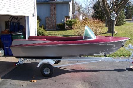

Picked this boat up and trying to find out what year it is and what kind it is. I was told it was a 1958 Cutter Jet Deville, but need help confirming.

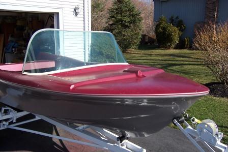

I haven't seen any bows like this one. Is there a light that should be mounted on the bow? Are there different bows?
My steering seems like it was originally mounted on the left side. Is this typical?
Fiberglass is in good shape. What could I use to fill the dings? Should I use an epoxy paint or a gell coat?

Additional image of the bow:

NICE boat, trailer.
Wishing that I could find such a light trailer.

Very Nice! Do you really need to paint the top? Don't paint unless you have to. If it is just chalked and hazy, try to bring the finish back using the procedurs note within this site. I am currently using the process, and you will not believe the results. It just takes time, not instant gratification, and with that, you will enjoy the fruits of your labor!
On to your other questions, your bow light, step pads, cleats, and stern light may have been an option back then, not standard equipment, and thus not added. As far as your bow, I have not seen one with the little hump in the middle of the step up in the front of your windshield. Very interesting design. Please post some pics of your stern and inside of your boat.
Finally, is there is no data plate available, please look in two places. crawl inside, face your transom, on the lower right side of the auto bailer hole you may see a round ID plate. Also, please examine both of your stern lift handles, and you may find a serial number embossed on one of them.
By the way, I have a 1959 14'3" Owens Speedship that I am restoring, that is very similiar to your new find. I will be glad to help you in any way.

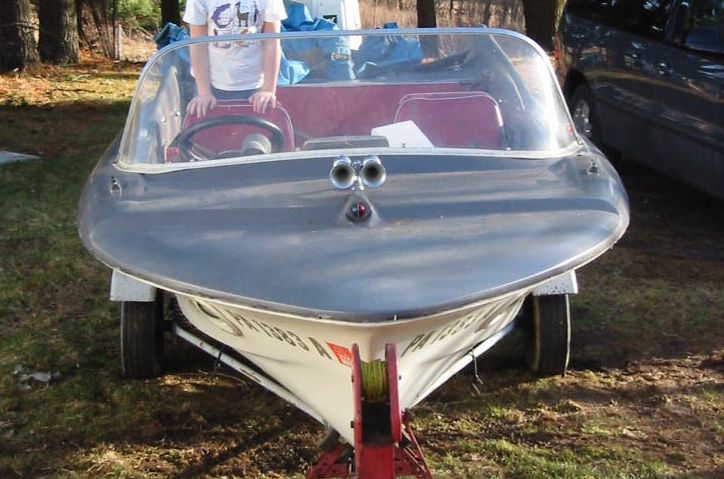

Your boat is an Owens Speedship. Owens Yacht Company owned Cutter and had the factory produce "Owens" and "Cutter" boats. I think only Owens had the built-in bow light, made to look like a certain Attwood bowlight. It would originally have had lenses like in the photo below (not my boat or photo):
In the 1950's and earlier, steering was not standardized and could be installed at the dealer on the left or the right according to the preferences of the buyer. Most boats had symmetrical dashboards or other features to allow for this.

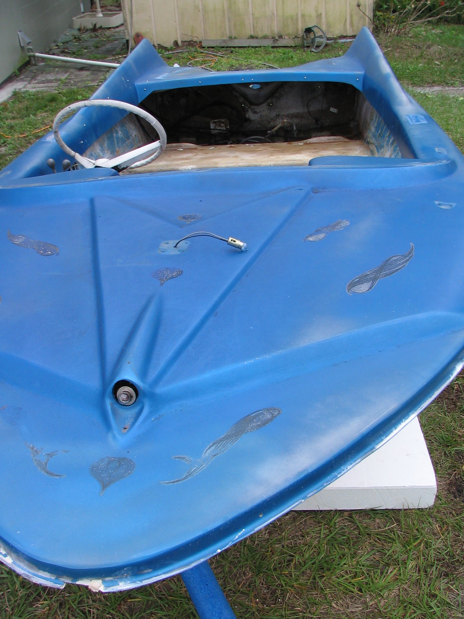

This Cutter differs from your boat in that the bow light was built into a stylized Cutter V on the foredeck. An additional light had been mounted on the bow when I got it, but I do not believe that it was original.

Thanks for the update and picture, yeah it pretty much looks like the picture shown.
I'll need to research and look for a light (or fabricate one out of LED's). I have some hardware not all but I'll keep a look out.
