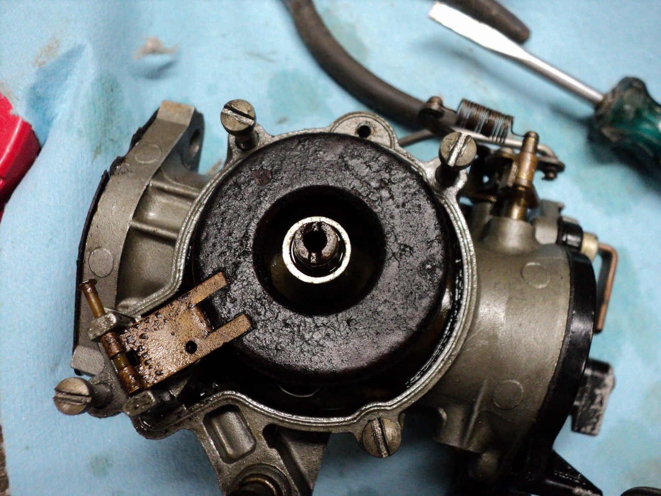

I would say Definitely pull the carb and clean it out well at the very least, put a kit in it if you can find one! Almost all the motors that have been sitting up for a while will have gummed up (dried gas and residue) or sediment in them, many times plugging the small orifices and passageways. Starting fluid contains no lubricant like properly mixed two stroke oil/gas mixture, and is very hard on the motor IMHO.

Being it will not start and stay running first thing to do is clean that carb. This was my Evinrude carb, looks clean on the outside. Not the inside. It was fully gunked up.
