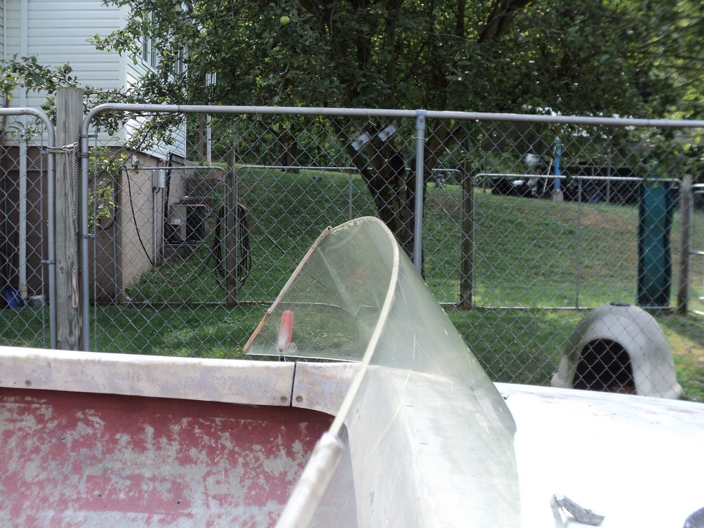

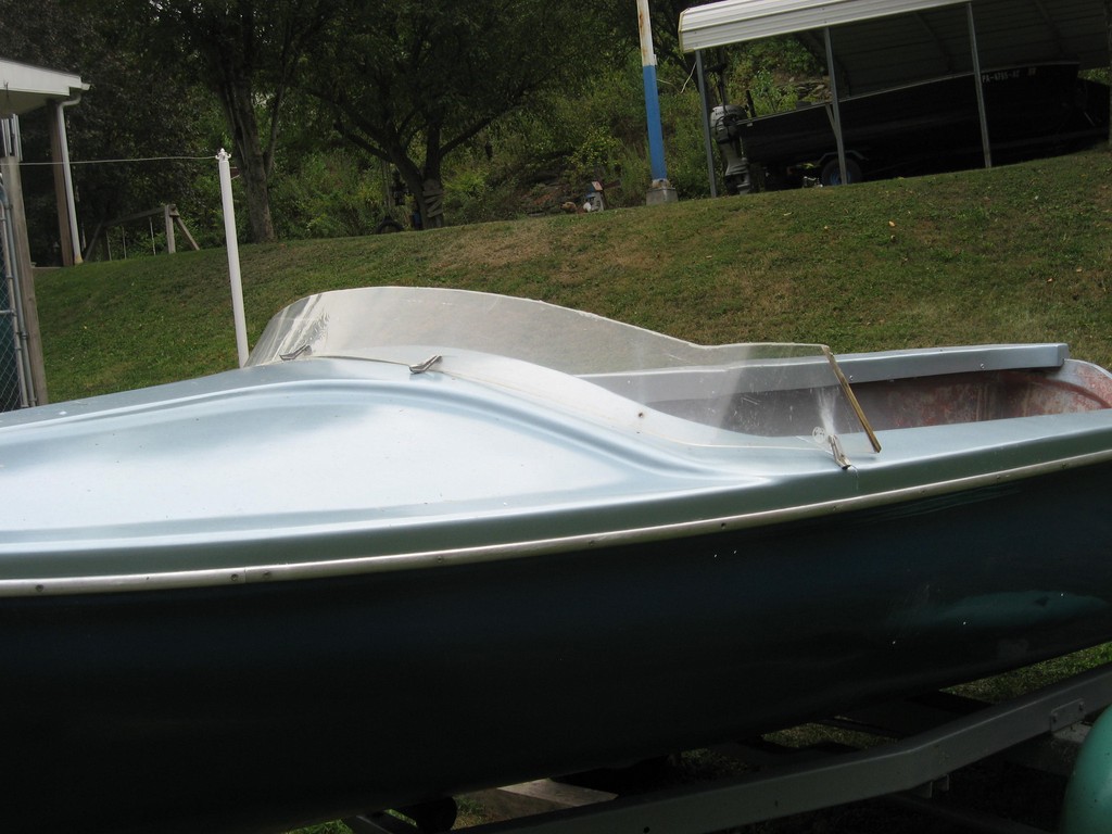

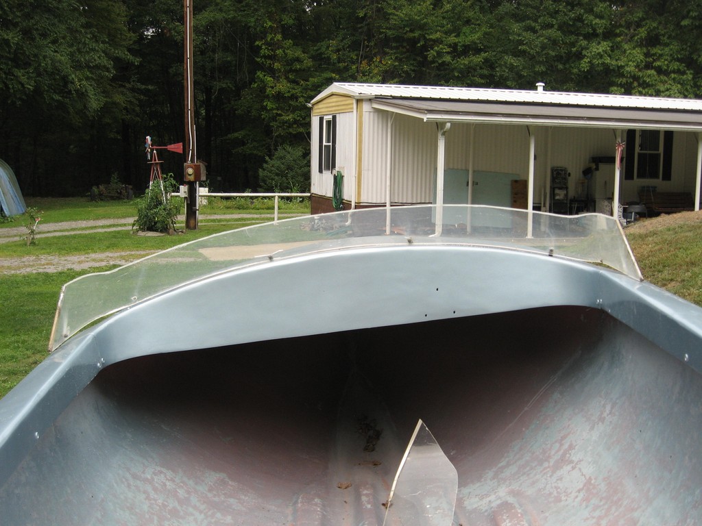

Nice project, and about cutting windshields down. He He Mine is now 6 inches high.Made a tape edge where i wanted to cut and cut it with a very thin cut off saw disc and air powered disc. It's just sitting there in this pics. I did trim the ends different also. It is/was in pretty bad shape so no loss.

Thanks Robert. If I can't fix mine I think I will cut it down but also make a new full size one.

Mark my windshield is/was in horrible shape. I'm always on the look out for a better one. But this one looks better cut up. If it would have been good enough it would have went back on without another thought. I just don't have the funds available quickly. I missed a nice free Corson boat while I was just out of the hospital but could not go get it or load it myself at the time. It was probably in better shape than my boat by the looks. OH WELL ,such is life.

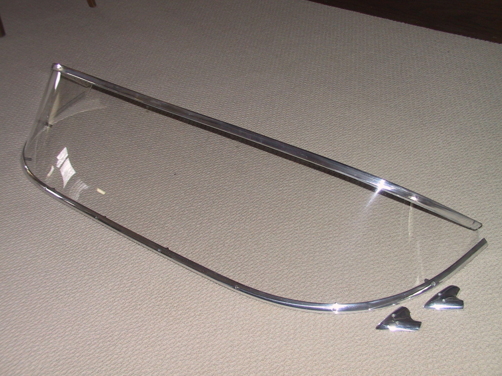

I had to have a new windshield made for my boat and contacted EDS Plastics in South Lyon, MI. I took my old shield to Ed and he had to make a tool and duplicated it perfectly. My windshield has a compound curvature with the wraparound ends and a curve from top to bottom.
He also polished my frame and provided improved mounting screw anchors. The total cost was $ 600.
I also asked him about the choice of acrylic (plexiglass) versus polycarbonate. He indicated that the polycarbonate was stronger and more resistant to impacts but tended to scratch more easily. I work with polycarbonate headlamp covers and have noted the scratching issue.
I have no affiliation with Ed other than being a satisfied customer.
