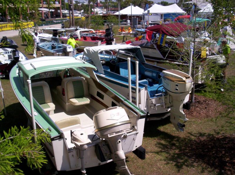

..E. : This idea / request has been done successfully a few times before & all depends how much time / effort the owner wishes in the effect. I just posted a picture a few days ago, here on the main forum under the " NEW TOY " thread.
. One of the Florida Glasspar guys Vern T did the best conversion
with a old OMC donner cowl, & sort of widened the rear (?) & maybe stretched the height (?) to fit over a modern Yamaha engine.
.... The pic below will be the BLUE open boat. This show was two years ago in March at the Mt Dora ,Fla show.. He was displayed between the orig late 60's OMC of a Green Phaeton & my Brown SEDAN.
. Viewers really did a double take, or had to be convinced of the
era mod. ENJOY .. Again repaint your modified cowl , install / attach period chrome logo's etc .
CLICK to ENLARGE pic.. Plan " B " would be use the NEW cowl ( already desired foot print form) & GRAPH / Glass on the period scoops, fins, port -holes, chrome tags,/ etc.
