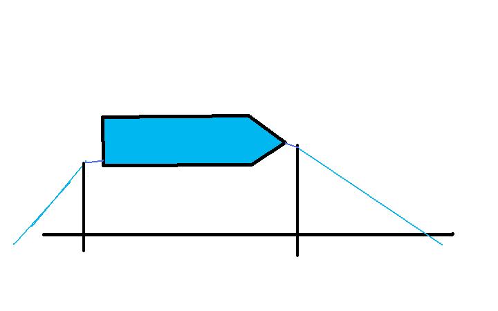

hopefully I have attached my great idea.
File Attachment:
File Name: anchor_ide...0323.pdf
File Size:159 KB
Re:Mooring whips 12 years 3 months ago #75629
this is the sad drawing in case you can't open the pdf. you will get the idea. If you use it please post the after pictures. This is what I would do for better or worse with your setup. If you would like more clarification or to fly me down to set this up for you let me know.

Looks like a good plan to me, simple and affordable. Schedule 40 on the pvc at minimum or schedule 80.
