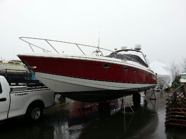

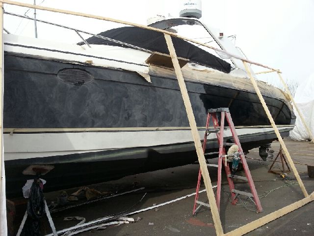

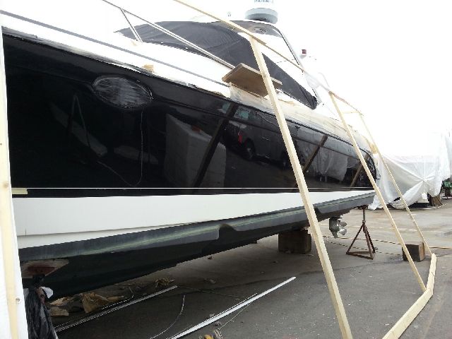

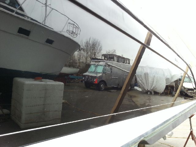

This is my work for this week so far it took me 32hrs to get 1 side done on this 40'Formula.Yes it is a gelcoat paint job and to master this quality it took me a long time to figure it out how to get it to be this shiny as you can see the reflection on that grey van is about 40-50 away and you almost can read the licence plate on it.

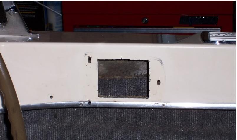

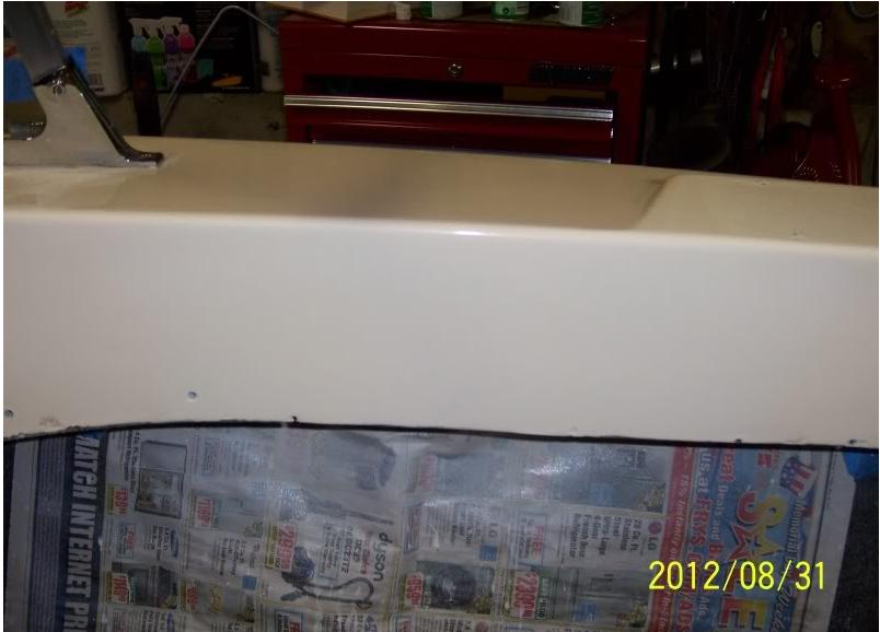

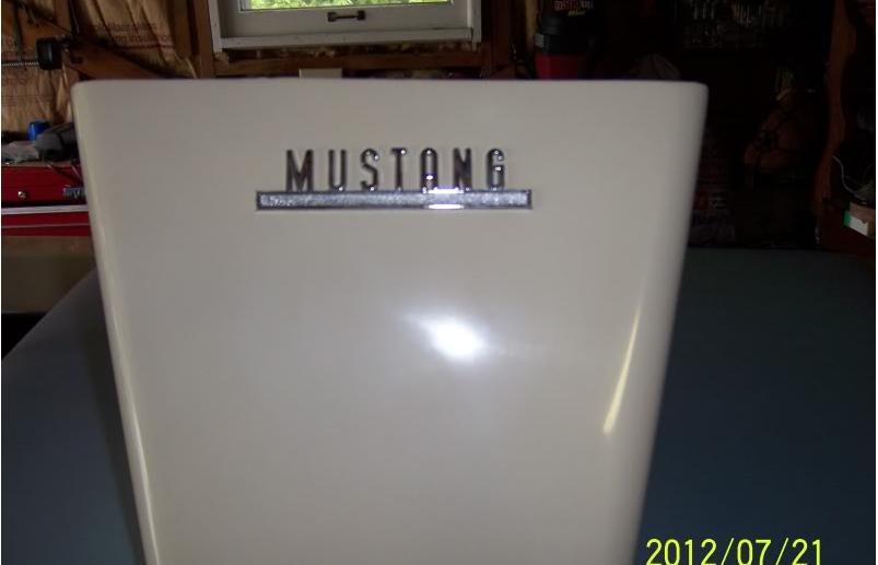

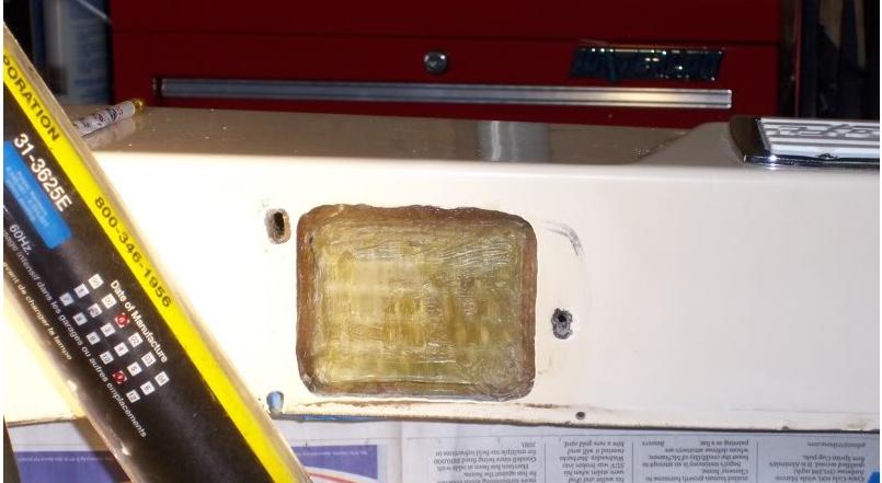

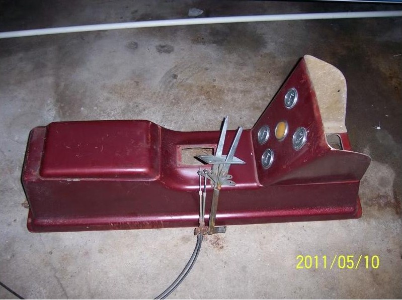

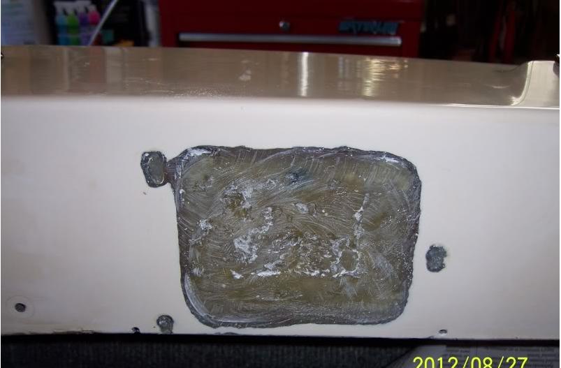

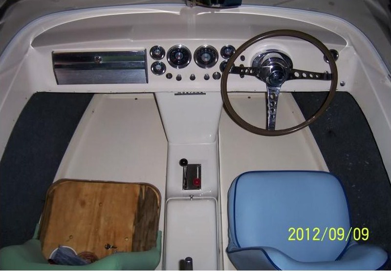

I chose to do gel simply because I wanted to try it and bring back the boat to when it was new. I like the fact that the gel is so thick you can sand with 1500 to 2000 and buff again and again if needed.It just has a different feel. All the repairs I did was with polyester because gel is poly and I have heard that gel does not stick well to epoxy.That said,when I finished with the repairs in the pictures below I backed up the holes with matt and epoxy to give it strength. My Mustang originally had a console with the throttle and shifter mounted in it but it seems most have,like mine, been converted to a single lever gunnel mount.I found a console out of a Barracuda which only needed the bottom cut down to fit. I sanded everything with 80 grit and only removed all the way to the glass if there was chipping and loose gel. When I was ready to shoot I cleaned with acetone and also wiped with styrene. No matter what I tried I would get fisheyes so since I had gel with wax added I'd wait a day sand and then touched up the fisheyes with new gel just dripped on.A good sanding to blend in and then another coat. By the time I got to the base I was not as fussy and just delt with it. The biggest problem I had the whole time was that little buggs were attracted to everything,they could be sanded out too but after the final coat it went straight to the garage and all lights were taken out of my door openers and overhead lights so other family members would not accidently turn one on. After all this the finish was very orange peely but a good 400,600,800,1000 then 2000 took care of that,followed up with 3m 05973 rubbing compound and 3m 05996 Perfect it II polish using 3m foam pads. By the time I did the gunnel repair I had found out about Duratec Clear and using it at half the recommended rate used that. The finish was alot smoother and required less sanding. I my case the hardest part of the whole job was me trying to color match.I used Minicraft of Florida's gel and had picked a stock color that turned out to be too dark. I cut a piece out from behind the rear seat to have them color match but it turned out too light,but by combining the two I got a good match. This little project thru trial and error almost used up those 2 quarts!

While I figured out the gel coat thing,I'm having trouble posting multiple pictures sorry---
And finally-
Re:Spraying gelcoat? 12 years 3 months ago #75513

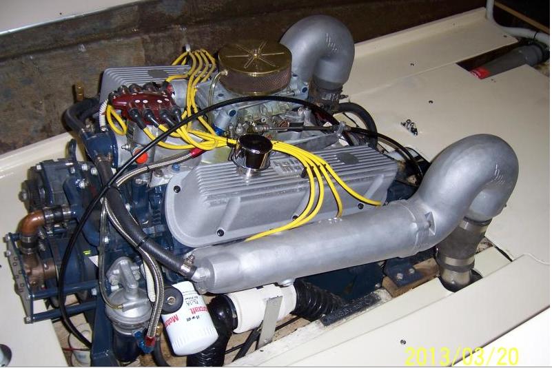

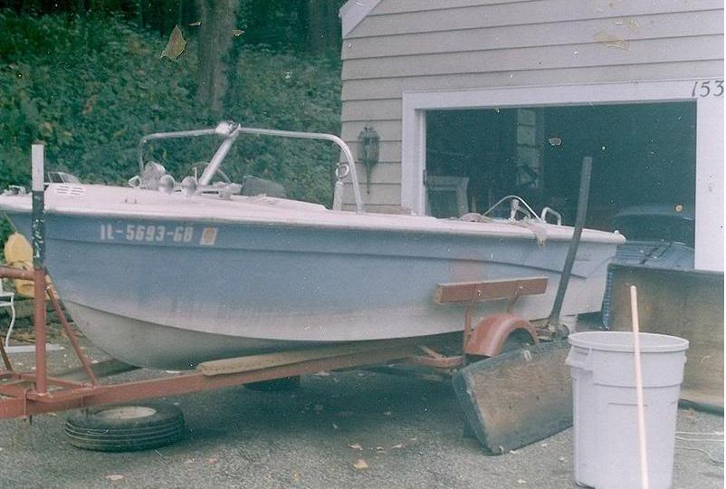

Thanks Mark it means alot when someone tells you that knows what it takes to get to that point! I have had alot of help from people I've met on the Correct Craft Fan site,without whom I would have never found the missing pieces. The first picture is how it looked when I got it in the late 80's.The interior is out being done now and after some manifold painting the whole boat will finally be done this summer.Engine picture is current.

Chuck,I feel that I didn't have that much to fill and so didnt use a filler. I really beveled the old gunnel and each time I added a larger and larger layer of matt,then grounded back down to match the original glass level. I then sprayed the gel on to bring the thickness up to the original level,then like painting, went past the repair as far as I could to the front and about a foot to the back. Then I could sand it to blend it back in.

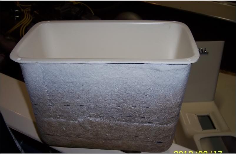

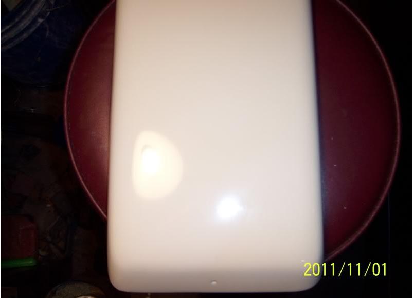

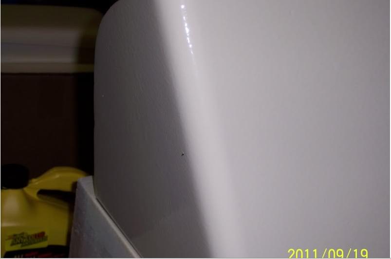

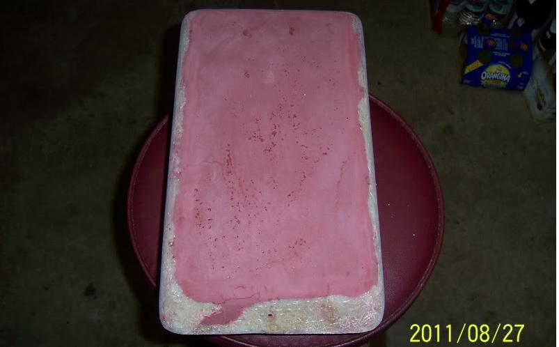

US Composites is a good company to deal with and prices are great also. As to a suction gun, most likely won't work the gel has to be too thin and you'll have trouble with runs and sags. You also need a large tip 2.0 or larger. I tried styrene,same thing runs and sags plus I understand it's dangerous,not good to breathe. The Duratec Clear serves the same purpose and works well and helps the gel set up too. The first time I used it is the picture below, It's the inside tray of the glovebox.Hard to see the gloss to it but since it's the inside of the box I didn't even bother to sand and polish,it comes out that smooth. For a outside finish it would take very little to sand and polish.The last picture is of just a plain gel finish,you can see the orange peel and the dullness of the finish. It needs quite alot of sanding,600-2000 and then a good polish
