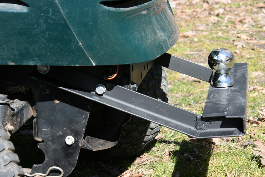

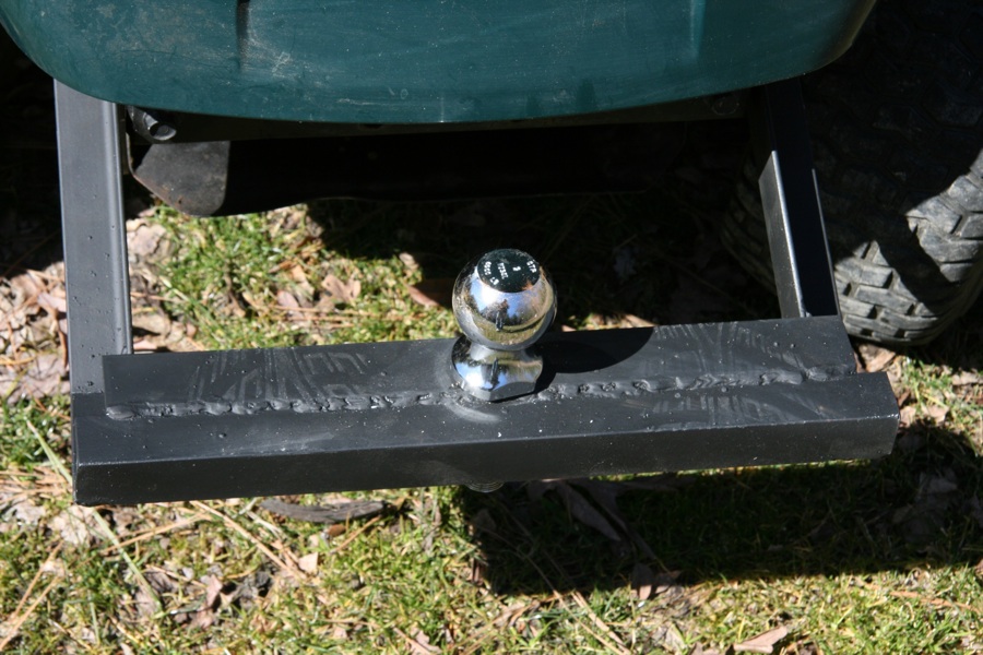

Here's a few pics of the new hitch on the tractor. My first welding job, not too bad.
Those are my shoe prints from me standing on it to make sure the weight wouldn't lift the back end.
Now the only problem is there isn't enough weight on the back end. I can pull the trailer out of the shed but it doesn't want to go back in. The tractor has the power but the wheel keep spinning about half way up the ramp. I guess I'm going to have to see if I can find any back wheel weights and I think it may do the trick. thought about trying to make some but not sure what to use. I want to use wheel weights, vice just putting some weight on the back, so it doesn't affect the transmission.

the cushions look great bob,and for your 1st time welding im impressed.
as for the front hitch doesnt it steer alot better than tuning around to back it up,i know mine did,now just put a little meat on your bones and your good to go,lol.

Thanks guys. I think I'll try the liquid ballast trick. My only concern is that I have a tube in the left rear tire, can I still do this? If so how do you really do it?
Jim, how did you do yours?

Having an inner tube won't affect it. I used a pump up sprayer with an old cut off(5 ft) garden hose with the male end still on it and an adapter that fits the valve stem and the water hose male end with an air bleeder on it.
What size are your rear tires,Bob?
Re:New boat mover and new cushions 12 years 3 months ago #75333
  • Jim L
  • Jim L's Avatar
  • Posts: 1426
  • Karma: 60
You have to leave them on the mower and let all the air out of the tire first. Then add a 1/2 gallon antifreeze per tire (if your tires are the size I think they are)with the rest water or you could just buy 50/50. Just depends on how cold it gets where you live.Pump it up with the hose kinked and attached to the tire with the valve stem in the upper most position. after you get it pumped up let out on the kink. You should hear fluid going in the tire. When it stops, kink your hose and press the bleeder to let out the air in the tire to make more room for some fluid.Some fluid will also come out. Repeat until it's 3/4 full. Anymore and it will ride like a rock. Hope I made sense lol.
