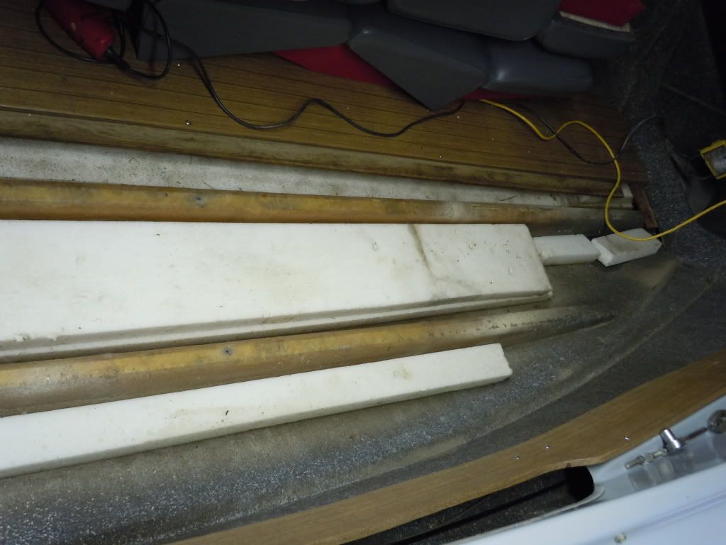

I have a 62 Crestliner Del Rio and mine has fiberglass stringers with marine plywood screwed down on them. I'd say if yours has vinyl covered plywood screwed down with stainless steel screws,your stringers would be hollow fiberglass(won't rot)

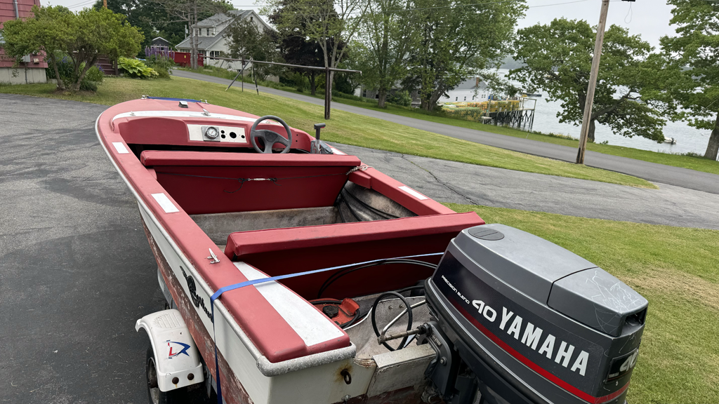

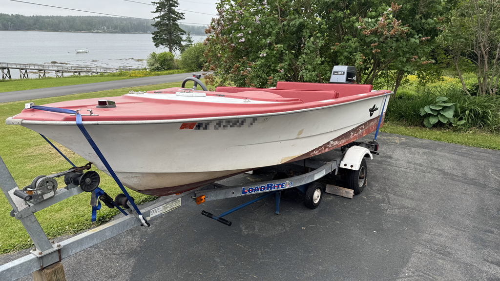

I'd love to hear more about how this went. I just got a 61 Crestliner Mustang and am working on making her seaworthy again.
