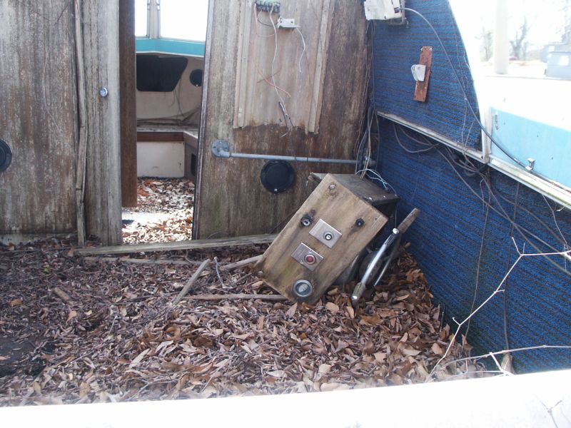

Re:plywood ? 12 years 4 months ago #74615
Although my deck is pressure treated I would not use it in a project like yours. My deck is open in front and back and is just a single sheet 8 foot long. Air can easily circulate under it. My boat never gets wet inside unless it rains while I'm in it. It has been good but I have seen in a few other boats I looked at that they used it and it had warped. Of course in those times I seen it it had been left to the elements without even paint.The area by the stern was left this way because my fuel tank and tackle box fit perfectly and does not slide.
