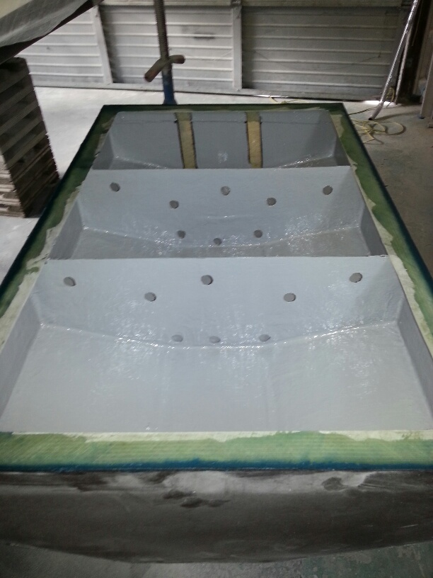

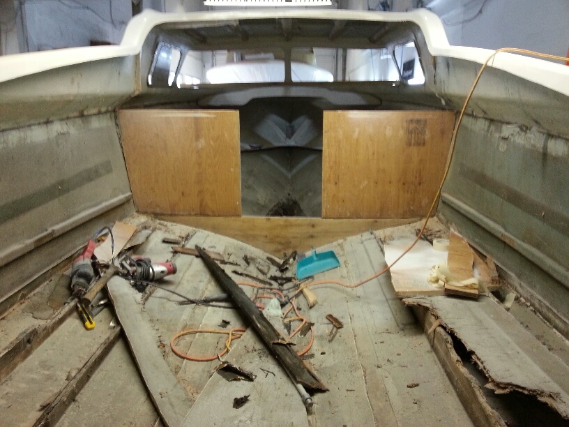

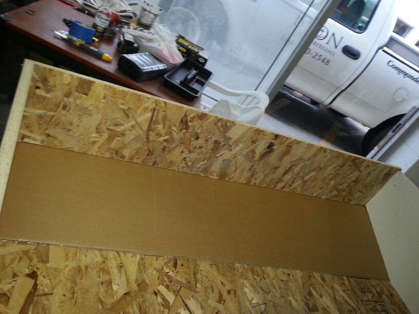

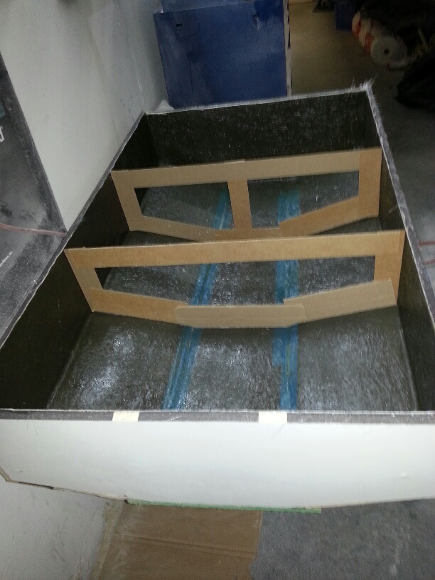

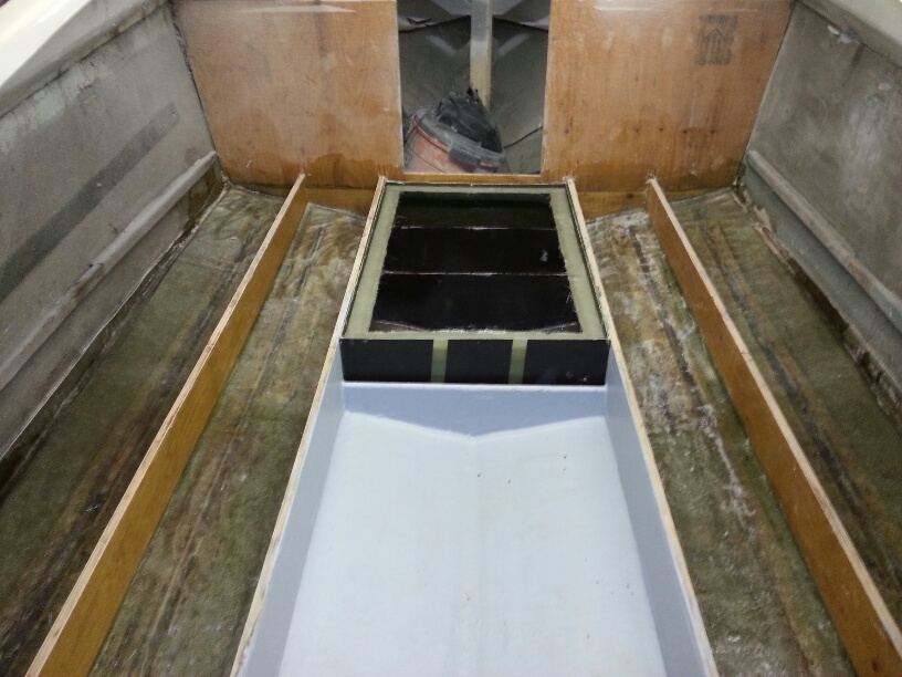

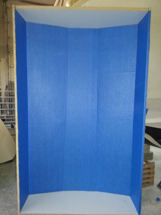

To start of i haven,t sold my Commando U2 yet a couple offer but didn,t take it.Anyway let get back to my Dorsett as you can see i got the new stringers all glass in and reinforce the bottom with extra 3oz of matt.I try to find a fuel tank in the local marine store here that i need but no one carry one so i decide to make 1 that i want.Check around to shop for material and found afew extra scrap of carboard paper,malinine and what ever you want to call that wood is on the side.Afew cut later i hotglue everything together and i have a mold.tape it all up with blue masking tape and gelcoat my mold.I glass it all and make a bafful and flange to glass my top lid on after i pull the tank from the mold.I dry fit it between the stringer just to make sure it fit and took it out again sand the inside of the fuel then i coat it.not done yet but will post pic of under floor before i cover it up.

We use to made fishing boat about 20 yrs ago and we made fiberglass fuel tank for them those boat are still around until today.so what I see is that if you do it right it should last.

Commander, do what you want but I would not use fiberglass for a fuel tank in this age. 20 years ago or even earlier in the 70's gasahol was starting to come into use and the effects showed up later with carb internals plugging, engine failure, fuel line failure because of the alcohol eating away at the rubber content. Here is a partial article you might want to read and also a link to the whole study.
"A few years ago there began to be reports of fiberglass tanks failing. Over the last few years the trickle became, if not a flood, a running stream. The Boat Owners Association of the US (BOATUS) commissioned a laboratory to do testing of fiberglass tanks and found out the alcohol can dissolve the resins in the laminate. As we now know, fiberglass is not impermeable, as had been thought back in the 60's and 70's. When boats began blistering in the 1980’s, the Coast Guard and others began studies to find out what was going on. To make a long story short, fiberglass reinforced plastic or FRP, is actually a semi-permeable membrane and liquids will penetrate the resins. This is what led to blistering. Alcohol will penetrate FRP as well and dissolve uncatalyzed resins. That is, resins that were not mixed well with the catalyst and never set up. If alcohol dissolves these then eventually the damaged will be extensive enough that the laminate will fail. This does not happen overnight. It takes years, and it takes long exposures to alcohol. Boats typically sit for long periods of time with full fuel tanks, allowing the components of the fuel to do the damage. This has not been seen on automobiles or trucks because fuel simply does not sit in the tank and system for very long. However, the research shows that the potential exists for tanks to be damaged in a short time span, 6 months to a year, depending on the laminate, the resins used and how well the FRP laminate was made. But almost all of the tanks that have been reported as leaking have been built in the 1980’s or earlier. "

Dam, i didn,t know that until now.i hope that layer of expoxy help,s it somehow.if i get 2-3 yrs out of it then that is good enough.i just have to kept in mind that the fuel tank have to come out and don,t built anything on top of that area.thanks i pass this on.

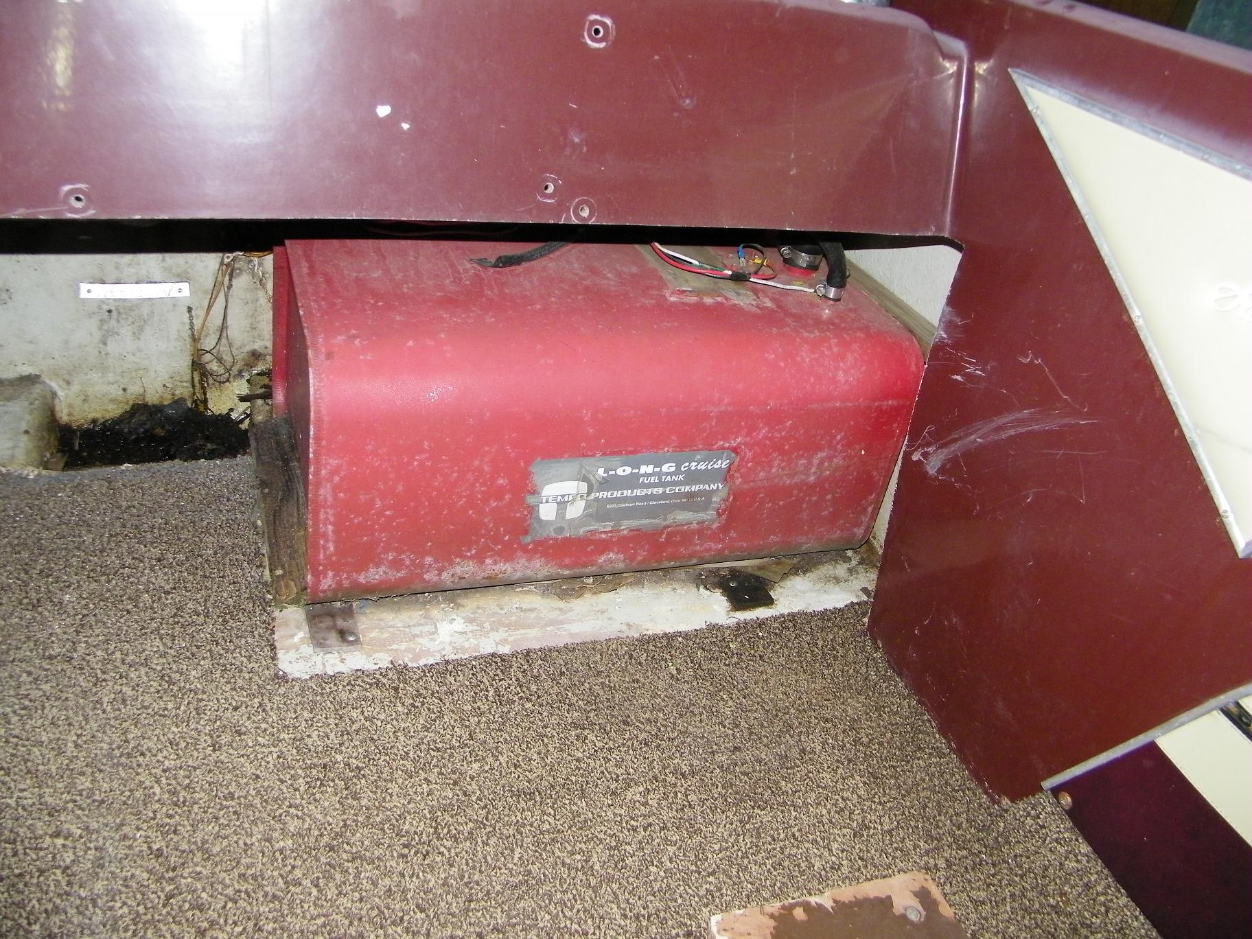

Don't want to hijack this thread anymore...but.... Here is the tank. Was removed when I started the rebuild. Looked at some of the sites for the liner stuff and I think that's what I will do. Thanks for the info.
Cal
Re:new stringers and custom fiberglass fuel tank 12 years 4 months ago #74380
