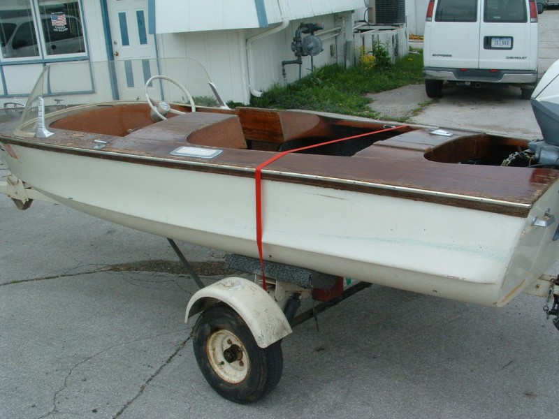

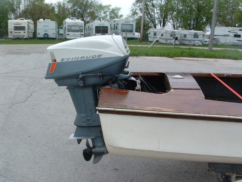

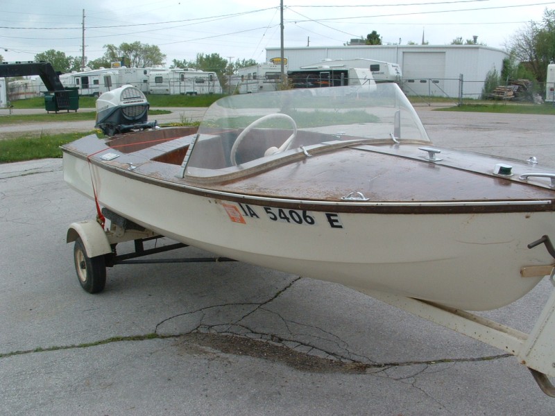

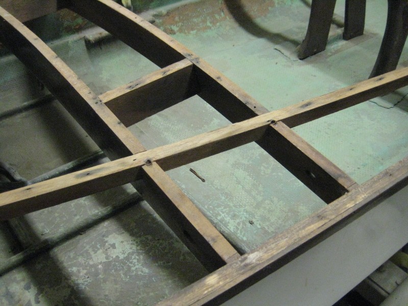

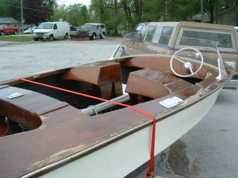

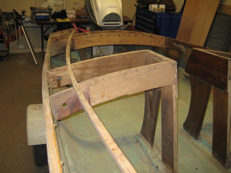

Here are some shots from several years ago.
Re:1955/57 Crosby restoration 13 years 8 months ago #73830
Well, That didn't work! These were supposed to be all different pictures!

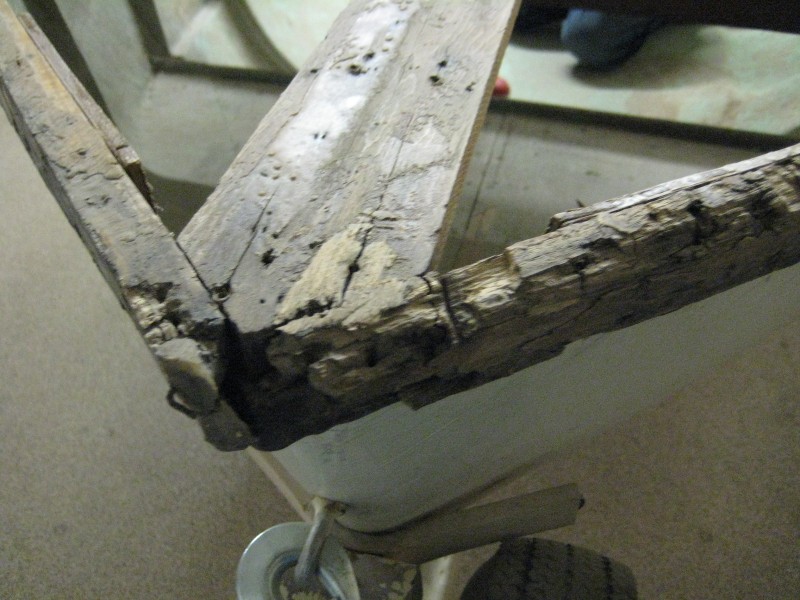

More Pix.

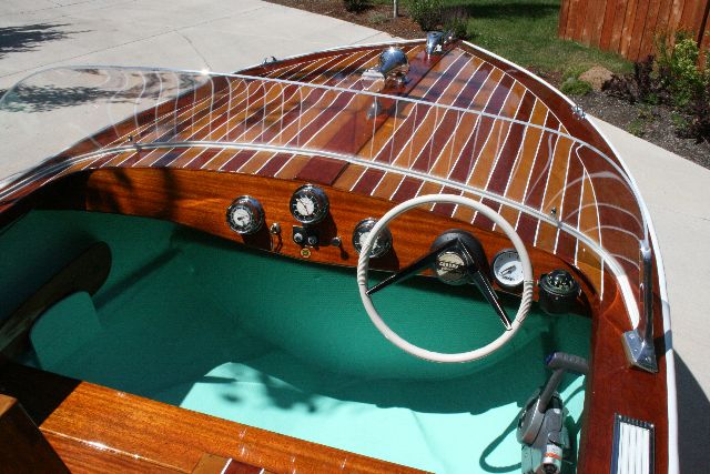

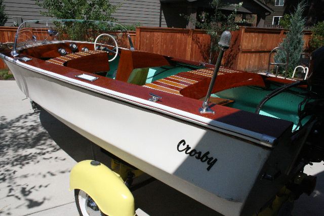

Nice Crosby. Great to see another one coming back to life. Here's my '57 Crosby Capri. Did a little bit of restoration last summer (new varnish, moulding, and interior paint) and got lots of advice from great folks on this site.
Brian

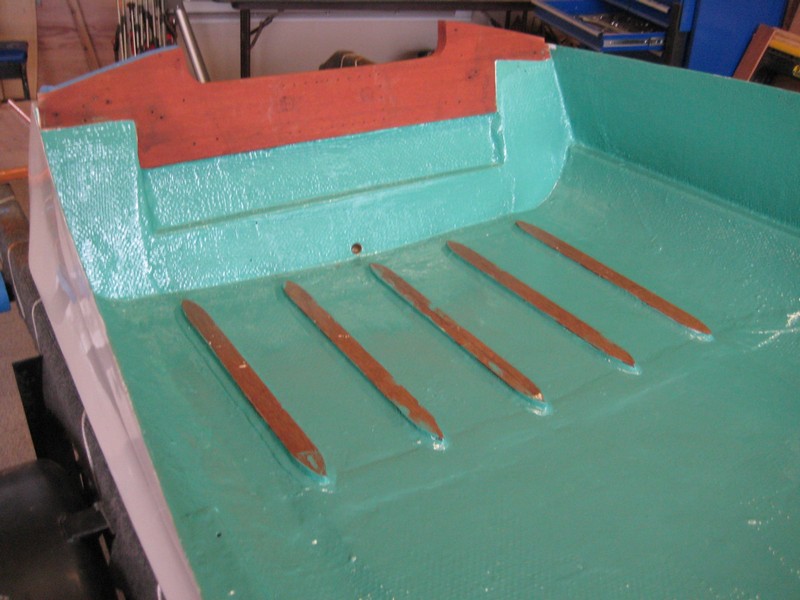

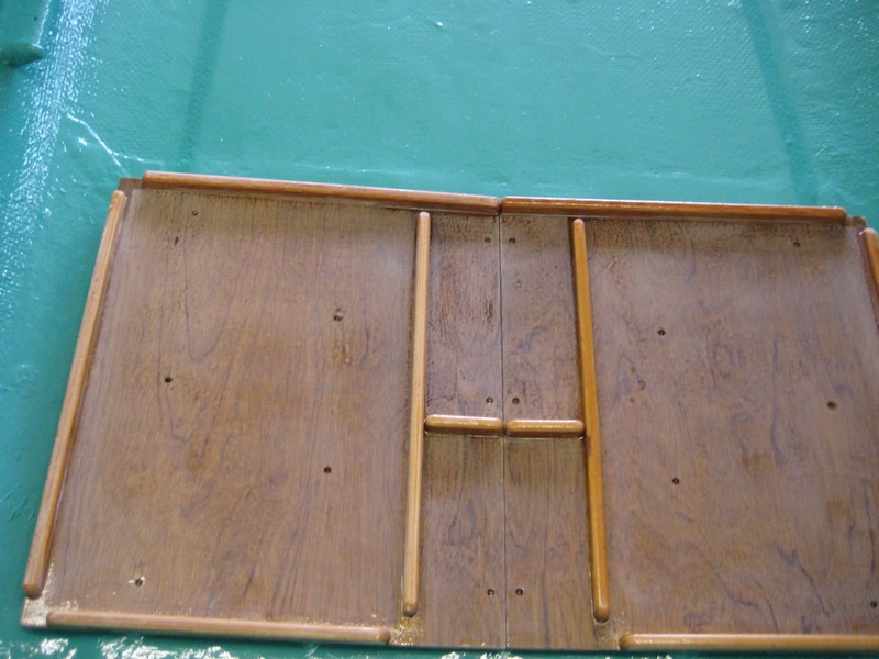

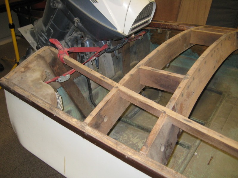

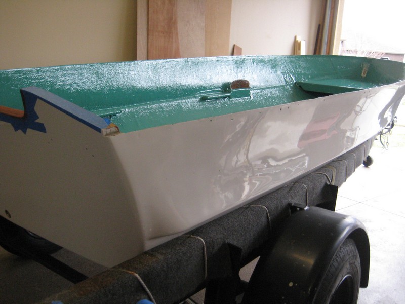

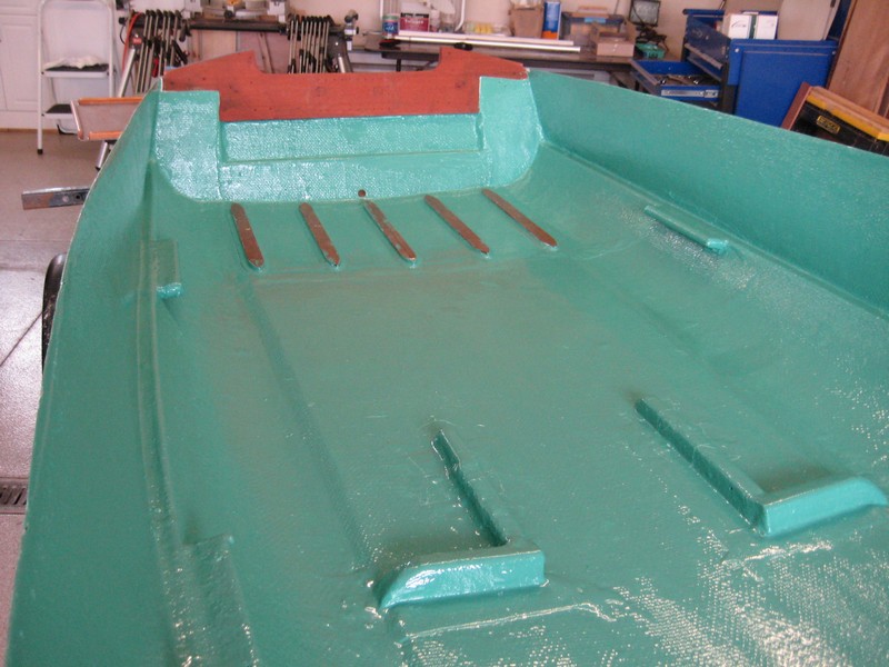

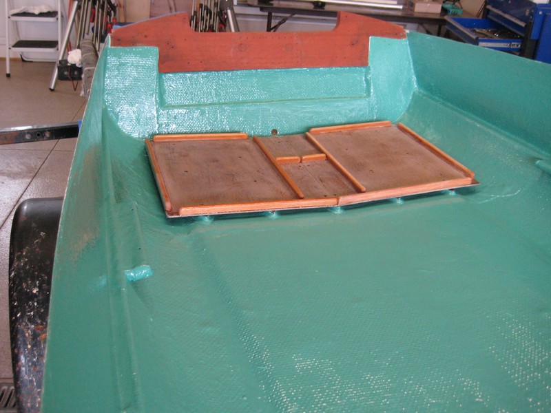

Well some time has passed and the hull has been re-gelcoated, the interior stripped, the cored floor area dried, some balsa replaced, the carpet glue mostly gone, interior and exterior leaks and pinholes sealed, interior wooden framing restored and new white oak gunnel rail fabbed, steam bent and installed.
We were quite surprised at the number of pin holes in the interior glass roving cloth right from the factory. The balsa floor didn't have a chance right from the "Git-Go". It really needed another coat of resin to seal it well from the factory - but we took care of that, 2 coats of rolled and brushed epoxy, a good heavy coat of marine primer, and a good heavy coat of Epifanes Seafoam green yacht enamel.
The original fuel tank and battery trays were glassed onto the bottom of the boat at the stern and the wood they made these from and glassed over was really rotten and oil soaked after all these years. So, we ground, cut, chopped out all of this and built new with a slightly different design.
I made 5 3/4" thk. rails epoxy sealed to the bottom of the interior floor to elevate the new epoxy encapsulated tank trays off the floor so water can easily migrate to the stern and out the new stern drain tube. I think this will work nicely.
Pictures following.

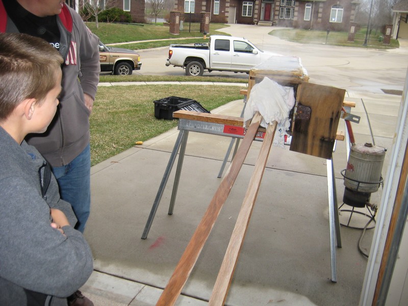

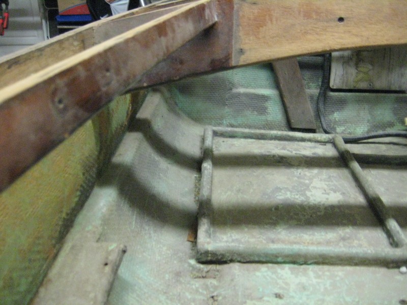

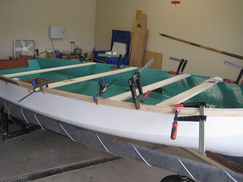

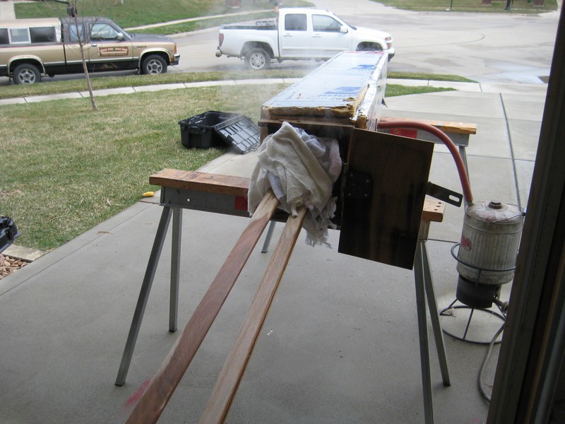

Re:1955/57 Crosby restoration 13 years 5 months ago #76640

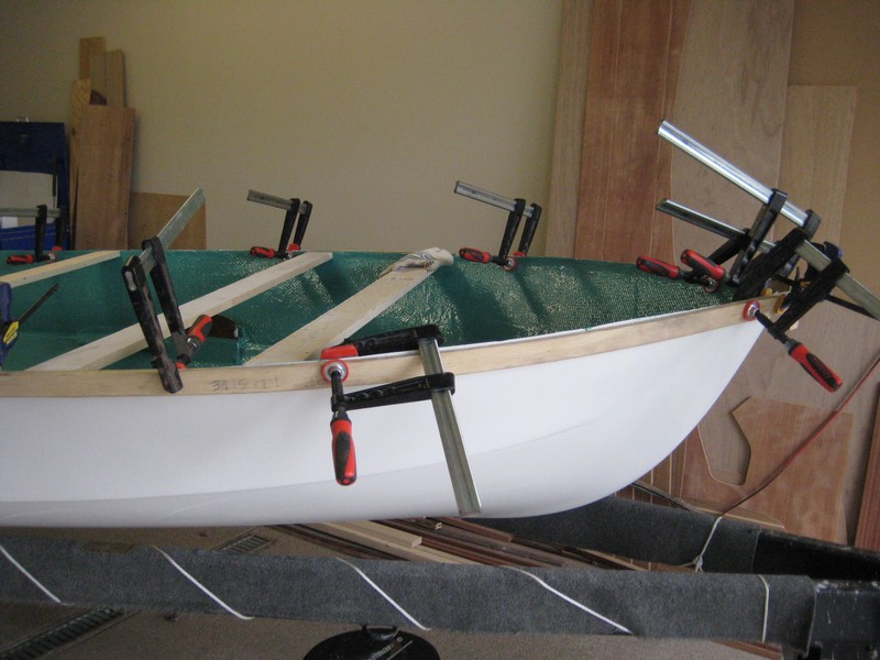

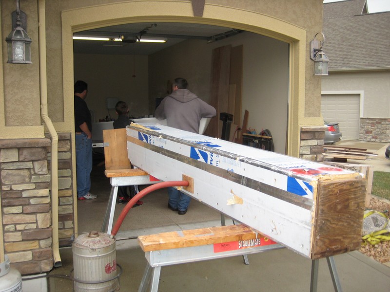

Here are som shots of the new gunnel rail being steamed and clamped to the hull exterior to take the curve of the hull as it cooled.

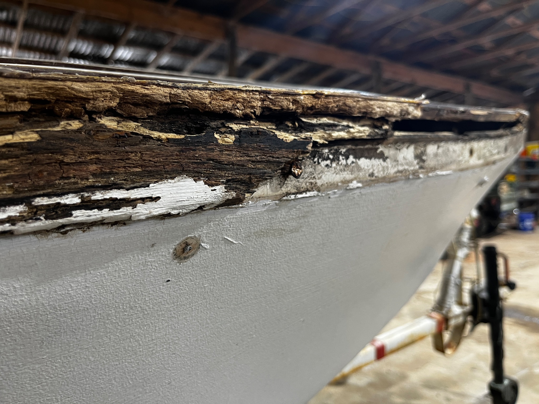

Re:1955/57 Crosby restoration 1 year 3 months ago #149142
I just purchased a 57 Capri and am admiring your work and build. How did you do your gunnels? Do you have an inner and outer (separate) or did you use one solid piece with a rabbit cut for the edge of the hull? It looks like the original on mine had a single piece of wood.
