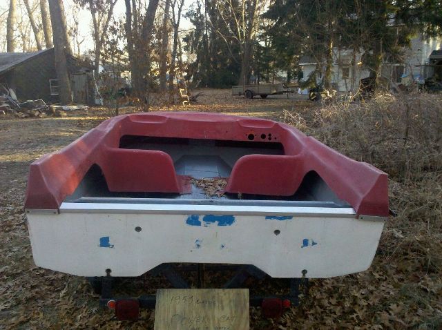

All right I'm just trying to get everything together for the restoration of my 63' power cat. I have never had a twin outboard setup. Will I need a LH and RH rotation Motors or will it work with same direction motors? For the counter rotating motors what is the correct way to configure them.

C-R motors not required, but would perform a little better. Difference in performance mainly in the way the boat handles / steers. If you can easily get your hands on a set of C-R motors, I'd say go for it. But generally speaking standard rotation motors would perform just fine on this hull. A set of C-R motors generally costs more than putting a matching pair of standard motors on there. Excepting for special racing engines, I believe that Mercury was the single builder that furnished left rotation motors for the general boating industry. So if you want a ser of C-R motors - it will probably have to be merc.

unfortunately, it is far more involved than that. Counter rotating Mercs had a special linkage that allowed the engine to be run in reverse. The disto could advance in both directions of rotation. A conventional engine can only advance in one direction, not both. No other mercs or other brands used this system. Also the DR mercs had a special water pump that worked in both directions. It had checkvalves and stuff no other engine has or has since. Then the lower unit is different. You can't use a R-H lower unit in reverse - because the thrust on the gears and bearings will be transferred to the nnormally "unloaded " side of the parts. They will fail quickly. The L-H lower units have specially designed internals for this.

As Bruce has said, counter rotating motors are nice but not
necessary. If you do go with CR motors having them turn in
or turn out makes little difference, I have always preferred
having them turn in but have seen both with no change in
performance. On V-bottoms and boats that lean over in corners
it can be an issue, but on cats it don't matter.
