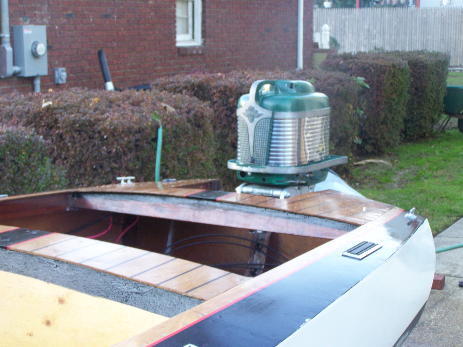

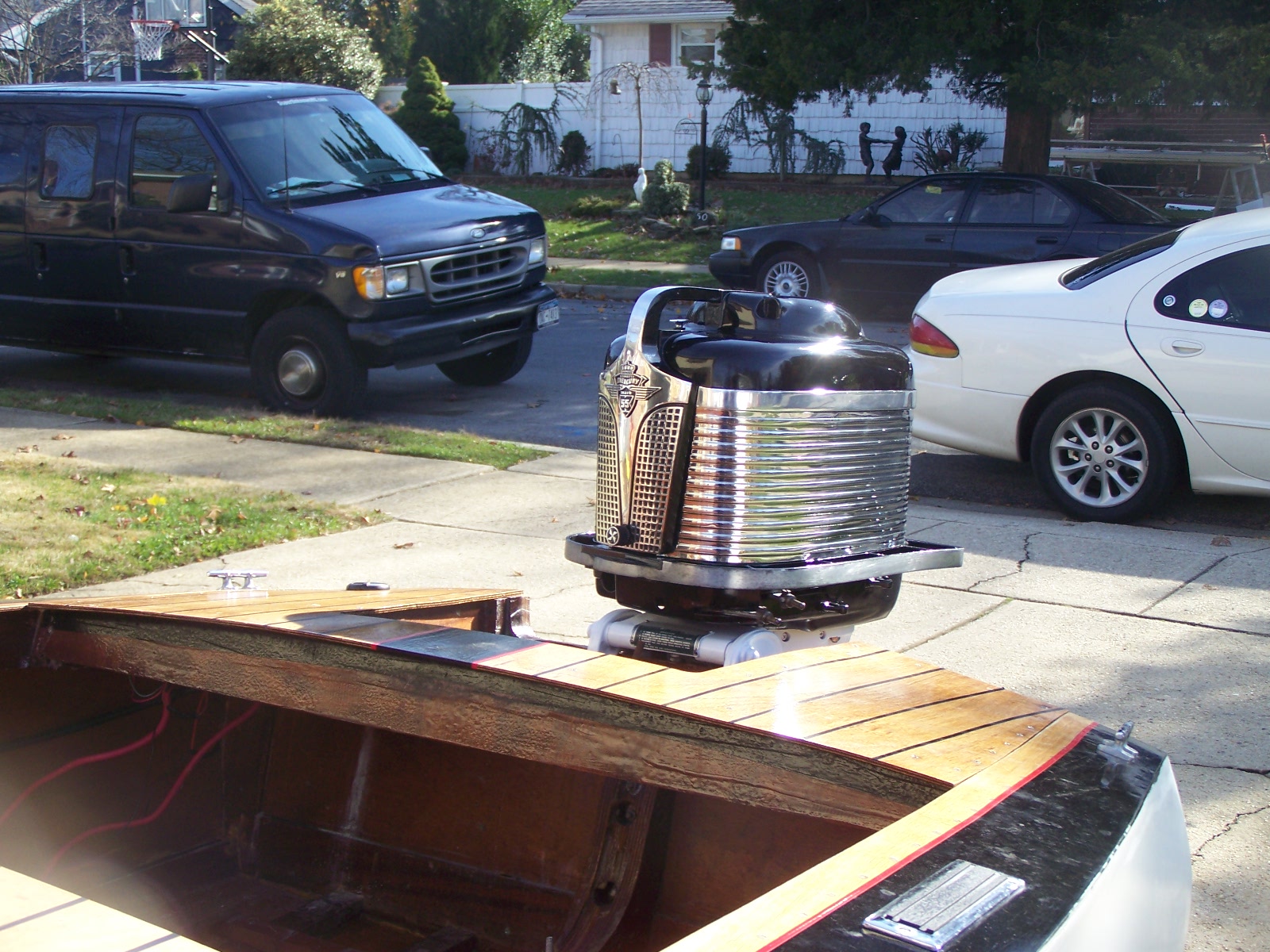

Before pic
Re:Good first motor? 12 years 5 months ago #73584
After Pic
Re:Good first motor? 12 years 5 months ago #73594
Wow, nice Merc!

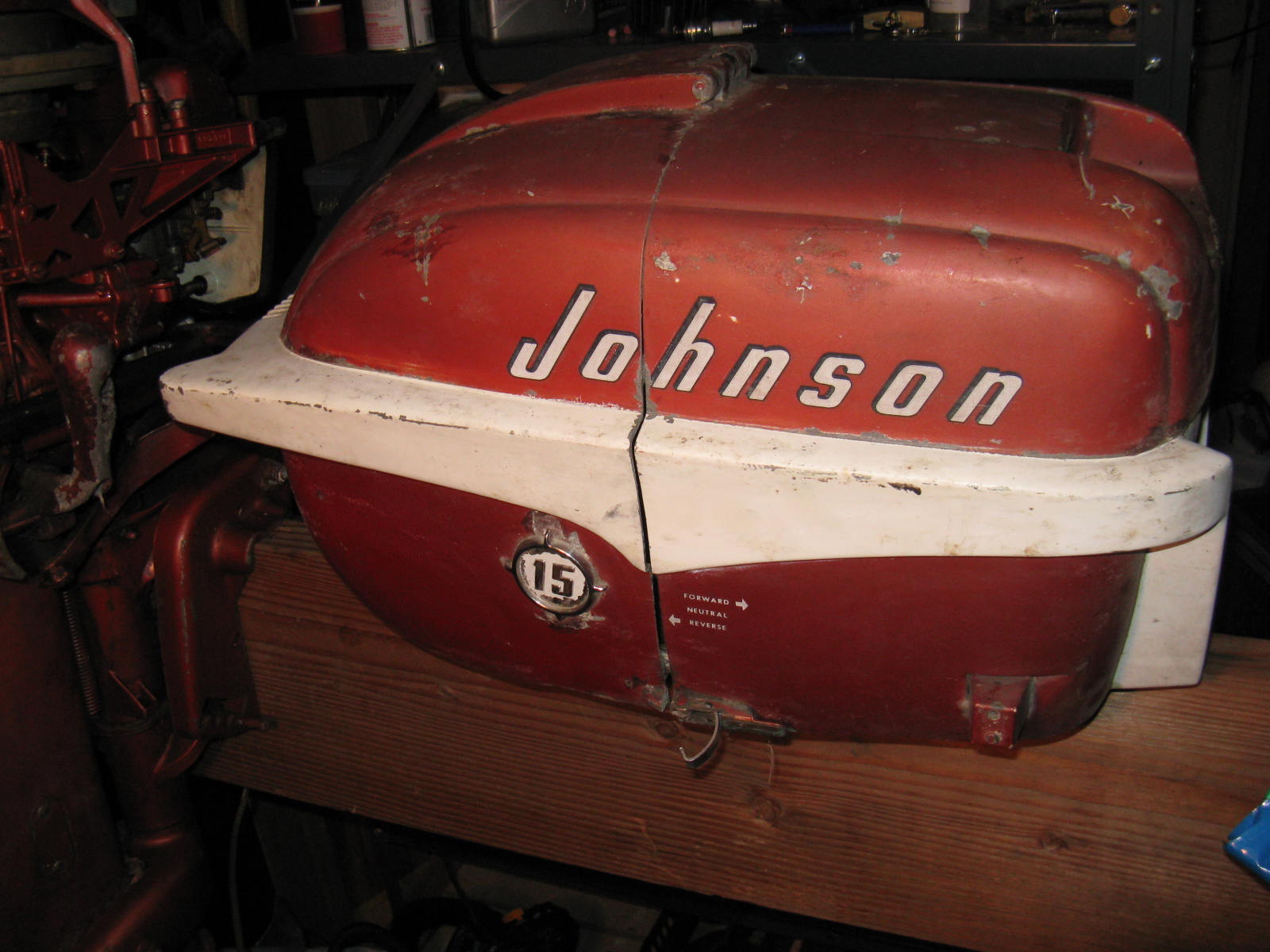

Haha, thats exactly what I did last night. I went over and raided the stash for something smaller that looked like it has a chance of coming to life. Grabbed a 57(I think since has the round symbol around the 15HP insignia on the side) long shaft Johnson. Not frozen,prop turns... I can see a little burnt wire up under the flywheel I'm guessing coil wire? And there is a little corrosion on the outside of the block near the shifter handle. But it looks decent overall. Anyone want to walk me through your general checklist on going through a potential motor when you first get home? Compression check, I'm thinking I should loosen up the pistons etc though first with a seafoam soak or something before trying to turn it over a bunch. Steering is pretty darn sticky. I don't need to work on the lower before compression check though right? Thanks for you help. Figure I'll do this one first if it's a good candidate, then move on to the bigger 40's which I know are great candidates. If I can get this one repaired I'd like to surprise my father in law. I specifically looked for something that was buried and that he probably won't notice is gone.
Thanks!!

I am no expert.. as I said I am a tinkerer. I usualy start by oiling it all up so everything moves smoothly. Check the compression then I usualy remove the lower unit and check the water pump impeller and change the oil etc.. While that is off I take off the fly wheel (on an OMC)and clean the points and check the coils etc.. ( I have only fiddled with one small merc with the points and coil in the fly wheel 1965 35hp 2 cylinder) see if I can get spark, if not I source new coils and points and install. I also clean the carb and check the float, if it has a fuel pump I check the digaphram as well.. usualy I just replace all the gaskets while I am in there. Reasemble, check the timming on mercs with belts.. and see if it will fire up in a test tank. :-) thats my rambling thaugts of how I go about it as a novice tinkerer :-)
I am sure you will get imput from people far more expirianced and professional than I but for what its worth... :cheer:

You picked a WINNER imVho. - the mid50s to mid60s, 2-cylinder OMC OB are easy to learn on.
BUY yourself a copy of CHEAP OUTBOARDS & read it from cover to cover, if you have not already done so & get your little OMC going right along.
(I replace ALL of the coils, points, plugs, condensors and the impeller on EVERY OMC outboard that I find & "mess about with".)
note1 : That 15HP Johnson would make a FINE "second" or trolling motor for a Fiberglassic.
"JOHNSON MAROON"/"Johnson Green" paint is available in "rattle-cans" & you can find original style decals on ebay.com.- Those little Johnnys are easy to return to original looks.
Note 2: My next project is a 12HP Gale that I found "unmolested" in a barn over in New Braunfels for 50 bucks.= This one will be restored & go on a little Skeeter boat/homebrew trailer that I've located. It will be my bayou & creek rig for "perch jerking".
BEST WISHES & GOOD LUCK.

The 15hp you found is a great starter motor and is unique in 50's OMC's. Up until 1956 OMC kept some differences in HP offerings in the 2 model lines eg Evinrude had 3, 7.5, 15,& 25hp Johnson had 3, 5.5, 10,& 25hp in the 1955 model year. In 1956 it was decided to combine the lines and the selection for both brands was 3, 5.5, 7.5, 10, 15, & 30hp. The 15 and 30hp models were available with electric start. In 1957 the 15 and 30hp models were replaced with 18 and 35hp models which makes your 1956 a 1 year only model. The ignition is dead simple to work on, the carb is easy to service, swap out the impeller seal up the LU and your off the the lake. Once you have done the 15 you will notice that other than size the Lark is exactly the same in the manner in which it is built and after doing 3 or 4 OMC's you will be able to service any of them with your eyes closed, not so much for the "dark Side" Mercs!!! If you want a reliable, quiet, torque laden motor the Lark is for you. Fuel Mix for both motors is 24:1 using TCW3 oil and ethanol free gas if you can get it.

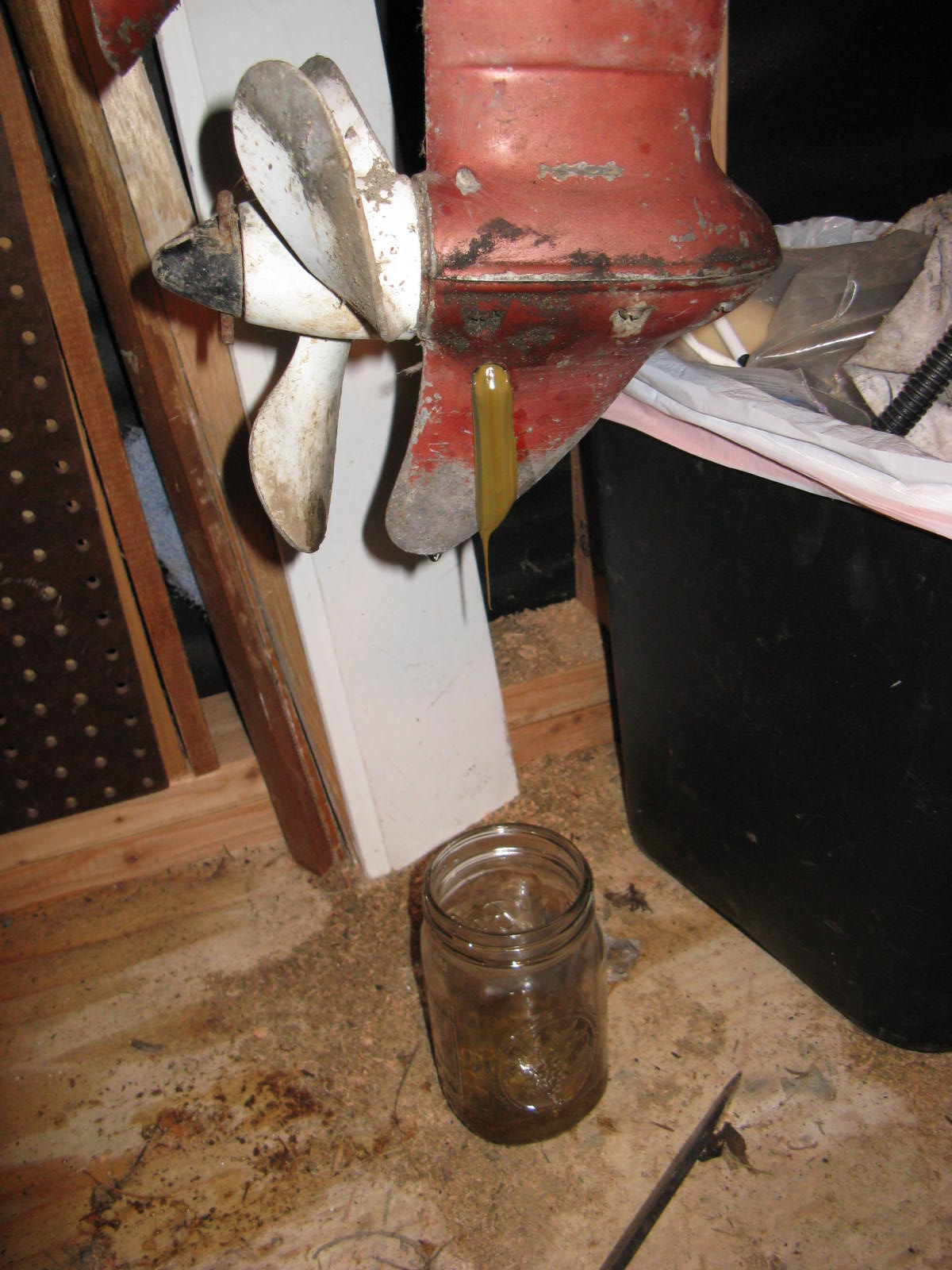

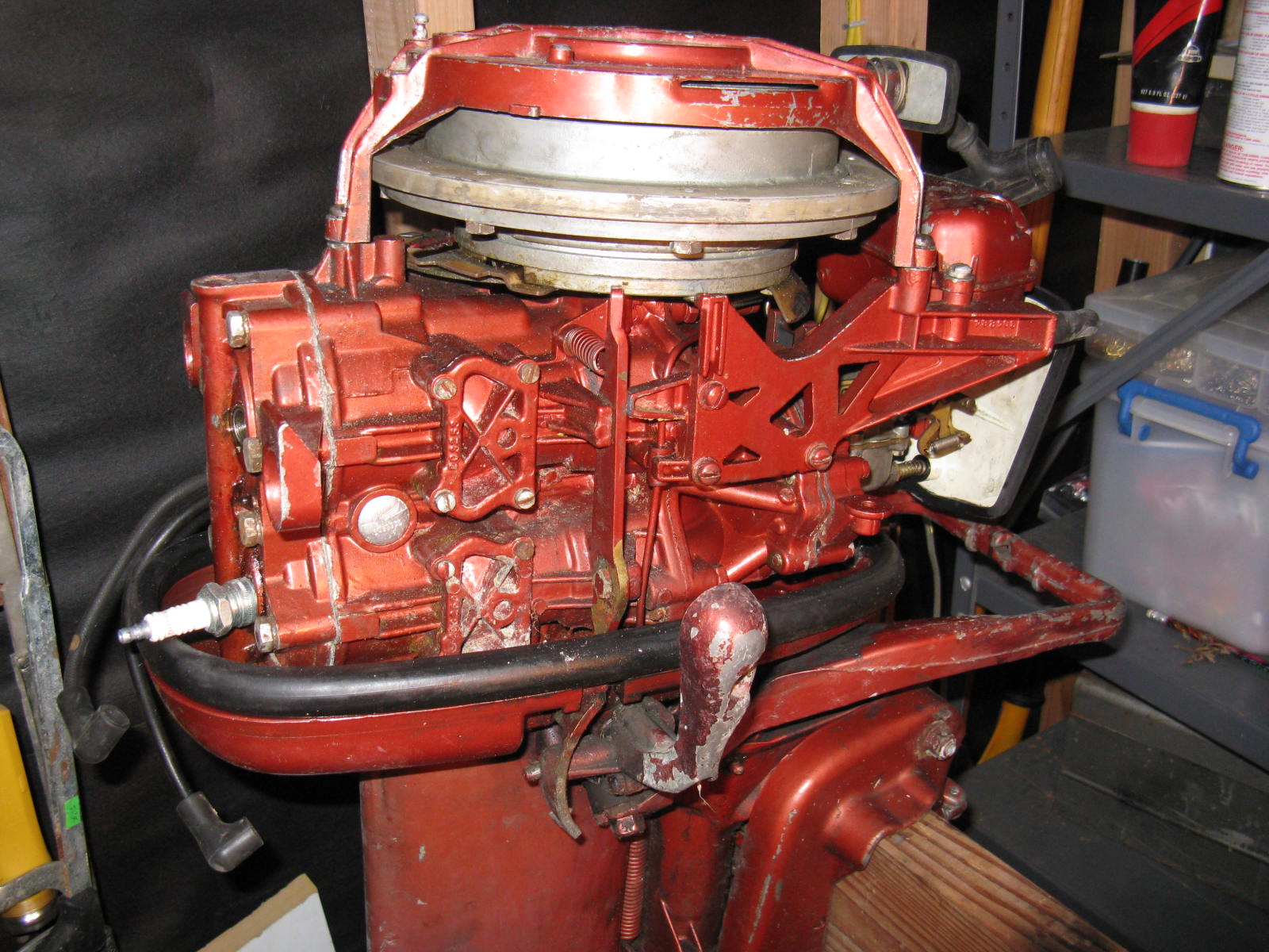

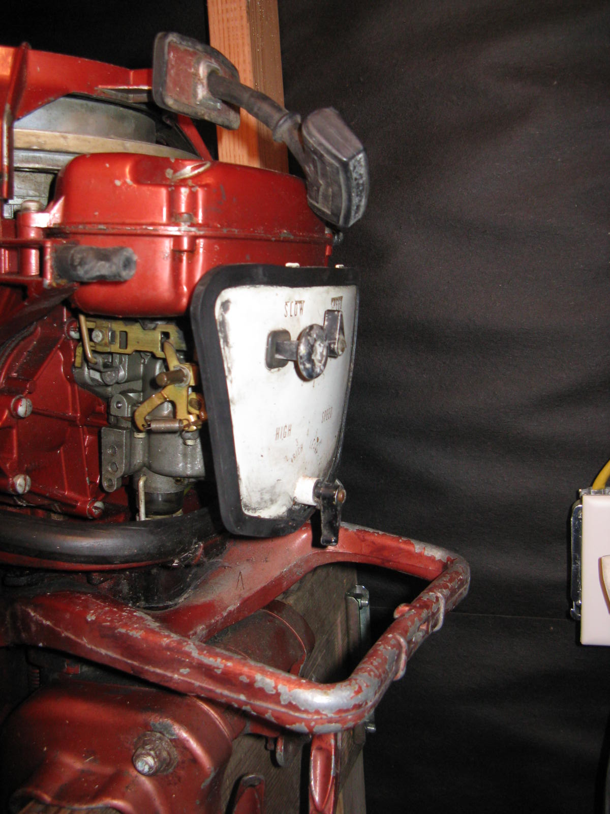

Ok, picked up a harmonic puller since that was the one tool I didn't have. I lubed up the steering a bit, but it must have some serious dried grease in there, hard to get the fitting to take much. Also drained the lower unit, and as you will see in below pic it wasn't pretty. Quite brown, milky and thick. Before I pulled the top screw, what appeared to be water or clear liquid came out, the clear liquid did have a smell to it so not sure if just water or from the ancient oil seperating? I put fresh lower unit oil in, just to keep it from corroding further until I decide what to do/get to the lower unit.
I also pulled the spark plugs and have the cylinders soaking with seafoam now as they were fairly gummy, but definitly moving well enough when I rotate the flywheel. I did hear a little rattle from the bottom cylinder when I hand turned the flywheel over, but the engine was on its back. Is that something I should be concerned about?
My plan is to check the compression this evening and then pull the flywheel for access to the ignition components.
Any thoughts on the rattle, and is the water/liquid in the lower a death sentence for the lower unit?

Re:Good first motor? 12 years 5 months ago #73675
C:\Users\Sarkis\Pictures\2013-01-23 boat\boat 006.JPG
Re:Good first motor? 12 years 5 months ago #73676
Re:Good first motor? 12 years 5 months ago #73677
C:\Users\Sarkis\Pictures\2013-01-23 boat\boat 008.JPG
C:\Users\Sarkis\Pictures\2013-01-23 boat\boat 001.JPG

Looks like a nice Engine! Should be a great platform to get used to working on an engine. I dont know about the rattle you were hearing. As for the lower unti oil, you likely will need new seals or just change the oil often. Though seals are easy to do on the Johnsons. As stated above the Cheap outboard book is a good guide on these old engines.
www.amazon.com/Cheap-Outboards-Beginners-Making-Forever/dp/1891369628/ref=sr_1_1?ie=UTF8&qid=1358960537&sr=8-1&keywords=cheap+outboard
Re:Good first motor? 12 years 5 months ago #73699
Jesse's right, that lower will need new seals. I have to do it on my '59 Fat Fifty. I keep getting water in and using the no oil and compression test showed a leak around the drive shaft seal. The rattle doesn't sound good. There really should be any "rattling" going on. The compression check should/could give a clue.
Lower unit will need to be off for this. Drain the oil, put the lower drain screw back in. Take some soapy water and put it around the upper seal area around the drive shaft and some around the prop shaft. Take a compressor with a rubber nippled blow gun or some way of sealing a blow gun tip and blow air into the upper oil fill hole and see what bubbles show up around the shafts. Mine showed bubbles around the drive shaft, the prop shaft was fine.
