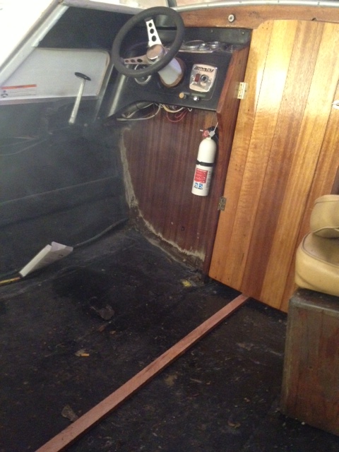

ok i just made my planks for my floor out of african mahogany and geting ready to lay it down any thoughts or hints i have never done it before and dont want to mess up i only have so much material to work with.

It's not an old floor I have rebuilt the stringers and reinforced the floor with marine grade plywood and fiber glassed over it. I was planning on running the planks vertical to allow waer to drain to the back transom. Another thought I had is to build a drop in floor so I can remove it during fishing eason (NO BLOODY FOORS!).

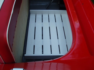

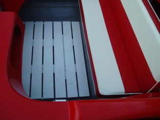

I made drop in floors for my 59 Tomahawk for both the back seat and space behind the back seat for the gas tanks, etc. They are 1x4s with a 3/4" space between the boards. Epoxy coated and painted. Very easy. Not sure I would do a solid drop in floor because the gaps do allow for water to evaporate.

i didnt think about the slip factor. with a clear coat on the floor i would need some kind of throw down mats. its things i need to think a bout because i have to build the seats and storage. tomorrow i am going to a wood shop and planing the floor planks and start my lay out on the floor and today i installed my gas gauge in the fuel. tank thanks for the thoughts

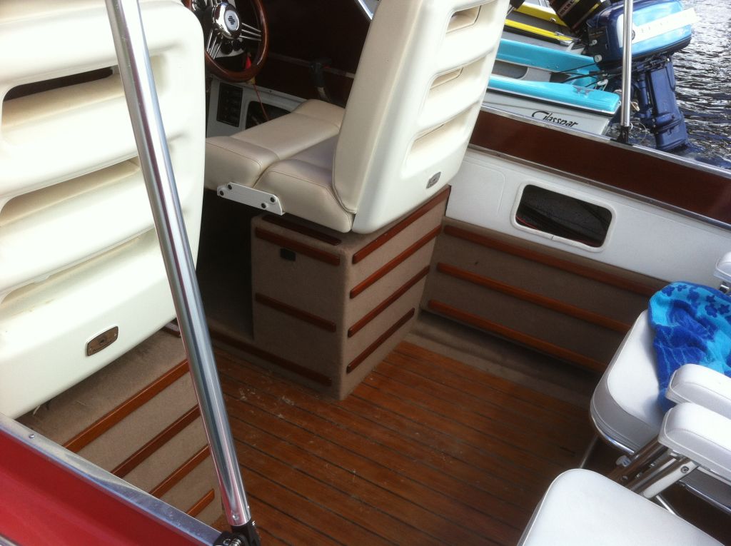

I'm anxious to see your results. I used teak and rubber plywood over Coosaboard.

i spent all day planing my planks for the floor what a pain in the ass but man they look awsome! i start the install this weekend.
so we will see how it turns out i will post pic.
