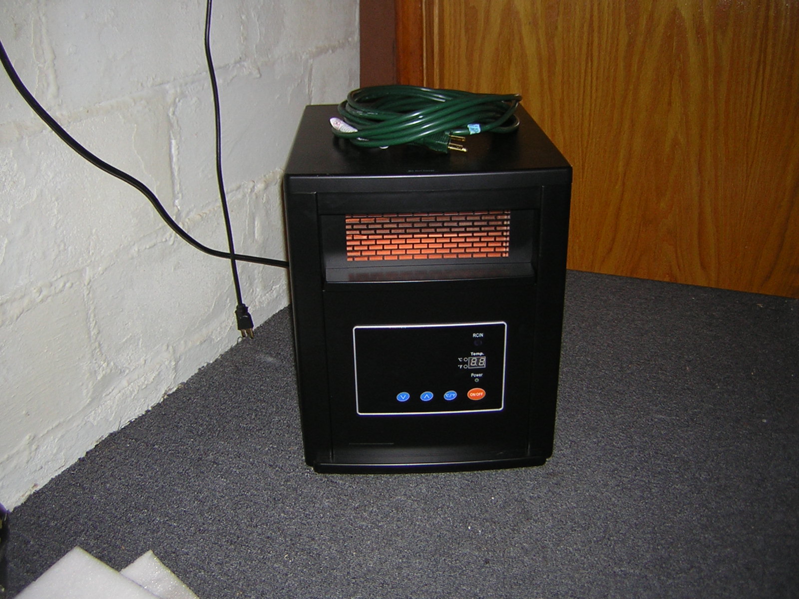

Use electric heat. Get yourself one of those newer ones that they show on the info commerials now.Do not use any propane or kerosene type in the garage if it is attached to your house.
This is the one I picked up for 80.00 new and it works great and came with a remote control. Skip.

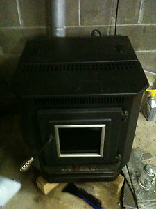

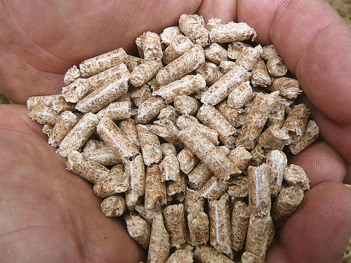

I agree if you are only on a temp basis with electric. I don't know how large your area is and how much area is open. Leave space around it. We don't like fires in our garages. I had a wood stove in mine. I loved it. I had an unlimited supply of free wood. Now I do own a wood pellet stove and I always thought it would be great for a garage. It burns air from the outside and is contained like a furnace. Load it up, light it and leave it alone. Your garage would be all snugly warm when you went back out. You can get pellets for $209.00 a ton. I can heat my house on three tons a year. They can also be bought used. Mine is aver 10 years old and I only ever had one problem with it. A new feed motor cost me around $100.00. This one is not mine but a pic off the net. This is just like mine. And a pic of the pellet fuel. On the sides and back you only need to leave around six inches. You can put your hand anywhere on the sides and top and not get burned. It has a fan built in for circulation and is vented outside. No gas or fumes come inside. These are not like a wood burner, but more like a furnace in your house. In fact you can buy them to tie into your duct work and as fireplace inserts. This is also the cheapest way to heat my home aside from free.

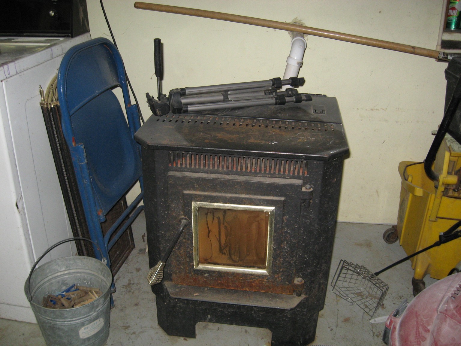

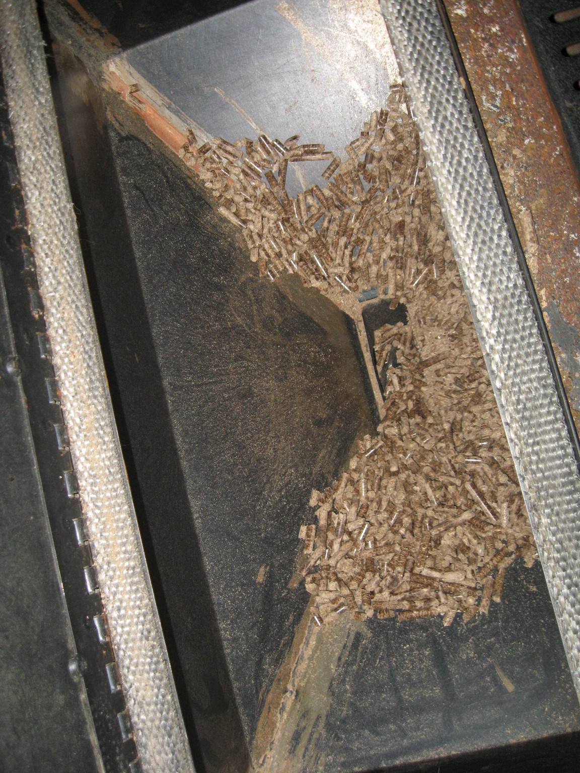

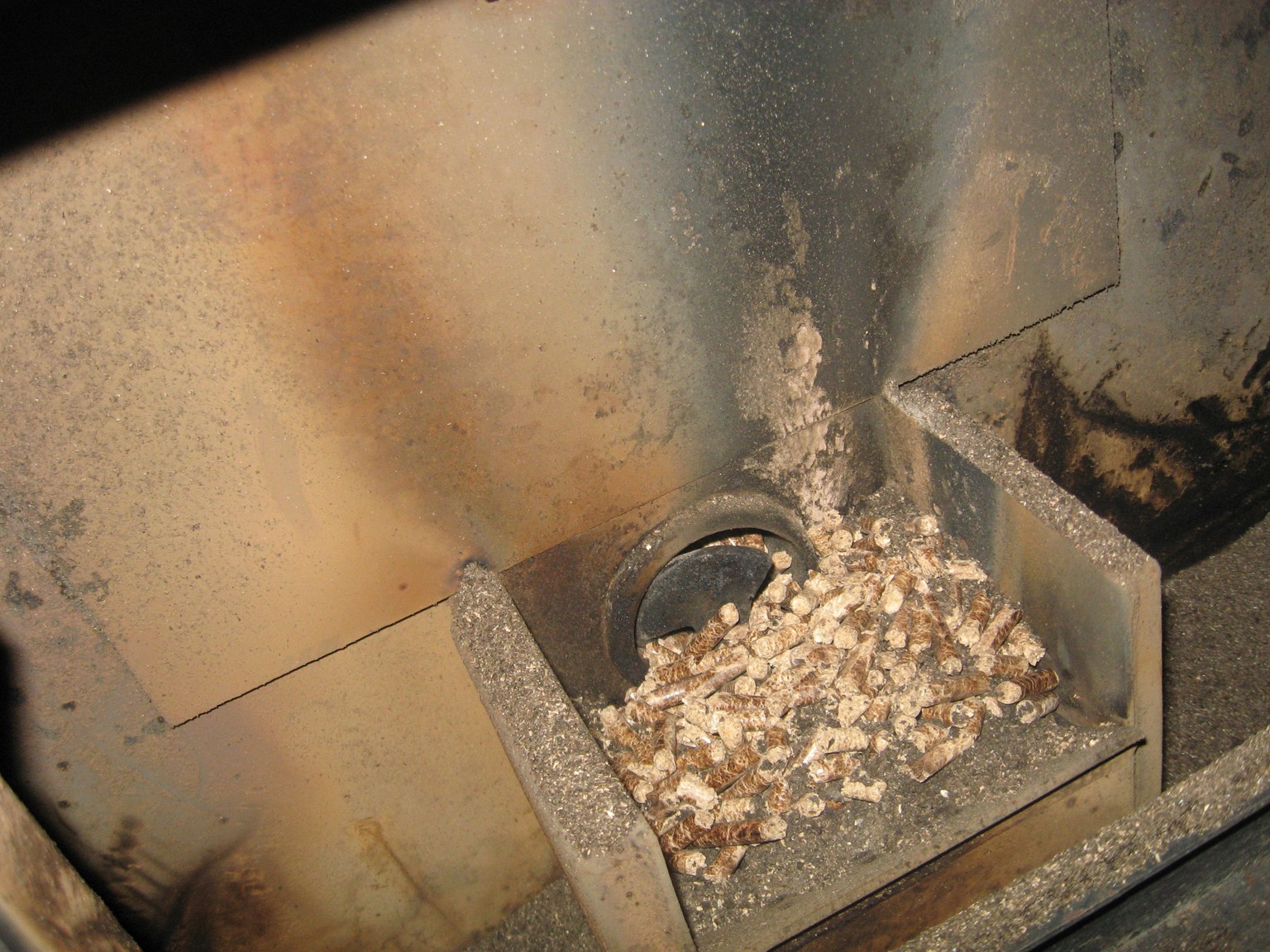

I, too use a wood pellet stove in my workshop shed. Going on the second winter with it. My only issue is the lack of thermostatic control. It has three speeds or burn rates. When it gets too warm, I just crack a window or turn off the heater for an hour or two. (I did insulate the crap out of the work space.)

My pellet stove has 9 heat settings and it can be controlled with a thermostat. But only from one heat setting to another. Mine does not self start. Many now do , but mine is getting old.

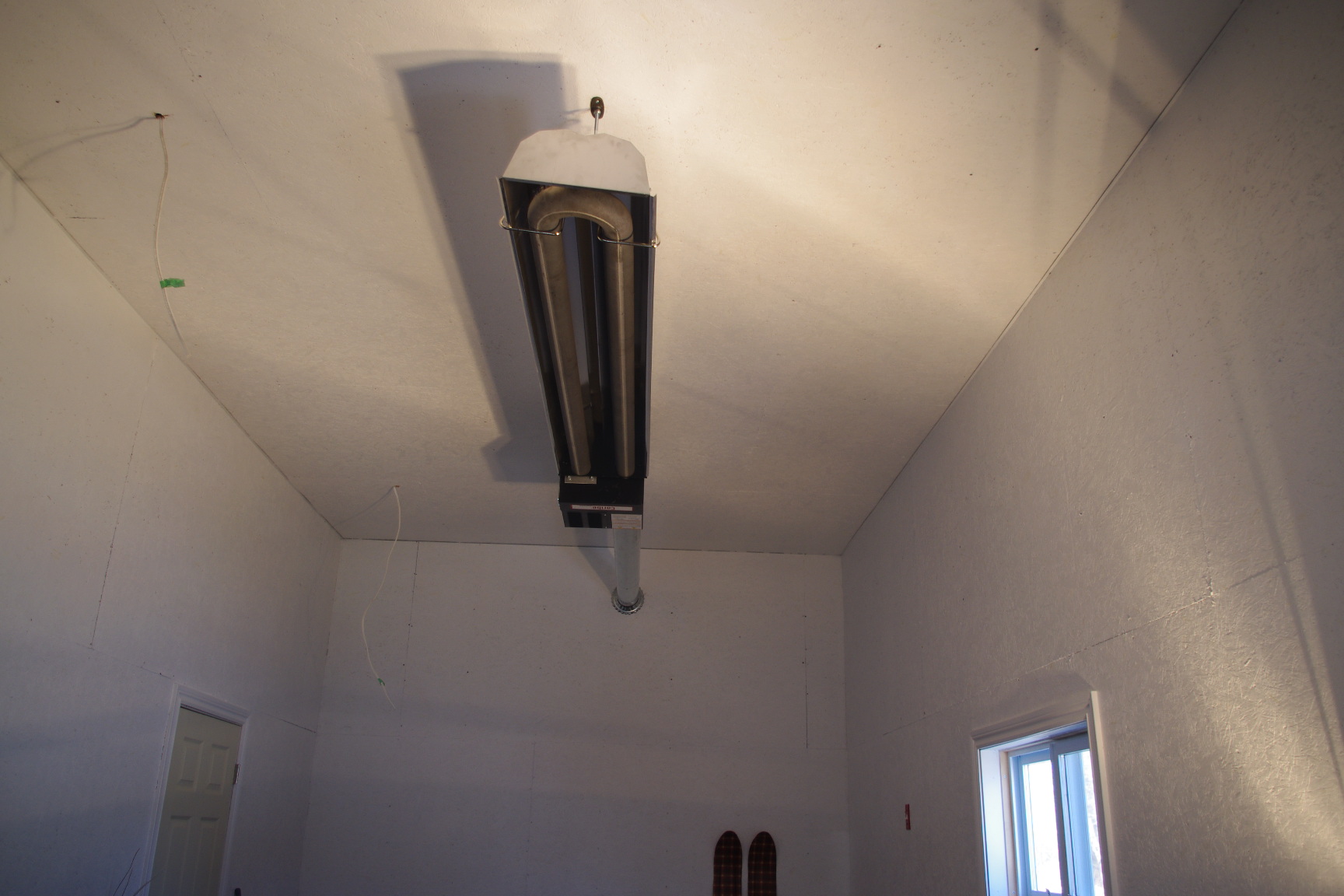

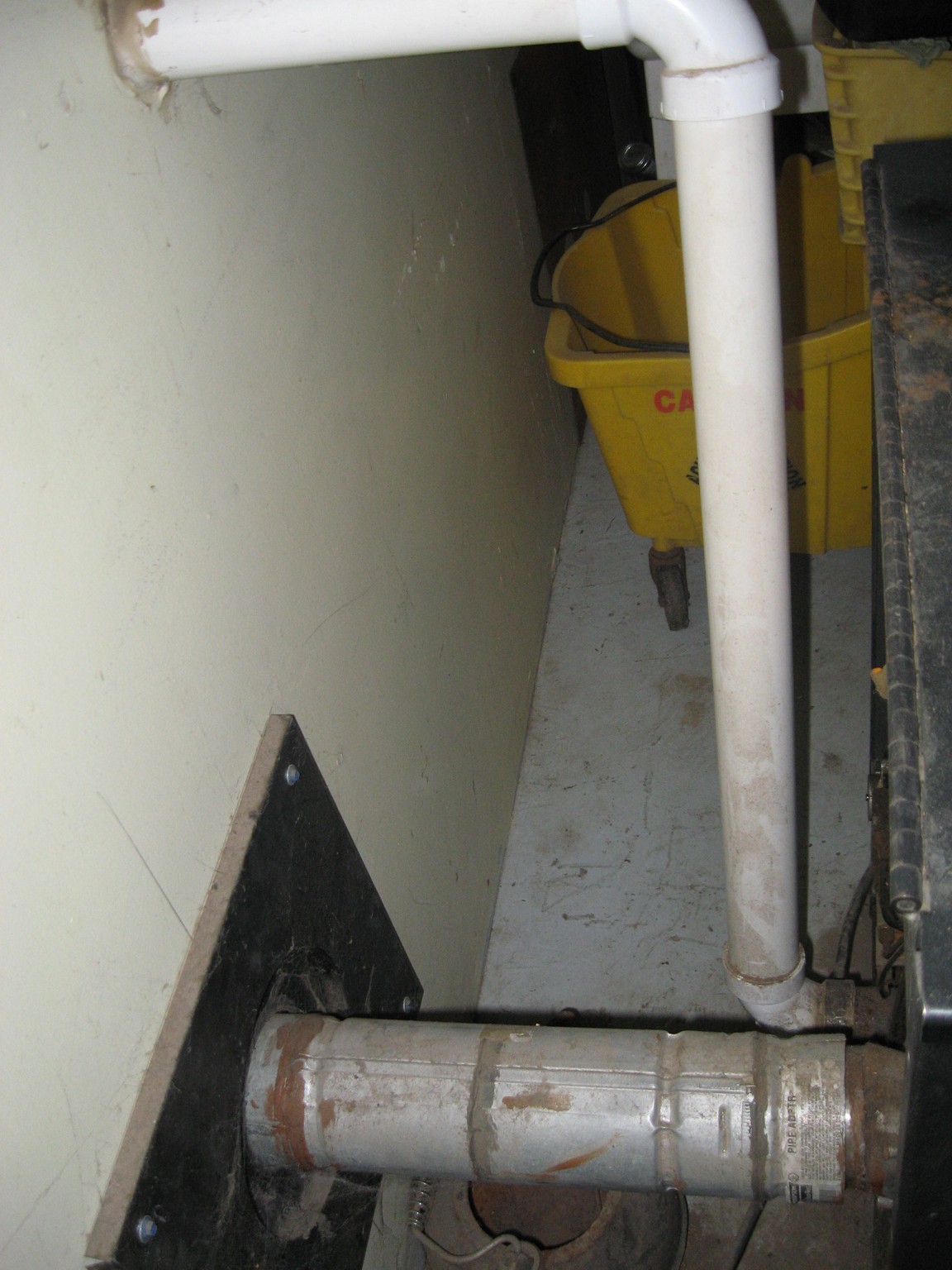

If you use Natural gas or propane as your primary heating fuel a direct vent U tube heater is about the best thing you can get. I have 2 of these Robert Gordon Caribe heaters in my garage, each is 30,000 BTU. I have 2 bays seperated by a wall and only need to keep the north bay at 12c to get 7c in the south side as long as the dividing wall door is open. I can get the temp up to 16c in the cold side within 40 min and at 81% efficiency they are fairly cheap to run (nat gas) The beauty of radiant heat is that it heats the objects in the room which then give up their heat to the room. They are fairly expensive but worth it if you want to heat the shop all the time and be very comfortable. I am in the HVAC business and was able to do the install myself which probably saved $1000.00 in labour cost. My shop is insullated to R25 in the walls and R40+ in the ceiling

Well, with 33 years in the H.V.A.C.R. trade. Just remember if you choose electric heat, be it a cheap walmart heater or a expensive infrared copper tube heated made by the Amish ALL electric heaters are the same efficiency 3.4 BTU / Watt. I go with the $30 walmart 1500W heater. The propane / Nat. gas ceramic heaters are cool, but do add to the humidity, and may have mold problems. The same with any ventless gas heaters. My choice would be a downflow, 80% forced air furnace. Flue is vented to the outdoors, garages usually have enough air leakage to provide for combustion air. Downflow to set on a plenum box and tap 2 collars with adjustable elbows in the sides for air distribution, filter on top. could even run on a 4.5 gal propane bottle sitting next to it. Just run the t-stat wire to the far side of the room.

He He. I can grab the vent for my pellet stove on the outside of the house with my bare hands. Like I said, all outside air for combustion. Inside you can sit on the thing, just don't touch the immediate front around the door. I can add corn to it too. If you get last years feed corn you can get it at a very low price. When I get corn I put it in a sealed barrel and use a scoop. This one is mine. I'm cleaning the basement and it is not on. The vent and air intake. You can use plastic pipe for the intake. It is set about 2 feet above the ground due to snow. My heat exchanger is cast iron.
