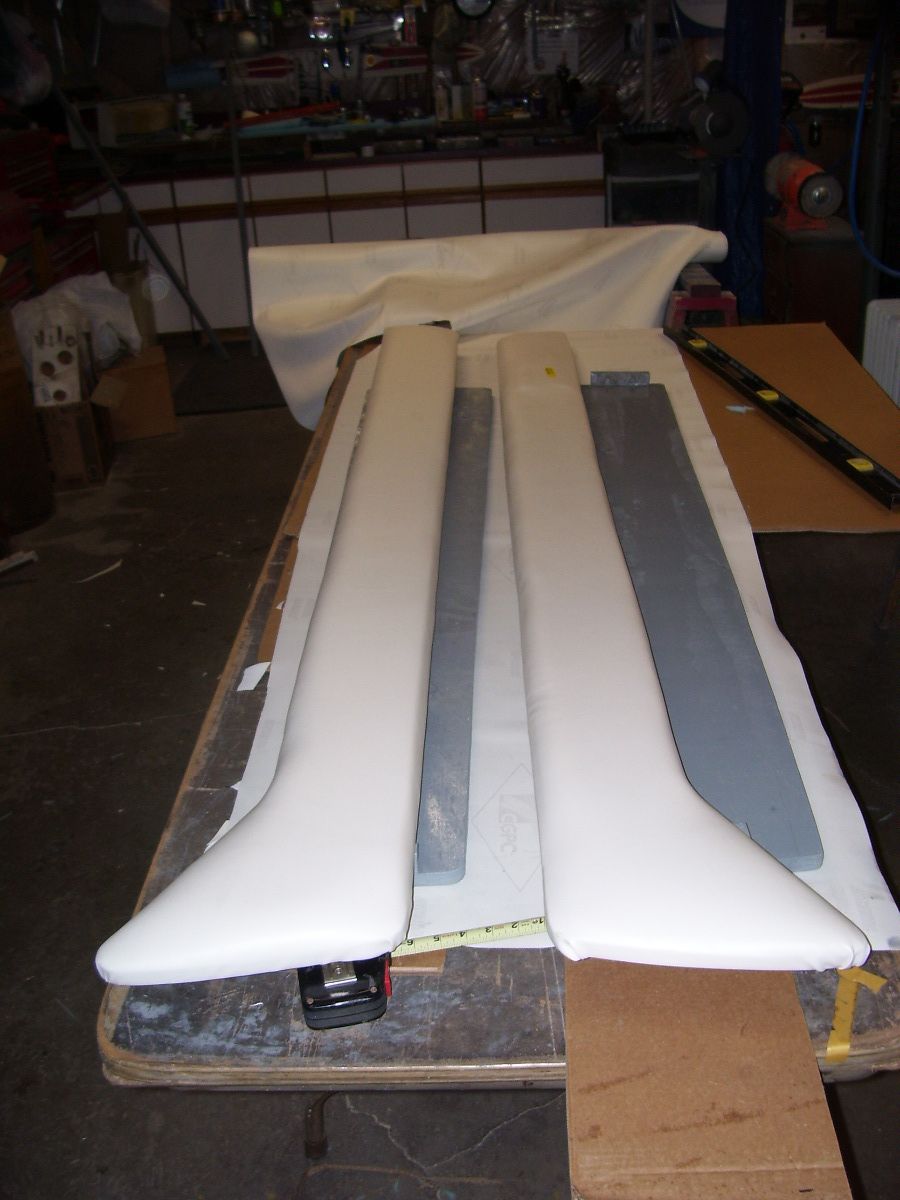

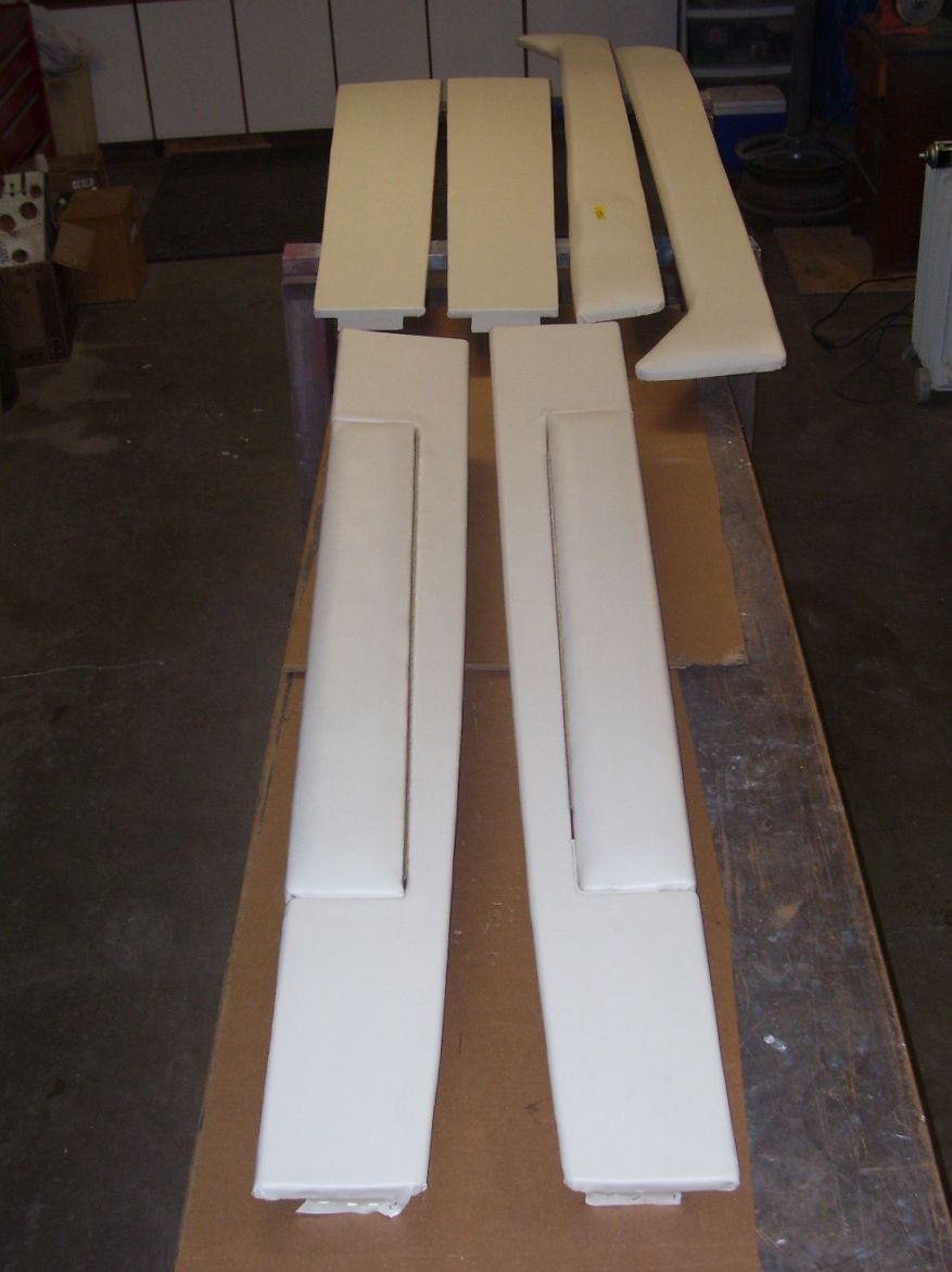

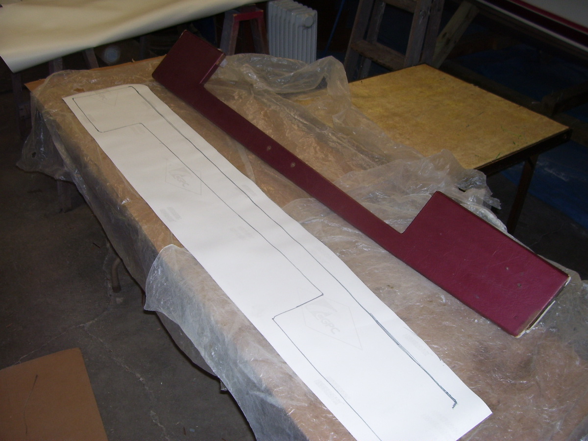

I’ve been working the last several days getting all of the interior upholstery work completed. The boat had been pretty much stripped out when I got it so all the missing crash rail and dash pad had to be designed from scratch, cardboard patterns of everything were done and the permanent patterns were cut from ¾ inch plywood. I painted all the new patterns with high quality bilge paint so hopefully no rot down the road. One inch foam pad was added useing 3M Vinyl Spray Glue behind the vinyl so the finished product has a really nice soft touch. The face boards on the side storage cabinets were completely rotted out however were good enough to make new patterns from them. Fortunately I was able to obtain an exact vinyl color match to the seats which had be redone just the summer before I bought the boat so that was a good thing for sure. The only thing left to do with the interior except for selecting the flooring material is to dial in the crash rail. I’ve decided to add a six foot long piece of ¼ inch solid back polished stainless steel down the center of each of then to set them off and give them a little Bling! Will also be doing the same to the dash pad so it all ties in and looks like it belongs. Of course this is not the way it was done at the factory when she was built but I think it will look as good if not better than factory original.
