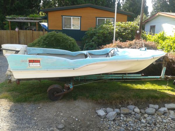

Thanks, I didn't think about a picture earlier so I'm attaching the only one that is posted with the ad.

Boat is cool. Trailer is strangely interesting. suspention is kind of like a swing fork rear on a old MX bike.
