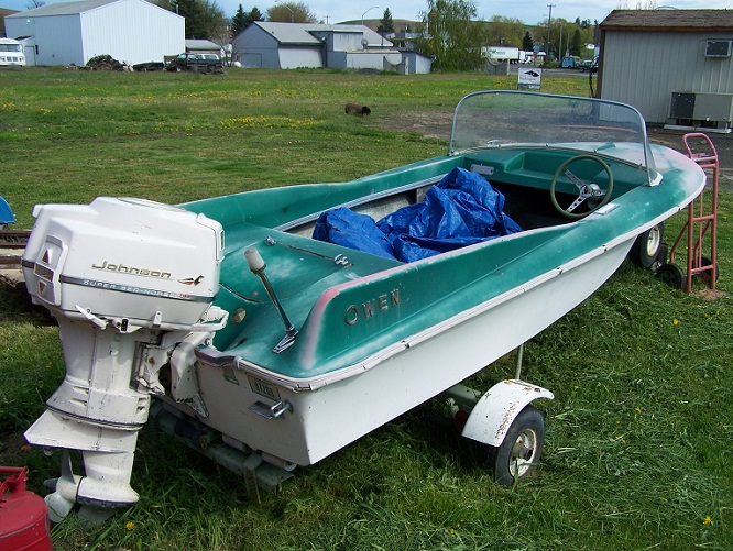

Out of the Owens line?

Yes, I saw the Owen also. The fins are shorter and thinner. And the bow is much fuller. Mine almost looks like an old bath tub at the stem. I have yet to see anything with the dash board (spoilers?.)I gotta admit this is fun having like minded folks offering tips and advice.

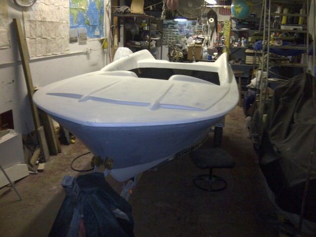

I picked up the boat in Carolina,I'll eventually take it back there from Fl. The thing that I find that is different from every other boat is the early corvette style dash board.
I have it upside down right now while I am working on the bottom. Lots of fill and fair on the bottom. It was very lightly built so I laminated a carling under the deck to renforce the bow deck and 6 layers of glass behind the dash board to strengthen that. I am almost ready to turn it over and start work on the top. Pic's to follow. Thanks for the tip I'll start searching that direction.

I've made some real progress. I flipped in over and started with 100 but it was so bad I had to go to 80. I put 2 coats of awlgrip primer and then flipped it right side up. I mounted the engine and made sure all my controls we're going to work. Then I went on the deck, after I got 2 coats of prime on the deck The fins were really wavie so I decided to fair them out with Awlfair. While doing that I found a big void half way down the starboard side fin. I ground all that out. Now fairing everything back in. I was going to do the topsides in snow white and the deck in red. But everyone has said red would be sooo hot. I've decided to go with antique "Hatteras" white.

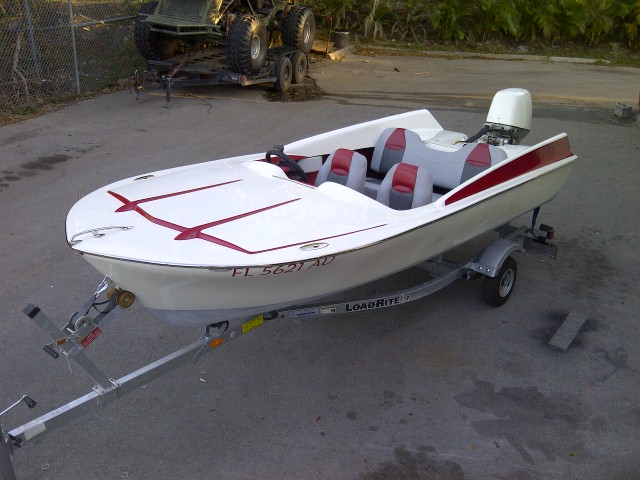

After fighting the urge to luanch and run the boat without finishing everything. I finally finished the paint, interior and engine rigged. I ran the boat thrugh Port Everglades and around the Dania Cut off canal. With the 30 Honda and four adults it will make 25kts flat out smooth water. That's all I ever wanted. Got lots of looks and positive comments. Even the FL marine patrol wanted to ask me about it. Still haven't determined the make but at this point who cares! Now I am working on the windshield and top.

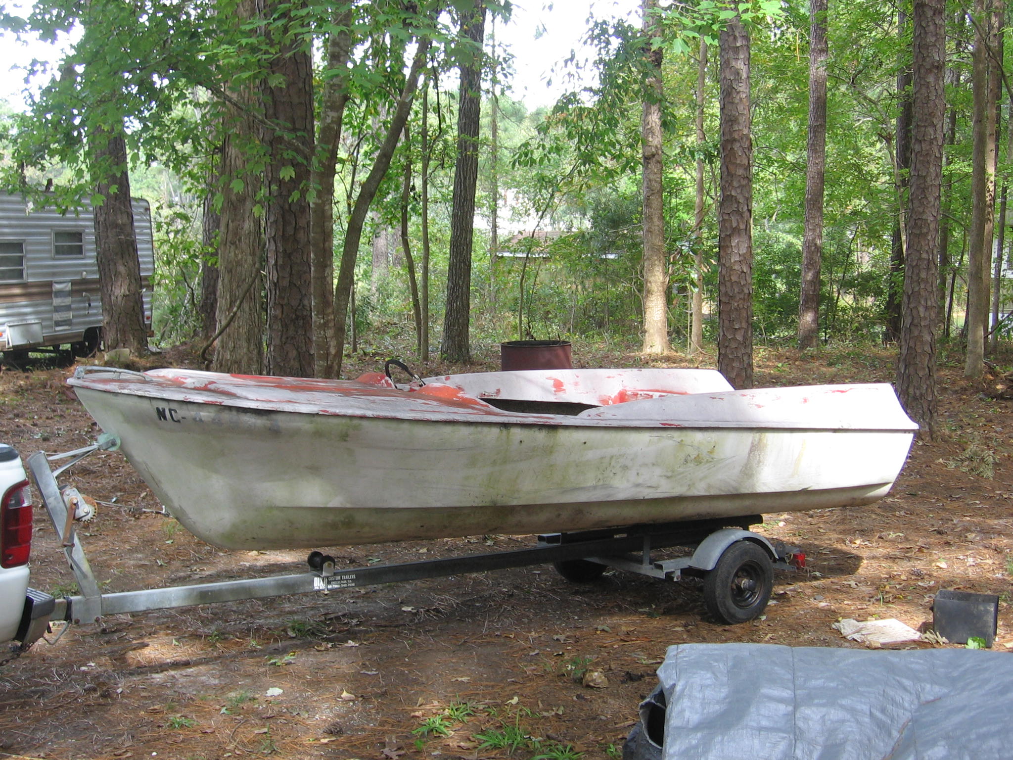

FYI, the CAPE FEAR MUSEUM has a VERY similar boat, that was donated to them. - A "NC-built knock-off" of an Aristocraft if I remember correctly.

Great job on the boat, she looks beautiful!!!!!!
Re:New boat?? 12 years 2 months ago #76154
Beautiful job! Hope it performs as good as it looks!
