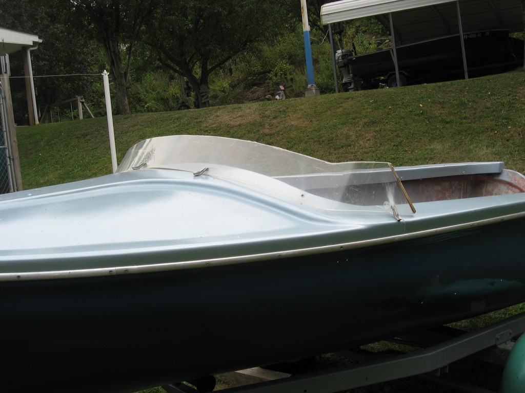

My Winner has no stringers. My MFG has a wooden keel inside but no stringers built in. The deck I have in mine is not the way it came.
Re:Read lots of topics on wooden stringers 12 years 6 months ago #72144
Hey Frog; No, mine is short. Still looking forward to the 'big auction in Wichita Falls' Hoping to find a merc to fix up. They run at higher RPM's. Fully loaded (including fishing gear) I am 693# gross. the 40 pushes good but a Merc 50 hp...:-) Robert, You added a deck to yours? Love the windshield you cut down, everytime I see a pic of it makes me realise, your only tethered by your lack of imagination.
Re:Read lots of topics on wooden stringers 12 years 6 months ago #72147
I added a deck to my MFG. I use it for fishing and have a basic 3/4 inch plywood floor with a couple pedestal seats installed. Two partial stringers attached to the floor held on by two lag screws into the inner keel. I love that cut down windshield. It changes the looks. I like it without but I know I'll have trouble keeping my dog off the front of the boat. She is very athletic.
