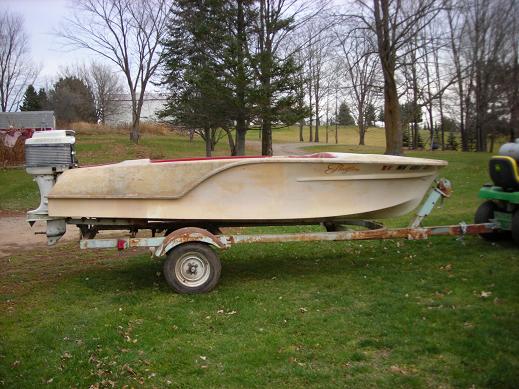

Hey guys, I got this 1958 fleetform about 3 weeks ago, and have been on iboats. I have the seats, stringers, and mechanical stuff out. I also have some of the inside sanded. How would you guys suggest I sand the gel coat off? I'm 13 by the way.

Cpenrose, welcome aboard. Pics would be such a good help. Is you r gel bad? Are you sure it won't clean up. Sanding off the gel coat is a big job, believe me I've done it.

Good time to get your feet wet and you are at the right site for all the help you need. Why are you sanding the gelcoat off? If you want to change color you just need to get all the old wax an' stuff off, if it's cracked there are high build primer paints that will fill those in so you can get a mirror finish.
Pictures are good for a lot of us old people but there is a wealth of information here for you to tap into...ask away.

Sorry I got all messed up, the picture didn't load, so I'll try again... The gel is cracked all over in a billion peices.

Re: 1958 Fleetform Commodore 14 12 years 7 months ago #72054
cpenrose,
WELCOME ABOARD.
IF it was me, I would look for a "self-leveling" epoxy paint that will seep into & fill small surface imperfections, after lightly sanding the current finish relatively smooth.
(I would go no "finer" than 100 grit wet & dry sandpaper.)
Then I would sand that finish smooth, wipe-down with the proper wiping liquid (check out the label on the paint container.) and re-coat the epoxy paint with a finish coat.
Re: 1958 Fleetform Commodore 14 12 years 7 months ago #72063
It's even worse than that, especially on the white. I don't think it's salvagable .
Re:1958 Fleetform Commodore 14 12 years 7 months ago #72069
cpenrose, welcome to the site. You have a boat there that many members here really like and have restored many of them. It is nice to see a young person getting into this hobby. From the looks of your pics it looks like your boat has been well used. It looks like your hull is going to require alot of work to get it back to a useable condition. There have been alot worse looking boats here and most of them have been returned to usable condition. It will all depend on how far you want to go on it.the easyer way is to do what satx has outlined. If you read through some of the forums you will be able to see what other people have done to there projects. It will be alot of work but in the end it is real rewarding when people look at it and say you have done a great job on it. And don,t worry about not knowing about how to do everything. There is a vast amount of smarts here on the site to get you through any problems you may encounter. Skip
Re:1958 Fleetform Commodore 14 12 years 7 months ago #72070
IF YOU DON'T SAND OR GRIND OUT those gel coat cracks, they will only re-appear. ron

That's why I've decided that I'm going to remove the gelcoat. Then I'll use an epoxy primer then paint. Am I correct?

cpenrose,
BEFORE I did anything else, I would try sanding the hull throughly all over, washing it down throughly with a scrub-brush/TSP/warm water, coating the hull with trowled on thickened (to whipped cream consistency) slow-setting epoxy, then sand that smooth and paint as I suggested.
I may be wrong but I really see no percentage in grinding down the hull until the cracks are gone as:
1. that will likely weaken the entire hull significantly,
2. cause a great deal of PROBABLY needless labor
and
3. epoxy, properly thickened, will fill the cracks and is stronger by weight than steel.
NOTE: I suspect that "frog" is correct that trying to grind-out the cracks is a waste of time/effort.- IF the epoxy "whipped cream", epoxy primer & paint treatment doesn't work, I doubt if anything else will be effective.
just my opinion, satx

You have the same problem My Winner did and you will have to get that off the fiberglass. There is no way to cover that up. Just remember it is harder than the glass and when you hit the glass it can be holed quickly. It can also be repaired. Take your time and go easy. It will take alot of time and do use a good respirator. It can be done. I did one in the last two years.
