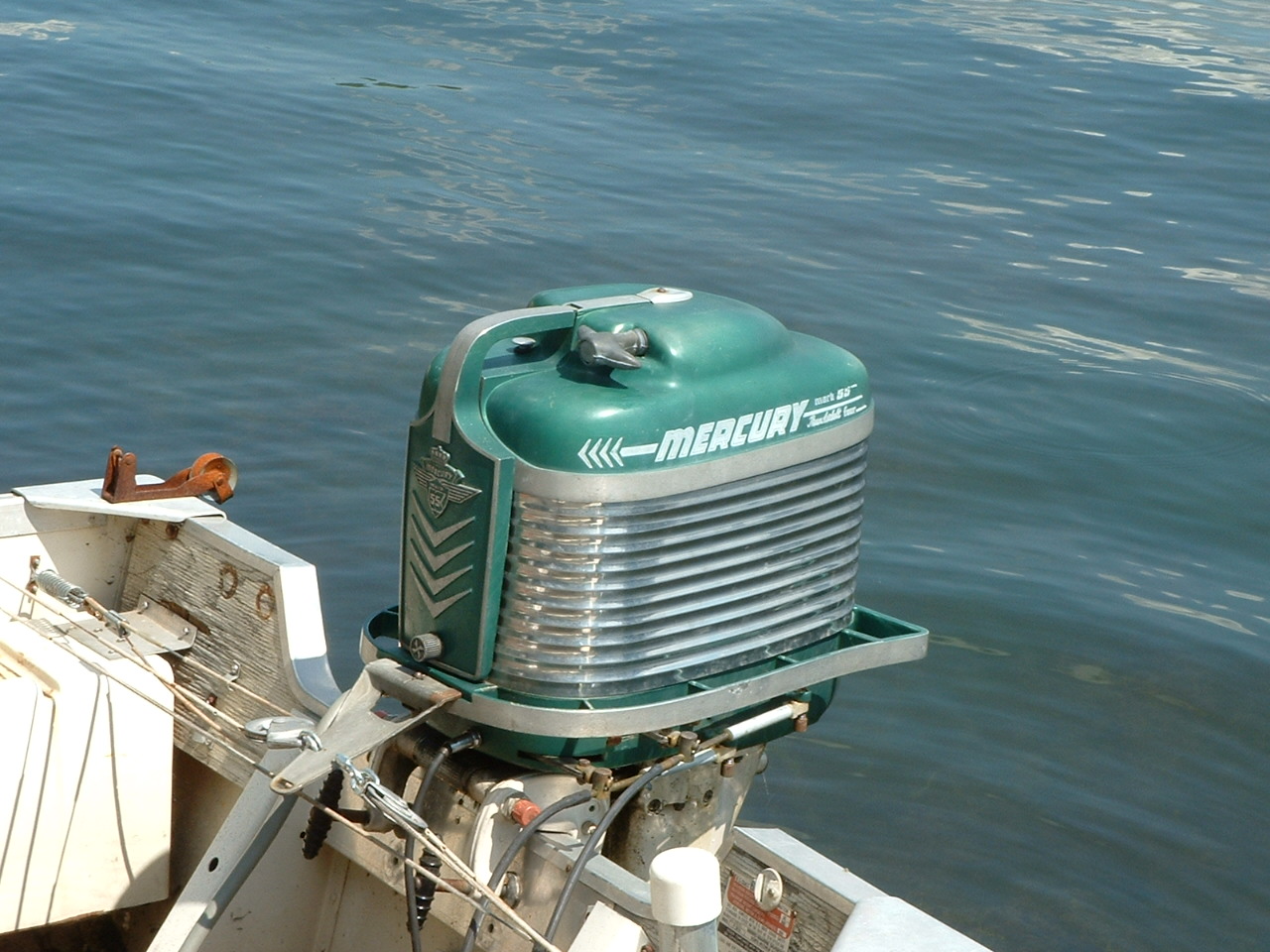

Ditto:
Re:Replacing lower gear oil... 12 years 5 months ago #71963
All Dunn II. I learned on a Merc MK55
Check and change lube each season.
I found a busted lower unit. Because I didn't change lower unit oil in the fall. Oil is cheaper that a lower unit!
