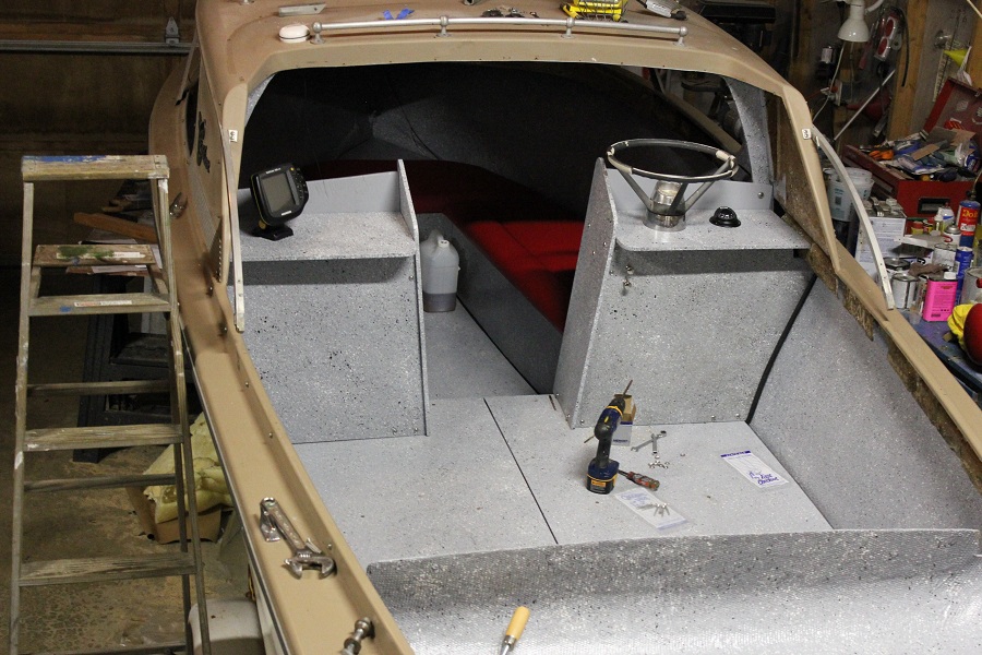

I am currently restoring a 1964 Crestliner Explorer Imperial. I'd sure like to see some pictures of your boat!
