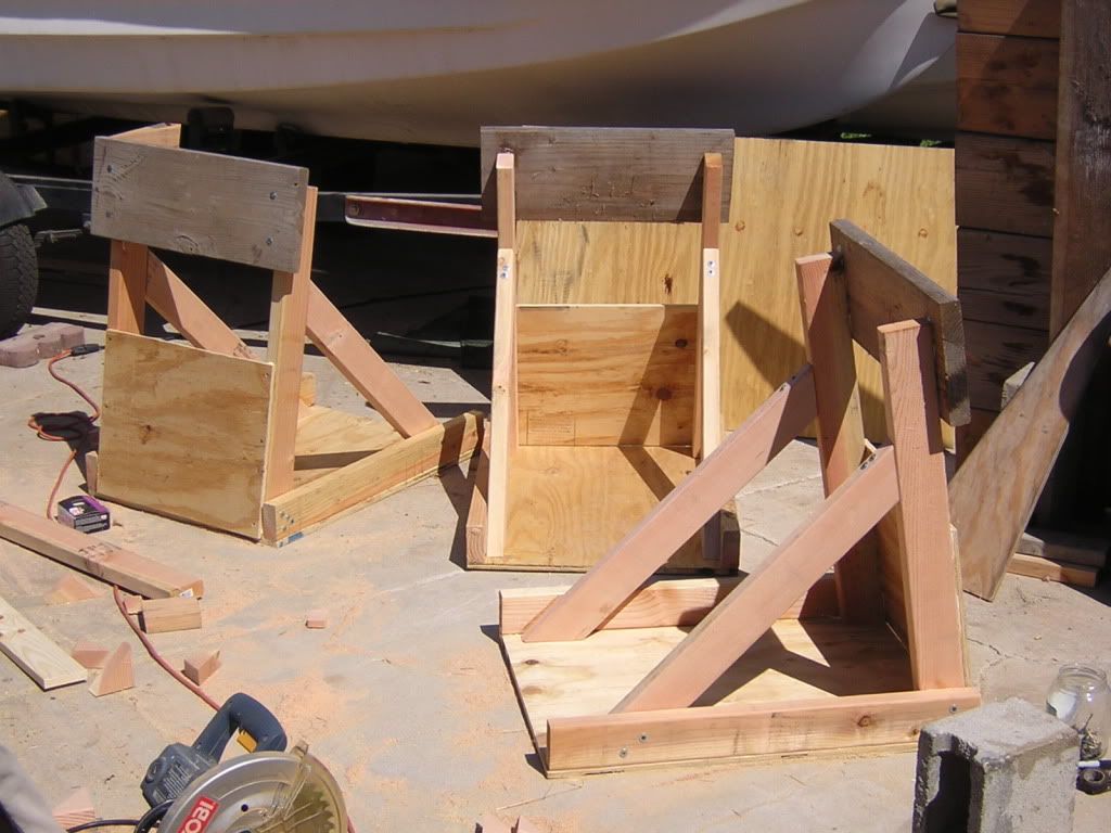

Here's a set of plans that was passed around several years ago Bill, I've seen several built with minor variations;
I did add some boards across the bottom in the front on mine, to set the battery and gas tank on when test running.
Re:Outboard Motor Stand Plans 13 years 8 months ago #70800
Thanks for the pictures and plan! Would both designs hold a 60hp engine? I'm not certain how much it weighs, but it takes two guys to move it.

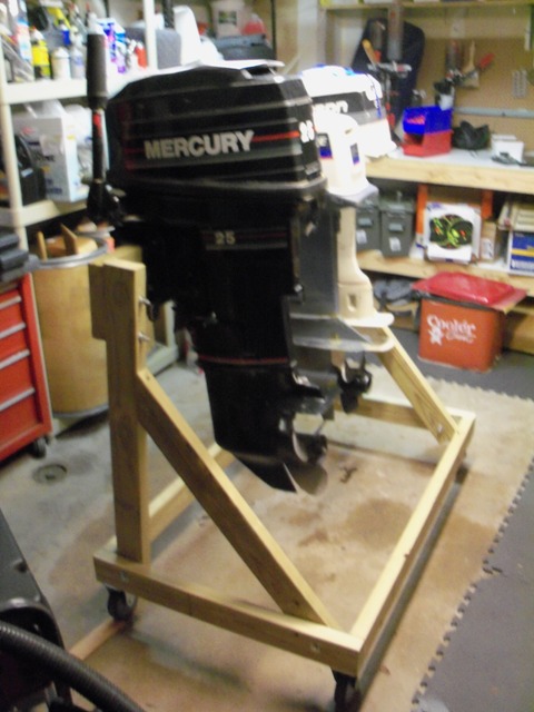

Re:Outboard Motor Stand Plans 13 years 8 months ago #70801
The one below holds a 1960 Evinrude 75 HP motor:
