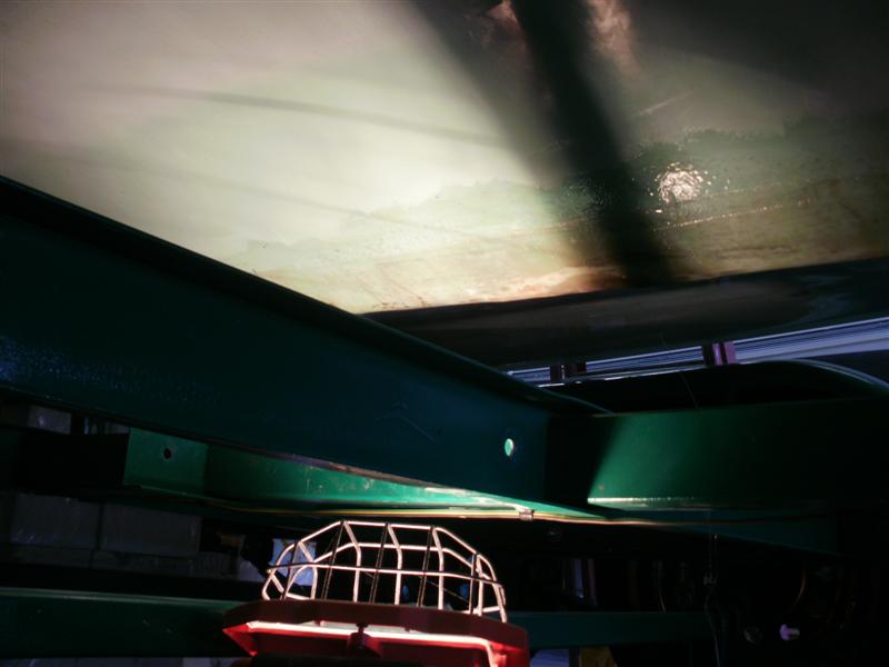

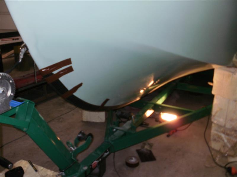

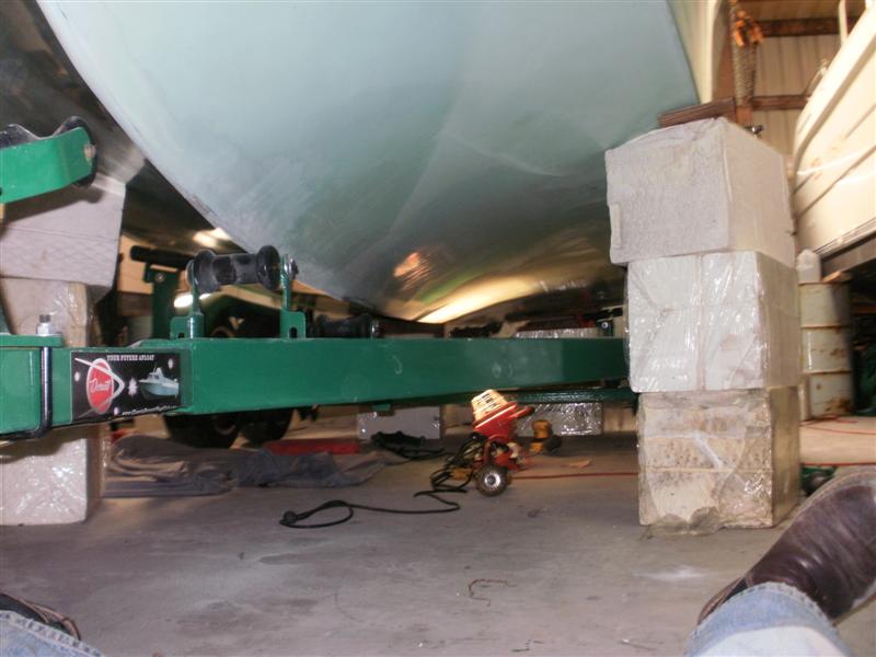

I had the same problem with my San Juan and I jacked the boat up and put it on styrofoam blocks. Sanded the worn spot down a bit and layed some resin over it then a few strips of Fiberglass cloth then more resin and a little bit wider piece of cloth. Let it kick real good and repeated the process. When it was hard I sanded the edges and you can never see it ? My worn spot was in the middle of the Keel . For beaching I added a keel guard to the bow section.

Would not let me edit to add a picture - so I'll try it this way? If you don't see another picture I guess it's broke ??
