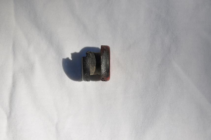

O.K.,...I have some measurements for you on this Seafair Grommet.
I will use my picture for reference:
1.) The center hole is 7/16"
2.) The length of the grommet (from edge to edge) is 3/4"
3.) The "gap" in the center is 5/16" and the DEPTH of that gap or slot is 3/16"
I hope that is clear enough Skip. If you think you have any grommets this size, or close to that size I can send you a check or money order for them Sir. ;) Let me know what you think and THANK YOU for your offer of the help.

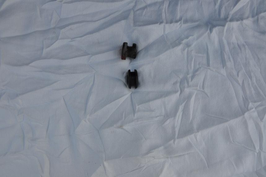

GOOD NEWS for all Glasspar Seafair Sedan Owners that have the side "scuppers" on their boats! My friend Glen Steinberg was able to find a replacement rubber grommet from "McMaster-Carr" that fits very well! The PART NUMBER on this rubber grommet is: #9307K63.
Here are some photos of the original and replacement grommet from "McMaster-Carr": Original is on TOP

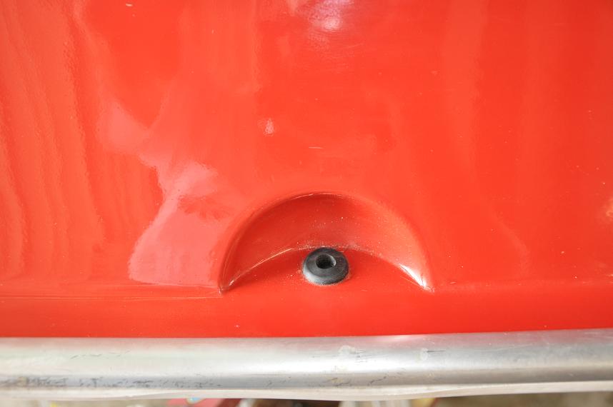

Here is a photo of the scupper on our 1960 Seafair Sedan with the new "McMaster-Carr" Rubber Grommet in place. The original grommet is a little wider and somewhat deeper in the middle but still fit well.
