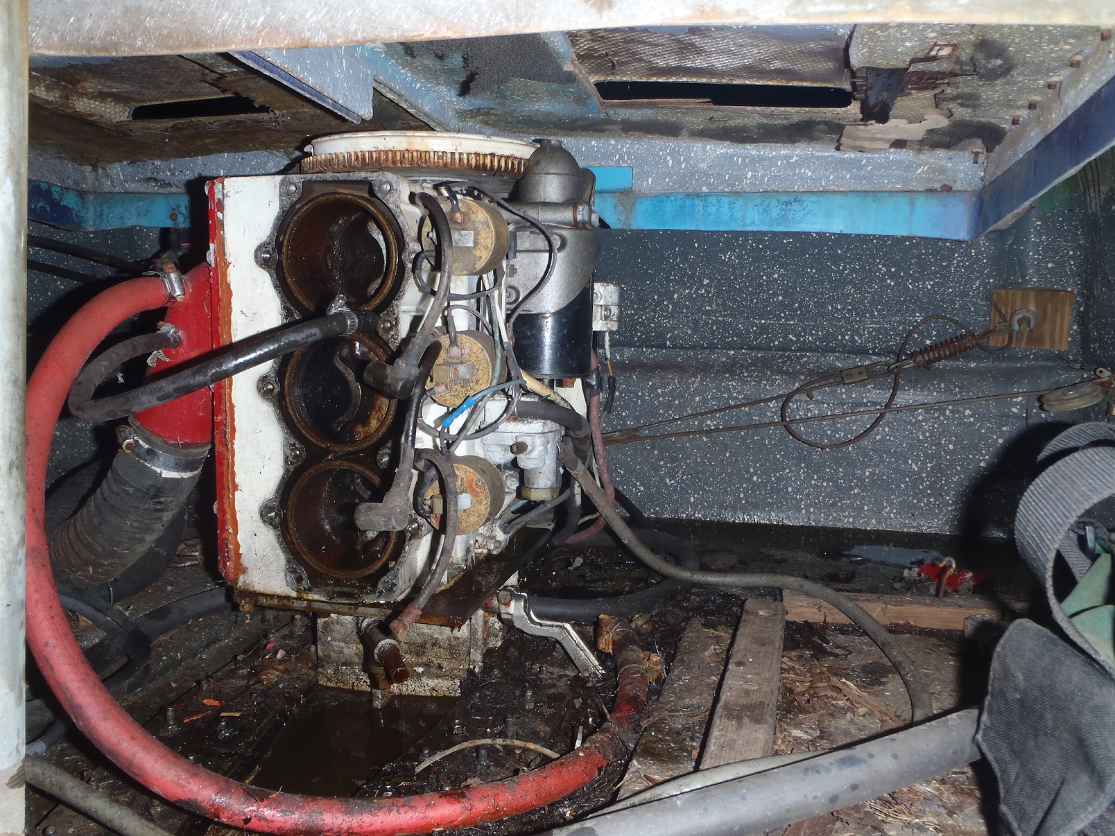

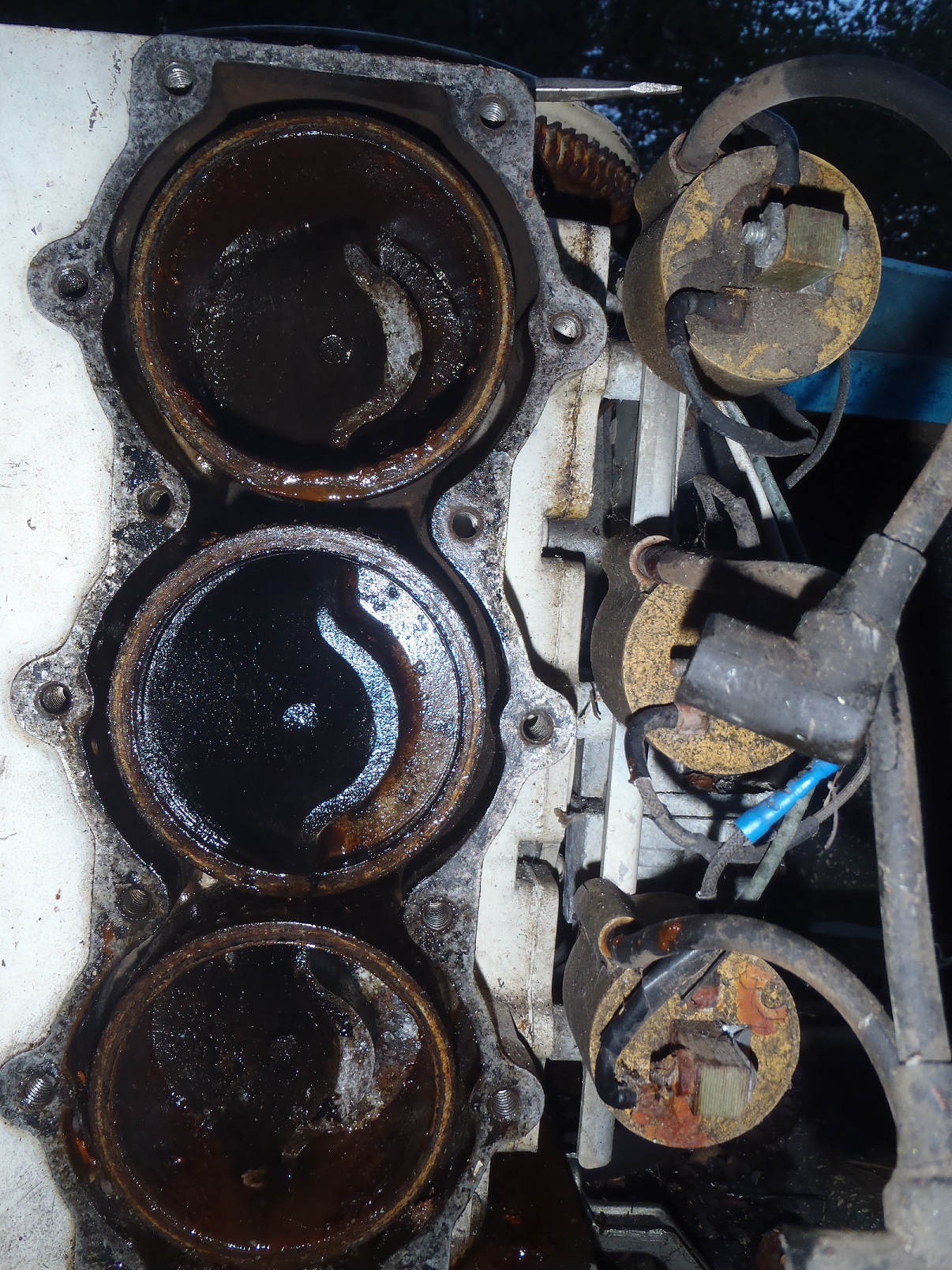

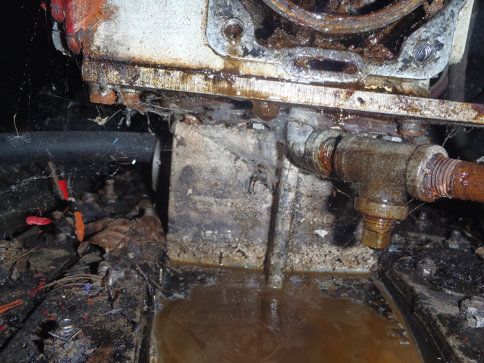

Well Update on the engine... It seems to be Toast... 2 of the 3 cylinders are all rusty inside and some one has been pounding on them at some point with something hard.. Before me.( I used a pice of wood and dead blow hammer to see if they would move at all.. may be the wrong thing to do but it obviously needs a rebuild anyhow. May have been run that way and run by a previous owner.. but I dont know.. I took the head off and this is what I found..
