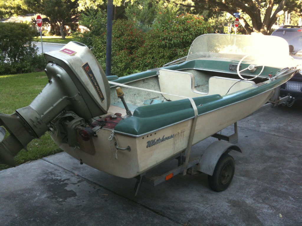

New member here. Today I picked-up a 1962 Whitehouse, what looks like a Polynesian. This is a barn find that has been sitting for over forty years in a garage. Everything is complete and solid. Even has the original key.
She needs a good cleaning, seats recovered, mechanical attention, and a few other cosmetics. Original bimini top too. 40HP Evinrude Lark is in excellent condition--I'll be changing the lower gear oil, plugs, fuel lines, checking wiring, and then firing her up with 24:1.
Did these have hull numbers? It's currently non-titled, but in Texas when transferring ownership, boat the boat and motor will get titles.

Do the impeller before you even turn it over. Last thing you want is an impeller piece stuck in the power head somewhere.
That thing should fly with a 40HP.
