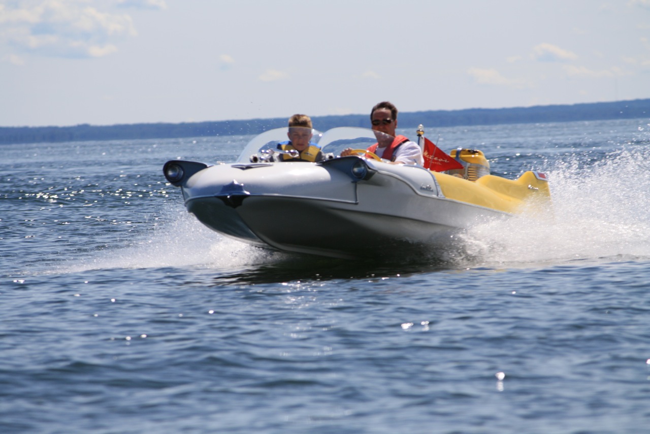

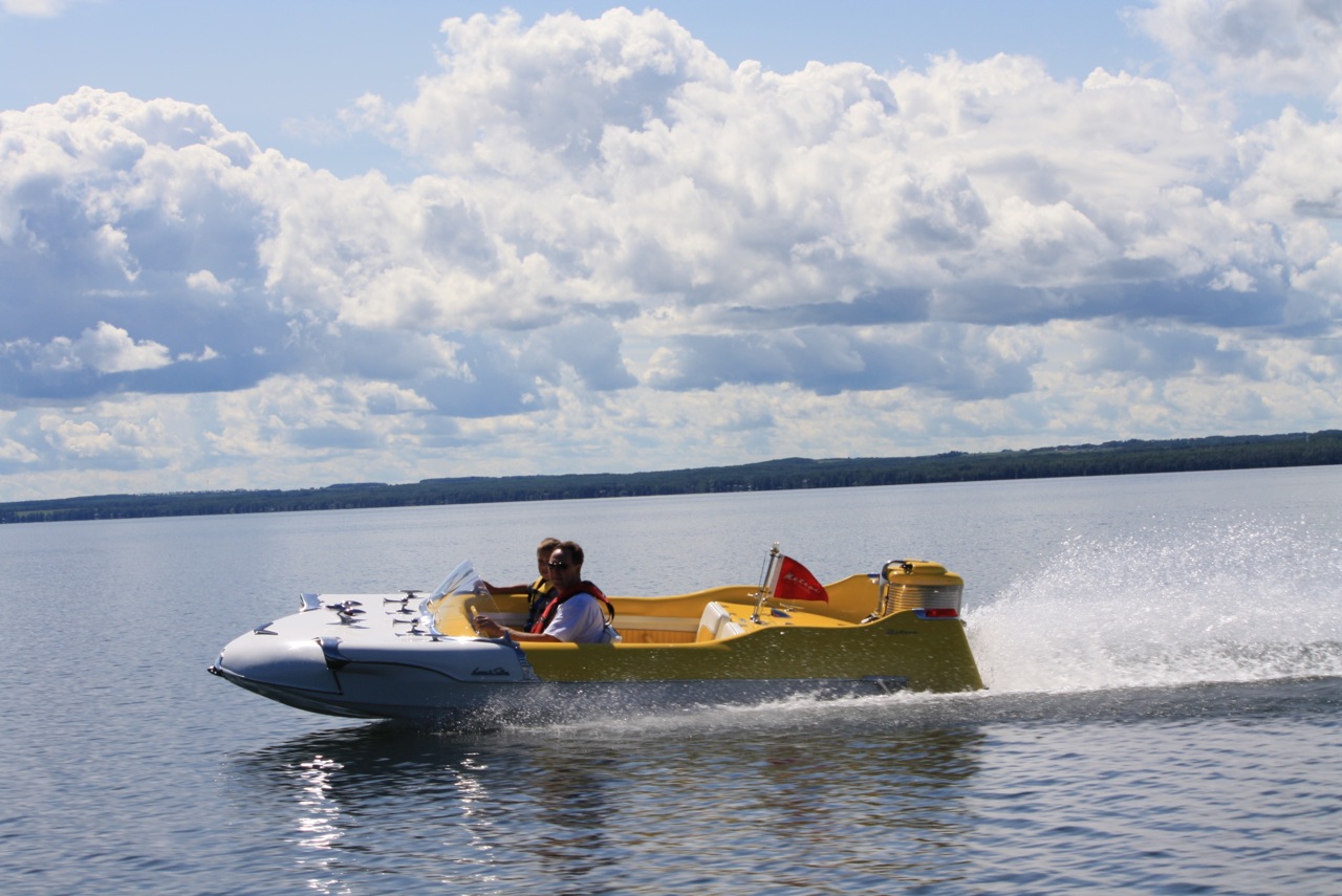

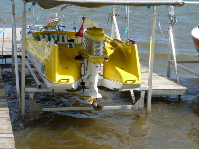

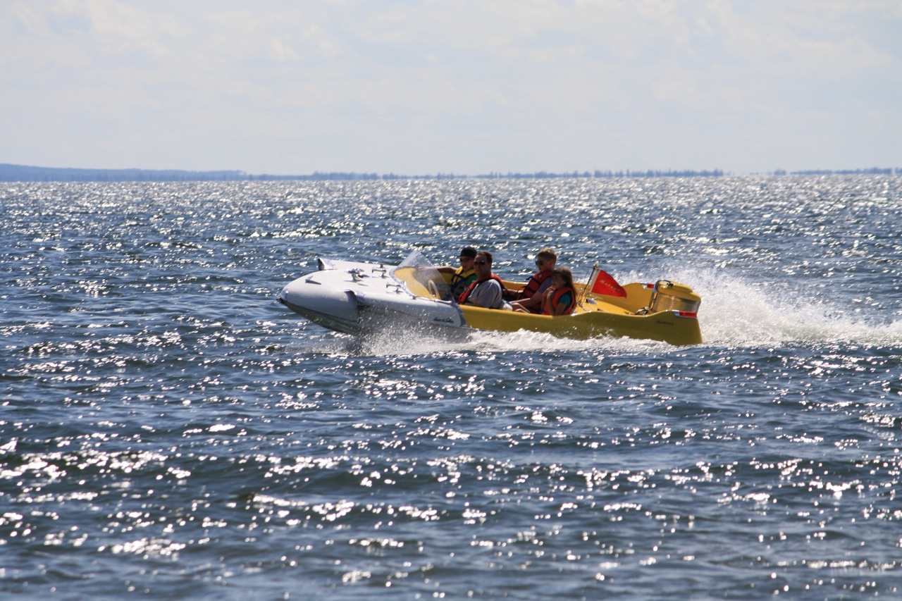

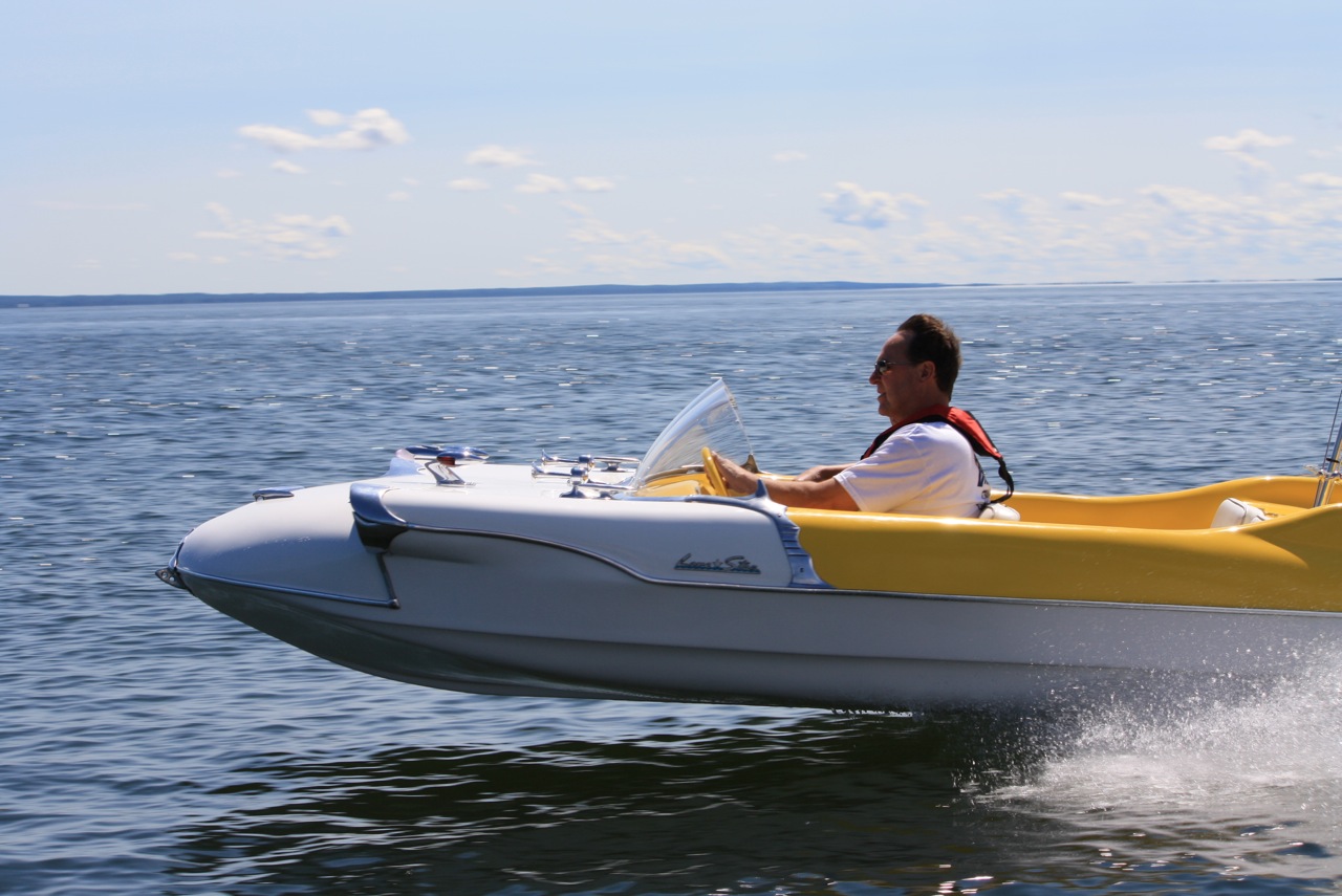

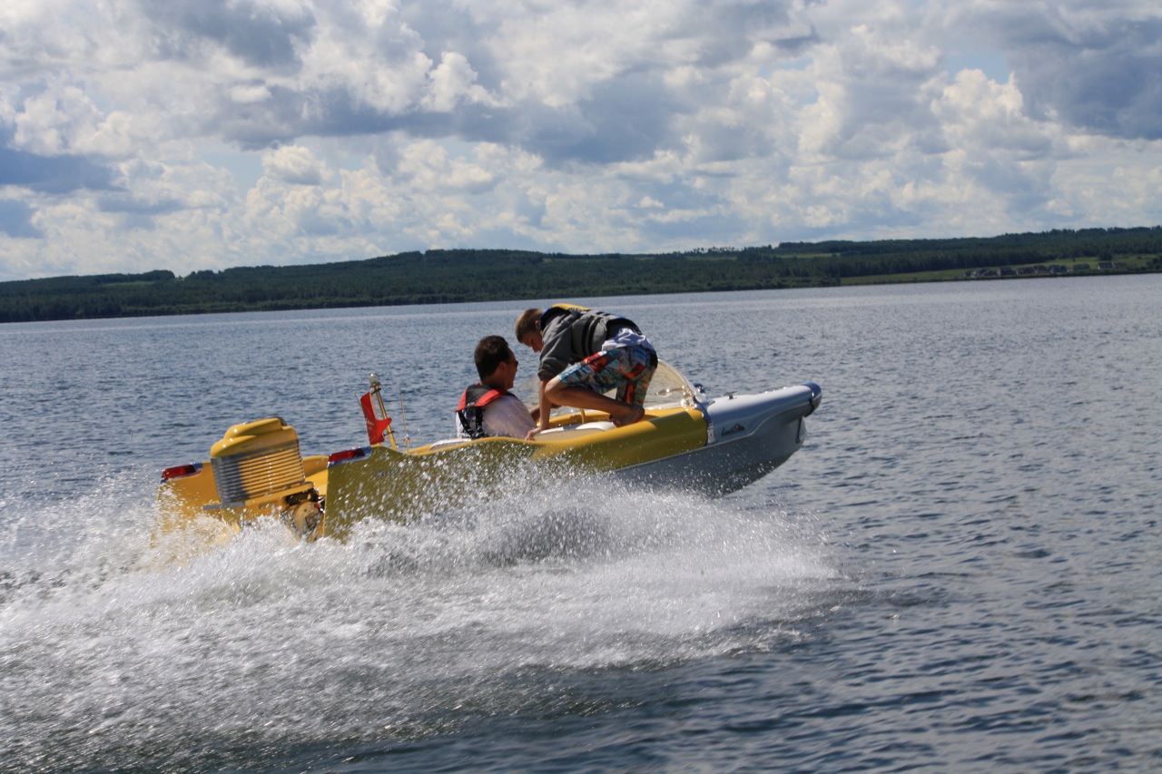

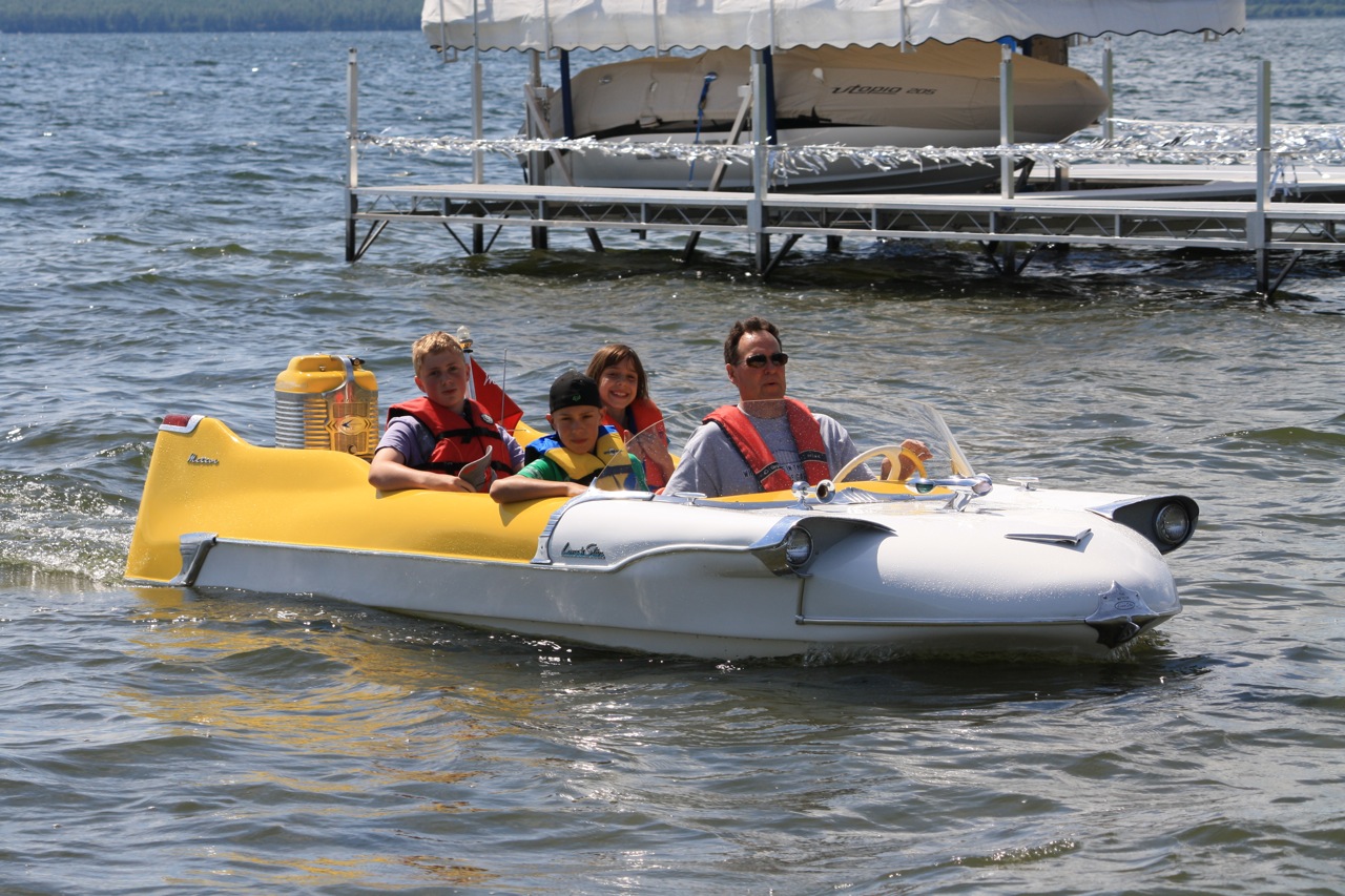

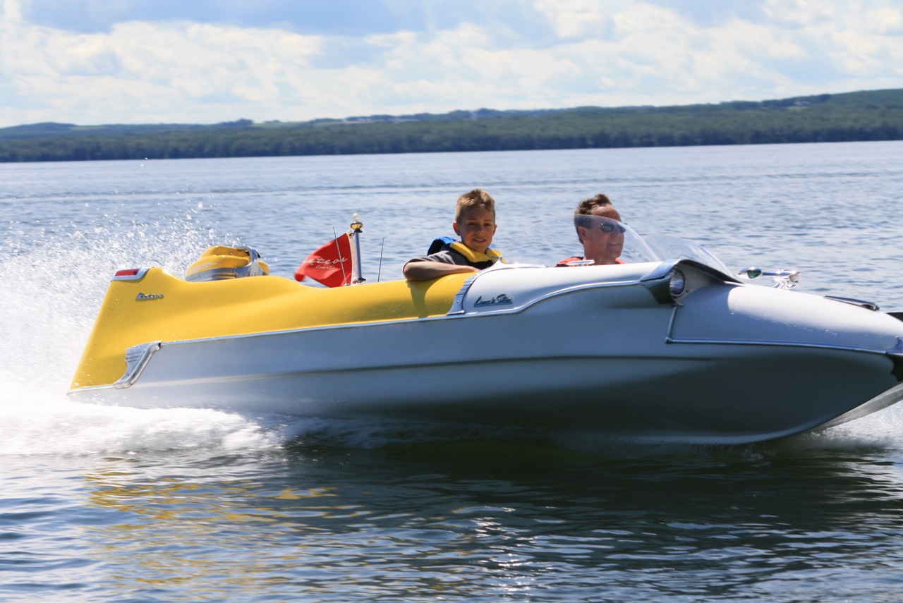

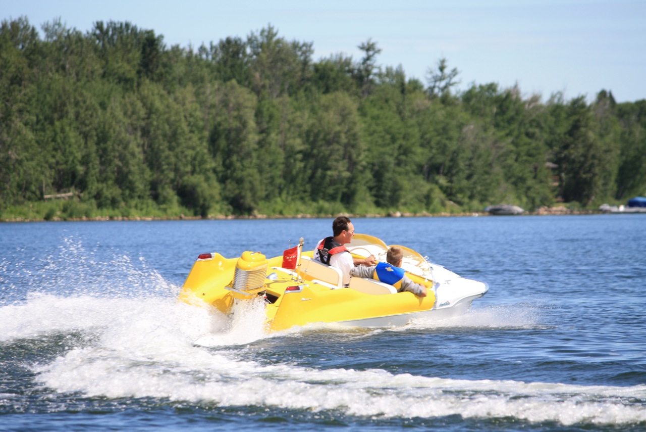

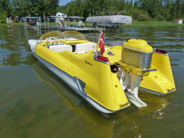

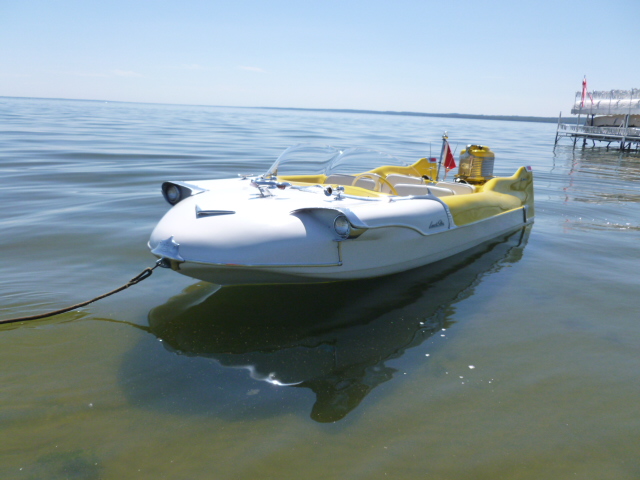

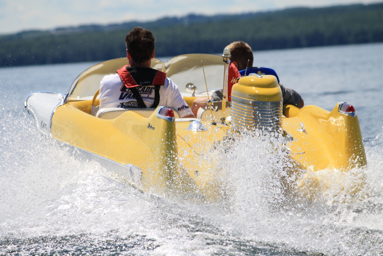

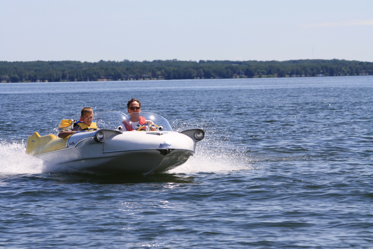

Hello, our 56 Meteor has now spent about 3 months being used on the water . Myself and my family have put about 30 tanks of fuel through it without a glitch. The Meteor used properly in calm reasonable weather is a pleasant boat with great water manors. The 2 rear bilge pumps I installed have yet to see any action as it is next to impossible to get water into the boat even on the fastest stop. The rear pontoons extending past the motor simply lift the boat out of harms way every time. Our lake is about 39 miles around the shore line and the Meteor has been around a number of times with my family of 4 on board. The boat does 29mph by GPS with 2 people on board using a 45HP Mercury Mark 58 with 2 blade 11 pitch prop. We had nothing but fun with this boat meeting lots of people on the lake...Brad Lake

Looking at your boat brings me lots of pleasure. It is such a nice looking boat.
Re:56 Meteor water handling report 12 years 9 months ago #68927
It is nice to finnaly see some pics of a Meteor on the water. It looks great cruising all there. I wish I had a lake that was that hugh. Great pics and a ever greater looking boat. Keep up the good work and have fun. Skip.

Sweet, she looks awesome out there!!!!!!!!!!!!
Re:56 Meteor water handling report 12 years 9 months ago #68963
My goodness you and your son did a fantastic job. Any one ski off of it yet?

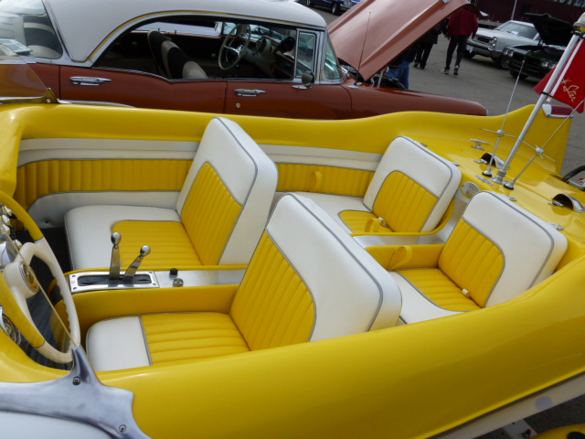

Hello Simplepower, thanks for your comments. I believe the antennas were simply straight replacement antennas of the time with no springs. As for radio if you plan on using the boat you may want to consider an aftermarket "old car " style radio. The one I used has the old look, 57 Chev knobs and sounds great, I have a bunch of 50's music recorded on a USB stick that plugs into a hidden spot in the back of it. We also listen to FM allot on the lake. The original Motorola only poorly plays AM, your call. You may also want to look at the seat placement, the front seats were too far forward originally , I moved mine back 8" still giving good rear leg room and making the front comfortable. I also moved the steering wheel up about 1" as every inch counts for comfort in a Meteor. Our boat is very comfortable set up this way...Brad
