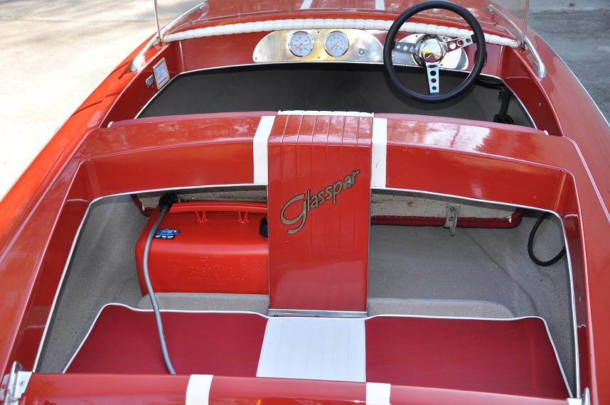

Also, here is a picture of our G-3 with the Silver Gray Color right after it was done.

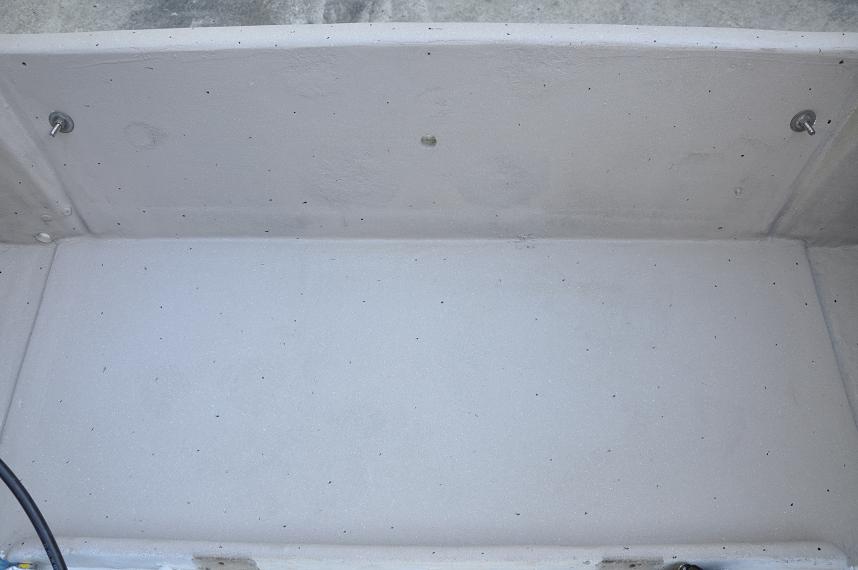

This is a photo of the area under the splashwell on our 1960 Glasspar Sefair Sedan that we are refurbishing right now. This color from "Zolatone" is the MEDUSA GRAY. It has more black "specks"
than the silver gray and has a slight brown tint.
Hope these photos help you Sir! ;)
