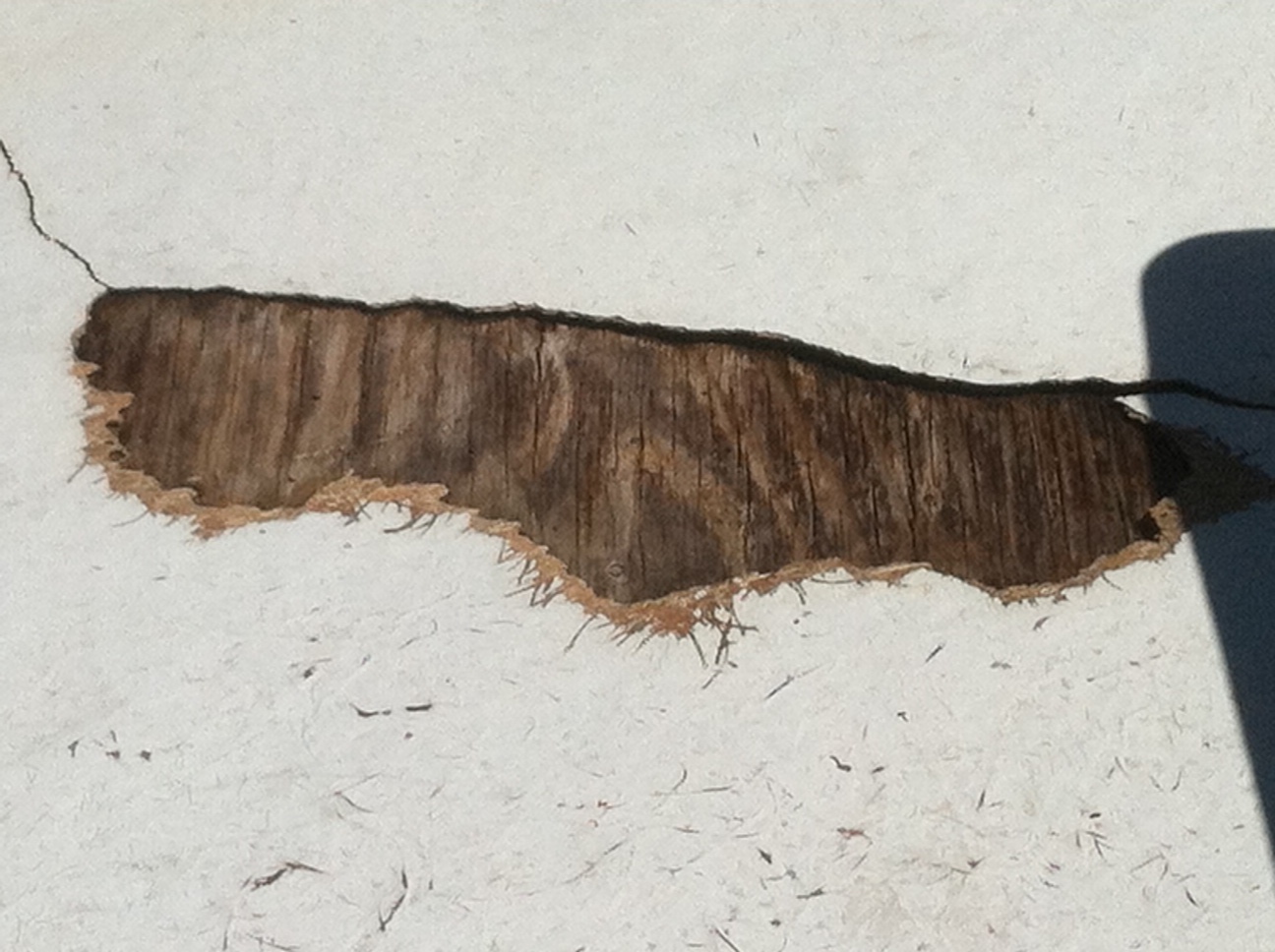

I am looking at a similar problem. Does this look like an original floor, or a repair? I was just going to patch it, but worry that I may be trapping moisture under the patch. I don't see any drains or access under the floor.

IF i was doing that job, i would cut some holes in the floor & put grates over the holes so that NO water could get trapped under there AND gasoling vapor (which PUDDLES like water) couldn't gtet rapped either.
(most marine catalogues have grates in various sizes/materials & they are NOT expensive.)

Daniel, I would replace the whole thing. You have no idea the true extent of the damage just by that one area.
Satx, the only problem I see with the grate idea is that it would also potentially allow more water and gasoline fumes under the floor as well as make it easier (at least for the water) to remove them. Getting fumes from under a floor would likely require some kind of blower.
There was also some mention about filling the space with foam and seal it up. I am very reluctant to go that route as foam can get soaked if there is any leak.
