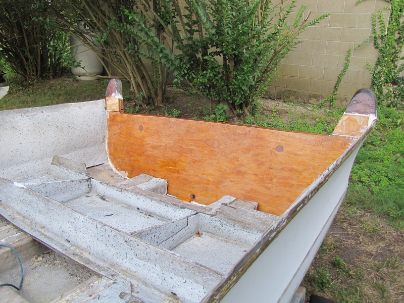

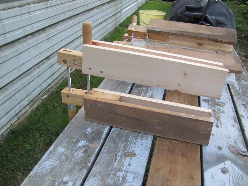

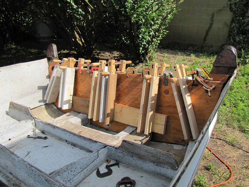

Finally after enough kibitzing, I epoxied the new transom on the Glastron. Other than mixing WAY too much epoxy, it went well. The long clamps are 8" Harbor Freight woodworking clamps (on sale for $5.99) with 1x4 or 1x6 extensions mounted vertically and screwed on either side. In addition, the drain hole had been drilled and a bolt with fender washers screwed through that. I'll leave it overnight and see how it looks in the morning

Looks ok from here. I like your clamp idea. I will have to give it a try on the next transom I do. At least you didnt mix not enough epoxy. I allways end up with too much left over it seems also. Keep up the great work and keep us posted. Skip.

I've GOT AN 88' Searay V-Hull 19' THAT HAS A BAD transom, I've got one of those difficult to get too where I've got two foamed in fiberglass boxes that makes it impossible to get to without pulling the hull. I'm a new boat owner and am very new at this so I'm looking for all the help I can get.
I see from your pic that you have the entire back and all pulled off, is this correct?

Randy, I had to remove the deck to get at the transom. That was the only way. Considering that yours is an 88, can you take the cap off the transom and access it that way? Maybe your best option is to use a pourable epoxy system for the repair. Taking the deck off is a pain in the butt and may be more difficult on a newer boat. There are pics of various stages of my project under 59 Glastron Seaflite in Member Projects.

I made a set of these clamps for installing transoms. Pic shows all thread. I have since swithced to bolts as indicated by drawings and explanations below Clamps are 5ft long.
Here's how I made em in case anyone's interested...

Nice job on those clamps. Here's a photo of mine. Much more crude, but seemed to do the job.
And one of the transom with the fin pieces installed and the gaps partially filled.
