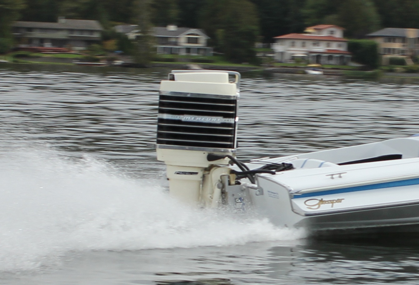

Re:salt water ? 12 years 9 months ago #68086
  • Robby321
  • Robby321's Avatar
  • Posts: 902
  • Karma: 42
  • Thank you received: 10
vuyosevich, looking your pic, I bet that Merc has a steel driveshaft. I don't think I need to add anymore on that. Keep it on the trailer.
