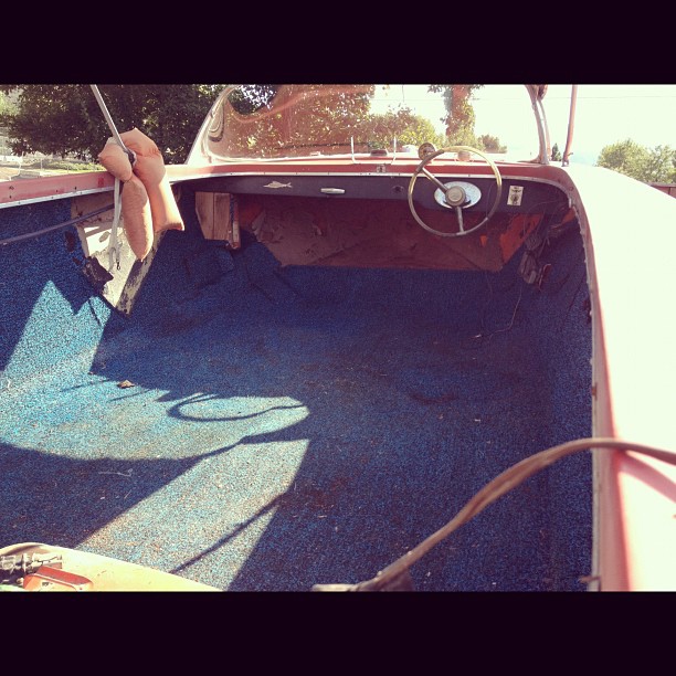

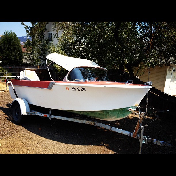

New guy to the forum, really excited that I acquired this boat for free, but no idea where to jump first to begin restoring it. I'm pretty handy but just don't know how best to use my time. The guy I got it from said the 75 hp Evinrude turned over but just coughed and sputtered a little, he hadn't got any farther than that. I looked up the serial number and the engine is dated 1960.
What's the best plan of attack? The boat floor? (spongy, obviously rotten) engine? Is it worth it?

I think that what you actually have is a 1960 Wizard Bolero 15 - and someone put a Marlin badge on the dash. Just below the ends of the windshield, there is an aluminum casting where the rub rail makes a downward jog. In the center of the casting is round medallion. Is thre a "W" on the medallion?
Bruce

Ajarvi, welcome aboard. Nice to see someone who is also interested in restoring classic boats. The real question is, is it worth it to you. It's really a nice boat. Where would I start? First remove the engine to a stand and set it aside. Remove the top, if you already haven't, and set the boat on a stand. You will be able to work on the trailer, like cleaning and repainting. If the underside of the boat needs work, that would be a good place to start. If not the upper deck sounds like it needs to be redone. That's not easy. It takes alot of scribe work for that. Once that's done, the rest is cosmetic. Paint, controls, seats, whatever. After that, boat goes on trailer, fix up the outboard, put motor back on boat, pack up the family for a day motor boating and enjoy the fruits of your labor. Don't forget the beer.

I agree with Bruce, you have a Wizard. Can't quite tell the model from your photos. They are great boats
