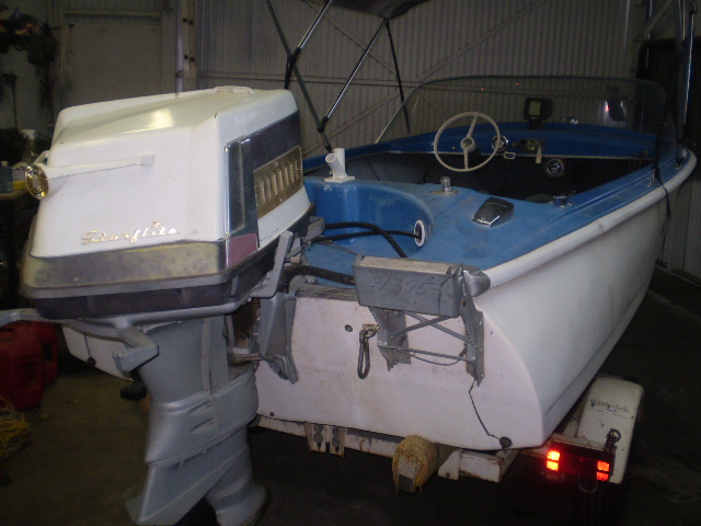

hi as i posted some time ago we bought a very cool little boat i finally got it current on dmv, got are new tags did some more clean up and took it to a small trout lake close to us my thought was if it stops running the lake was small and i could row to the dock LOL ,,, well it did great so i thought ,we had fun and got some looks it was a short float but very cool ,so now here is were we are at we went out again yesterday for a longer float and just kinda trolled around up and down the lake as we got lower on fuel we noticed that she started to make more smoke and when we started to head in to the dock it kinda got what i think is bad to the point it was rolling out from the out board cover some i did feel the cover and case to see if it was really hot or over heating and it seemed ok and not burning ,so i,m asking if get to the bottom of your gas can will give that more oil burning smoke or should i look into to it more also should this motor have a pee hole for water so u can see if its pumping throw the motor to cool it as we have not seen that and some else said this motor pumps it throw the muffler port ? not sure about that ,and last when we pulled it out of the water i did see in the lower port next to the prop it seemed kinda milk shaky , kinda like on a car motor oil cap when u have a head gasket prop ,, any advice would be great as i know nota about this motor and have not had much luck online thanxs again dave and crystal ,,,,,, also we maybe looking to sell the motor as we would like i think a newer one that we can feel safe in just a thought ,,,,,
the motor is a Evinrude 50hp starflite ,and yes it still starts and runs it did not stop running or make a funny noises ,just not sure if its pumping water and should have made as much smoke as it did ?????????

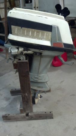

update i had some time to work on the motor so i get brave and pulled the lower unit off the motor to get to the water pump it was very easy to do it came apart with trouble the shifter rod was fun to get to, had to remove both plates but no hiding bolts so with that said the impeller was in great shape very usable the housing had some scale build up so i lightly sanded is and added some grease to the side walls and put it all back in and started it on a hose and for the first time i can say i see water pumping throw the motor , it now's comes out of the lower port and the upper port also it now streams out 2 small holes on the lower unit side so back to the lake this weekend i will post some info and pics as to how it goes , hoping to get it out and over 10mph as the lake we first got on had a limit ,,,,, thanxs again for the help and posts here are some pics of the motor i had trouble with,
this is the port i now get some water from when its running is this how it should be???????please let me know
and the fun little covers for the shift rod

Yeah, that's where the water should come out!
Those fat 50's are good motors- Thirsty, yes- Terrible polluters, too. But, they RUN.
You can download the service manual, free, from my website-
agott.com/glassboat/manuals.html
